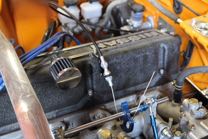

74zzz Posted August 4, 2015 Author Posted August 4, 2015 can others post some pics of what they have done? this is a cable but dosent have throttle crank/pivot etc........ at the moment mine comes straight out of the firewall to two makeshift mounts on top of the rocker cover which then pulls on a lever attached to the hex throttle rod with a return spring attached to the fuel t section/tube......just looks wrong......im thinking pits have been bined by previous owner Quote
Retro Z Posted August 4, 2015 Posted August 4, 2015 This is from Mark (Mossy) build thread. Its a Lokar cable Quote
Retro Z Posted August 4, 2015 Posted August 4, 2015 Here you go mate. Grab a Lokar throttle cable and buy one of these cable wheels and spring and make a bracket. http://racehead.com.au/products-page/linkage-parts/ Quote
