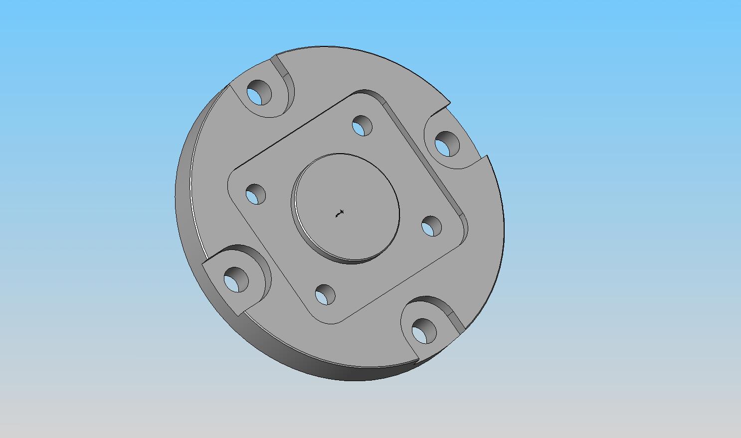

I've got a Z31 R200 diff in my ZX, using the CV's.
I made up an adaptor, see pic, to bolt between hub and half shaft.
I also had to modify the flange on the nose of the diff to fit to tail shaft. (Simple bore for location and drilling of bolt holes)

That's pretty straight forward.. might just do that then. I was under the impression the z31 cv shafts had a shaft on either end I didn't realize the hub end was just a plate like on the 280's. That makes it heaps easier!
