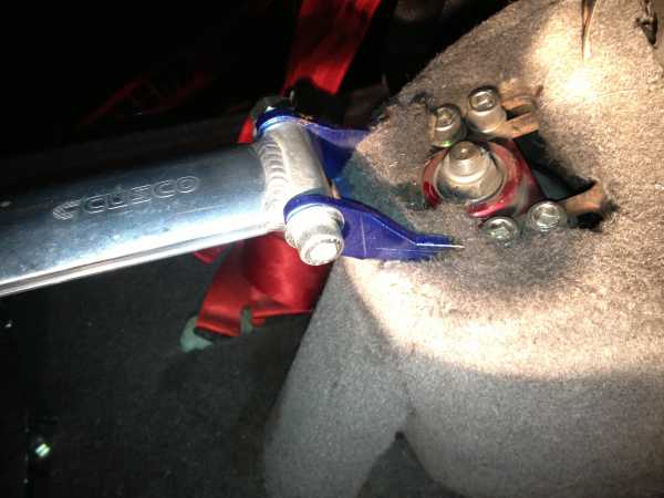

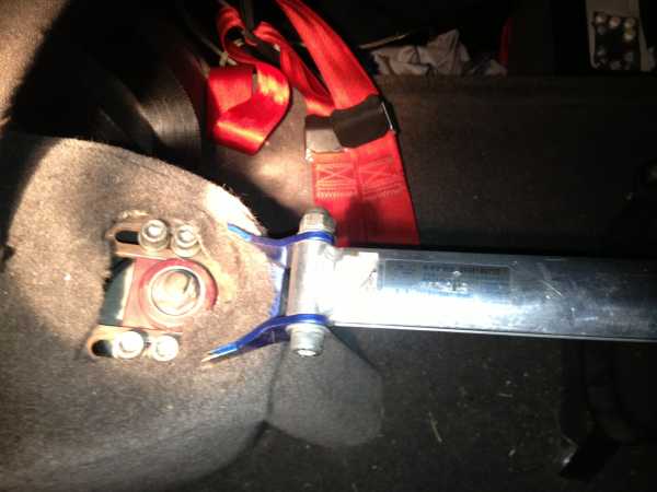

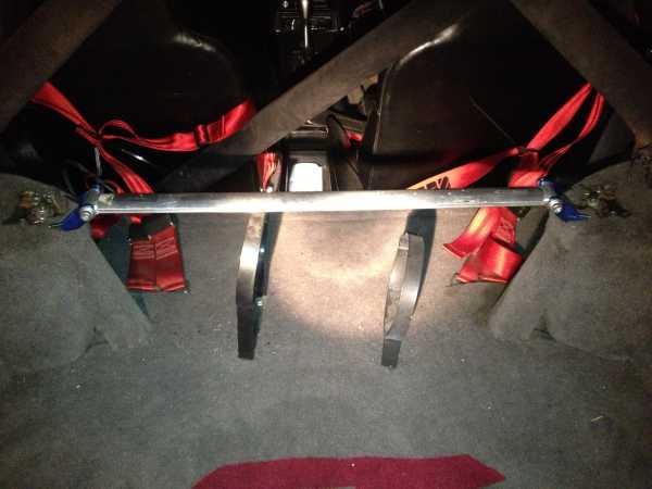

Has anyone made up or purchased a cross-brace for the rear shock towers on a 240Z fitted with Arizona Z Car shocks? If so, could you provide a photo of the brace and fitting. Thanks
I have peter used a cusco strut brace and cut the ears off the std cusco mount and welded them to the rear strut towers will post a pic tomorrow
