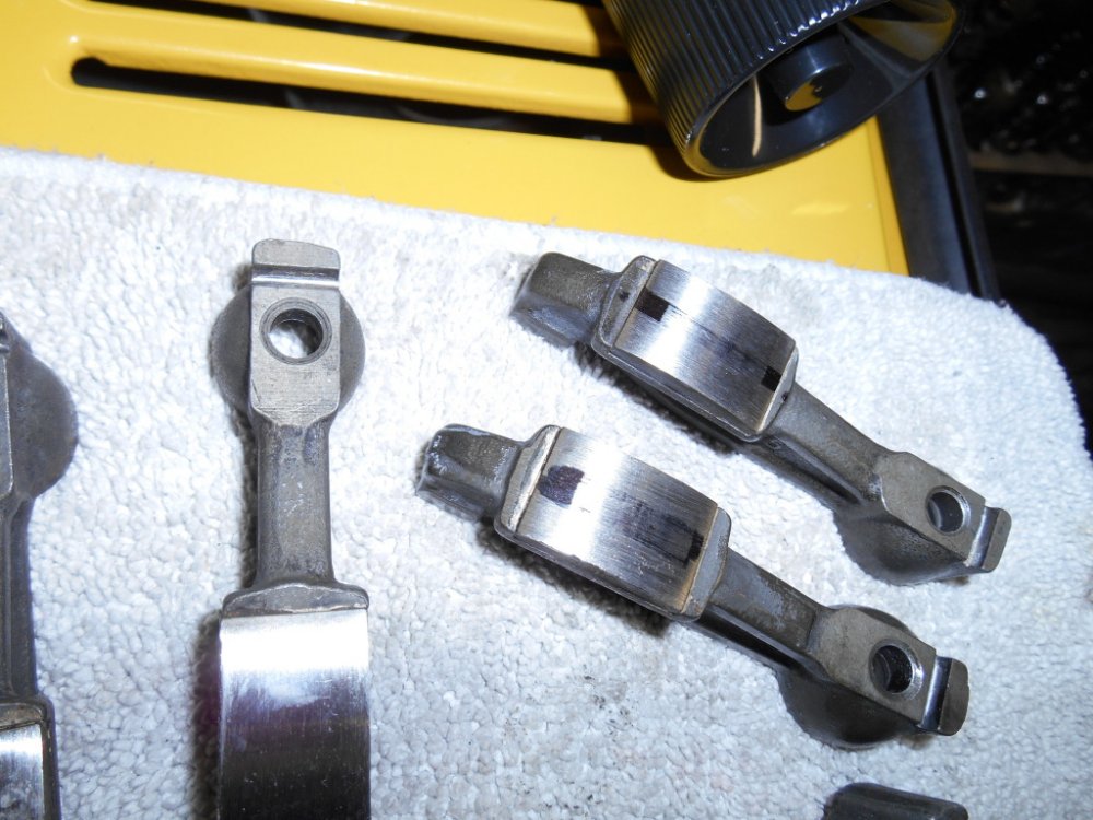

picked up a reground cam local, got it all in and just checking wipe pattern.
not running off the pad, but its definitely not centered.
worth while measuring up lash pad replacements or is this considered useable ?
black marker lines taken from 1 intake and 1 exhaust on first pot with stock lash adjustment

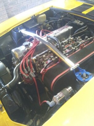

finally got the carbs running nice  after dropping the main venturi size from 36 to 34, huge drive-ability difference for around town.

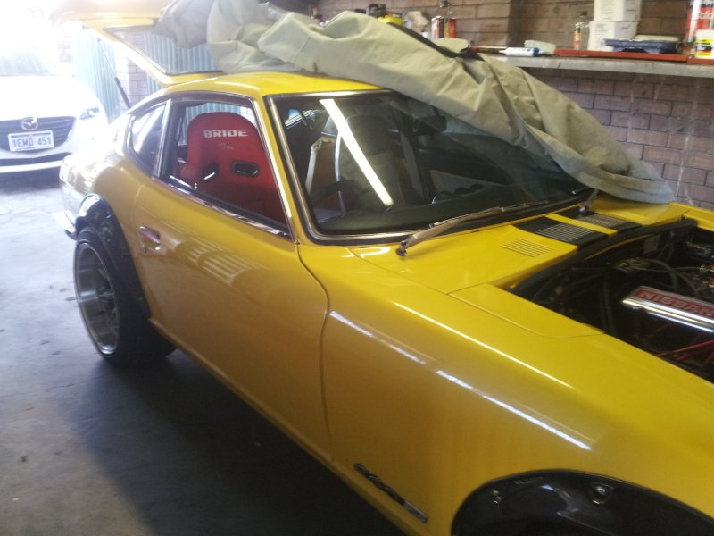

picked up a genuine bride bucket seat, just fits but its not sitting much lower.
will have to get another set of rails to make a lower bracket, kinda just knocked the bracket up quickly to see where its at.
also grabbed a set of cusco strut bars, fits well but not with my manifold.
the bar sits too low and presses the carb linkage down on number two, may try ordering some shorter linkage arms and see if they'll clear.
