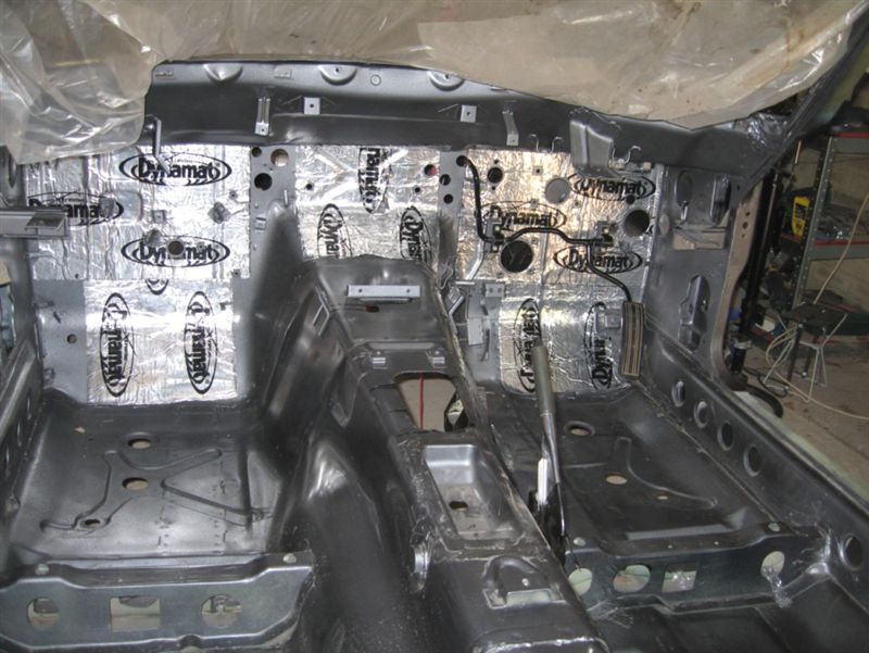

I have used various deadeners in various cars (with various sucess).
These include Bostik Mat, Flashtac, R&H paint on bitumen and Dynamat.
In my Z, I have used dynamat as it is a "spare no expense" project for me. It is of course easy to use, looks the same as flashtac, brownbread of stinger roadkill which are just as easy to use.
If you buy individual sheets then Dynamat is very expensive, but if you buy the bulk pack online, then it isnt that much different to the other brands. I cant remember what I paid, but it was less than $200 and was enough to do my firewall, tunnel and hatch floor.
I just decided to spend that bit extra this time, as usually (but not always) such a reputation is earned for a reason. Online documentation is quite good too.
