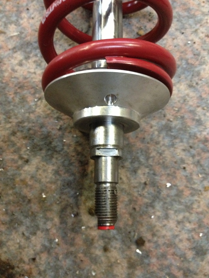

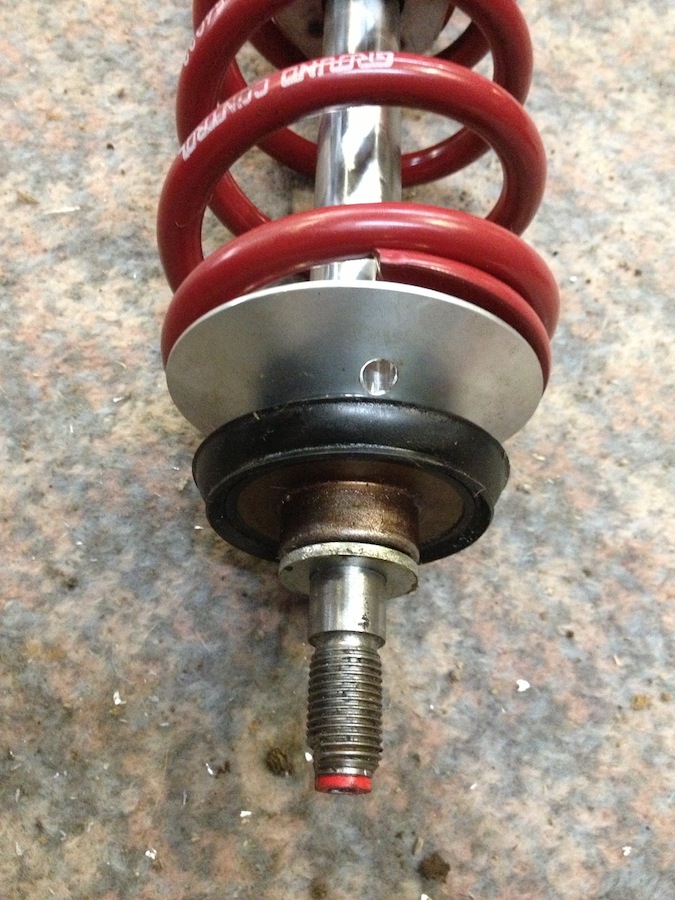

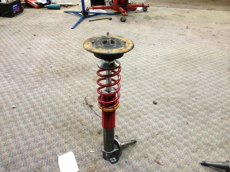

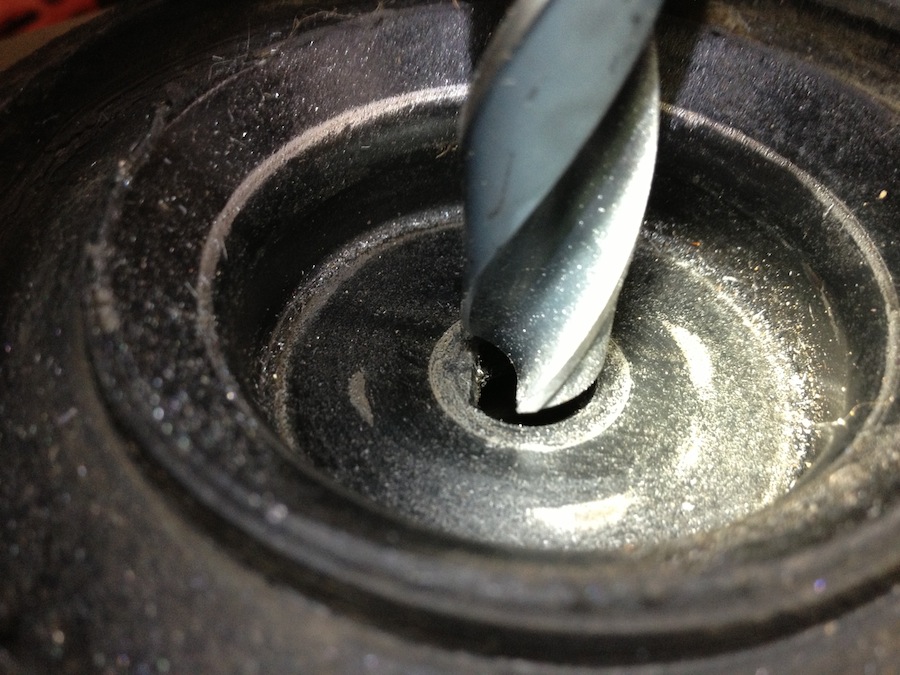

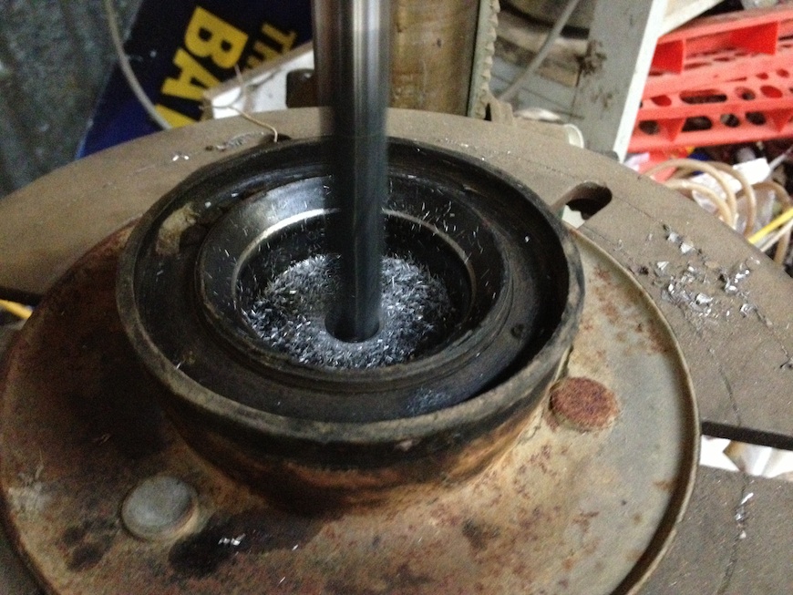

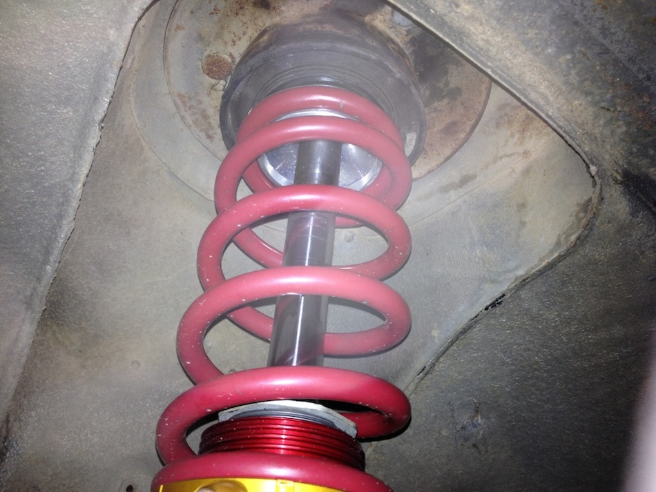

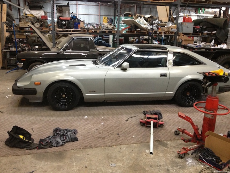

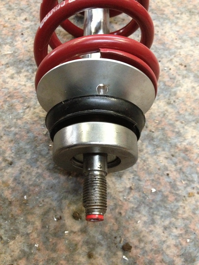

Brodie900 Posted February 27, 2013 Posted February 27, 2013 Ok, so I spent two days in the work shop fitting my new coil overs this week and the results so far are fantastic! these are the ready made "bolt on" coilovers from techno toy tuning with 250lb spring rate and adjustable tokico shocks. The car feels fantastic on the road, handles well and doesnt feel harsh at all on bumpy country roads. I also re drilled the rear strut towers and fitted some second hand cusco coil overs from an s13. the only modification required to fit the suspension was the tops of the old front strut tower required drilling out with a 15mm bit so the new shocks could be bolted through. Then with some parts off the old strut tower including the bearing and some well placed washers that were supplied, the complete unit could be bolted together on the car. Quote
Brodie900 Posted February 27, 2013 Author Posted February 27, 2013 some more pics showing the drilling and end result Quote

dattocam Posted March 25, 2013 Posted March 25, 2013 Nice just a quick question, What height are they set up for? Delivered. Did you have to specify desired ride height, or take base measurement for them? Thanks Cam Quote
Brodie900 Posted February 16, 2014 Author Posted February 16, 2014 dattocam i actually didn't really think about the height at all, i think they came wound all the way up and i just put them in and wound them all the way down haha! Quote
