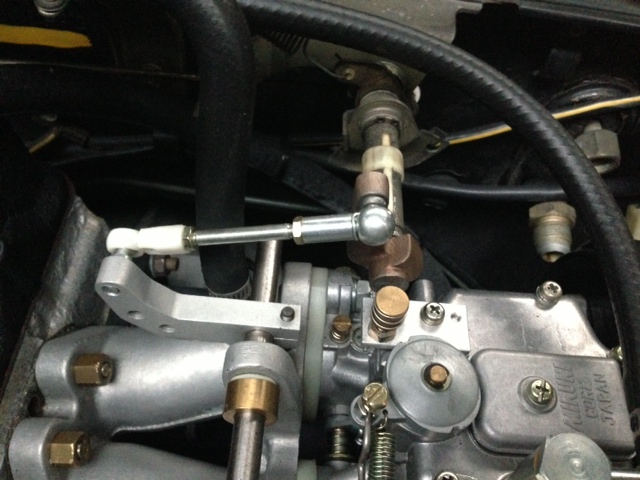

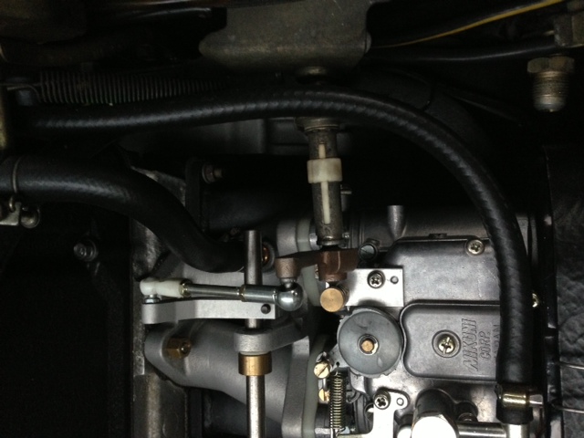

CH105 Posted February 25, 2013 Posted February 25, 2013 Hi guys, I've installed a short mikuni manifold and now need to modify the linkage so that it meets the OEM rod from the firewall. I've got a idea how to go about this but if you're running the same manifold please could you post a picture to show how you've done it. Thanks Quote
luvemfast Posted February 25, 2013 Posted February 25, 2013 Taken some pics of my setup. Will post up here tomorrow. Quote
luvemfast Posted February 26, 2013 Posted February 26, 2013 Heres a pic of how I've done it in my car, bear in mind that I've got an S130 and a different manifold length. But the principle is the same. Hope that helps Quote
CH105 Posted February 27, 2013 Author Posted February 27, 2013 Great, many thanks! That's exactly what I had in mind. I'll be adapting a linkage in that manner in the next couple of weeks. Cheers Quote
