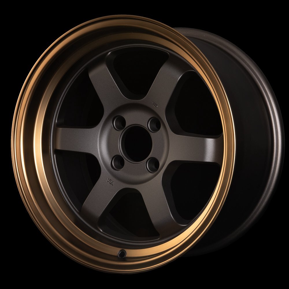

  1. Keen on these black/ bronze Rota grid classics for the 260z. Currently sitting on stockies. Not a fan of those wheels. They come in 114.3 X 4 in 15 and 16 inch with zero offset. Do you guys reckon the 16's would fit with some low profile rubber? Not a fan of rolling the guards. Thoughts guys? Maybe I should just go 15 inch to be sure, aye?

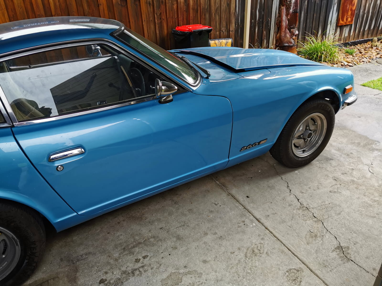

  6. Hi guys. I recently purchased a 1975 260z and had it brought up from Melbourne to sunny, tropical Goulburn. (well, it is for at least a few days). It's largely complete but very tired. The body appears to be in excellent shape, though. L28 engine, auto. Plan is to ditch the auto and keep the rest as it is, maybe add a few go fast bits as we progress, and change the interior trim to black. Motor is tired, blows smoke and brakes are barely working, so had it towed home. Transmission is vague, so hit it with some Lucas transmission stop slip and it seems to have improved it a little. I am a long time fan of the z cars ever since I took one for a test drive when I was around 20 years old. Sadly, it has taken a further 42 year before I can say I now own one. Because it was brought up from Vic, it now has to start afresh with a blue slip. I think I am going to be in for a ride.
