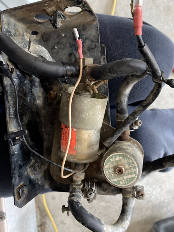

The carbs we got were taken off a 260z, and I believe they replaced the stock flat tops as an upgrade, so I’m not sure what year the carbs originally came off. They seem to be 3 screw Datsun (ie. non British) round tops with no tab on the inlet flange, I have attached photos for reference. Hopefully less effort to get running? They were taken off a running car and left in a box since then. Also are we missing the float chambers?
The flat tops did not seem to be working properly, although with our limited experience we can’t really say if it’s the fuel pump or carbs that are the issue. When fed from a funnel, fuel passed through the pump even before cranking, although once cranking it sped up a lot, in pulses. Is this expected? Fuel was also flowing through the return line at pretty much all times.
If there’s some easy things to check or fix regarding fuel pump, regulator, etc, we’ll try them with the flat tops first, or otherwise, if the carbs seem to be the issue, we’ll order a service kit for the round tops and get to work on them.
