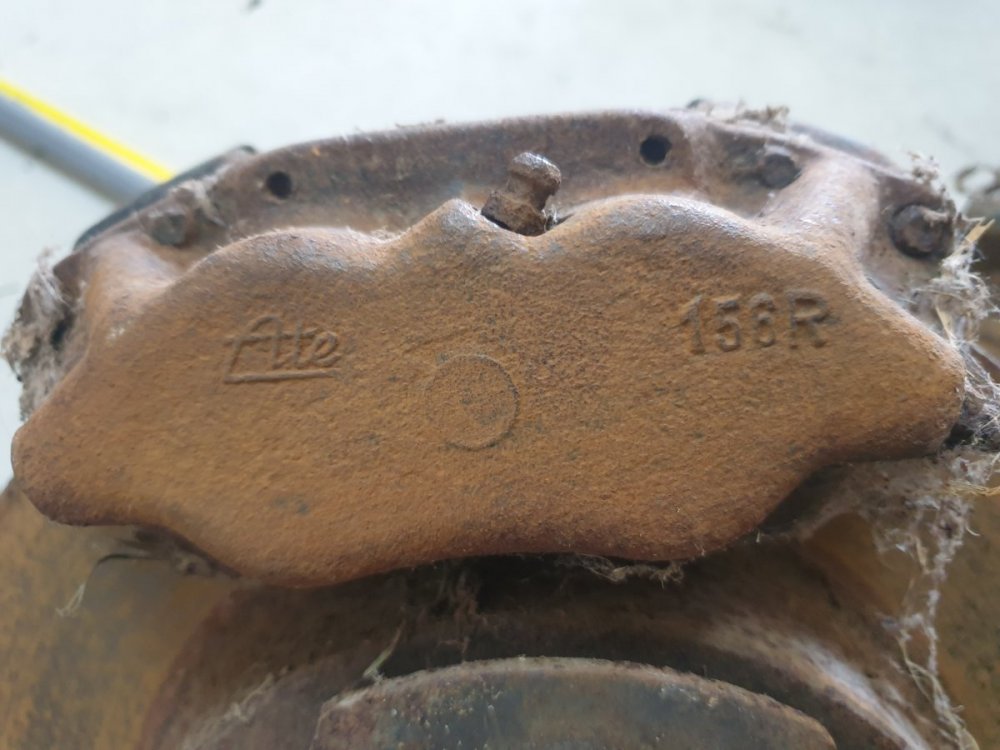

  6. Hmm, now I have found the manufacture of the calipers I may sand blast them and rebuild them, as I think the will be substantial for the rb25det. I will also be upgrading the rear drums to disks. I'm not sure what master cylinder it was running, as it is gone along with the break booster. So they will be new items latter on. I have a lot of work ahead that's for sure. On another topic I started cutting the floor out today, and nearly have the new pan ready to go in.

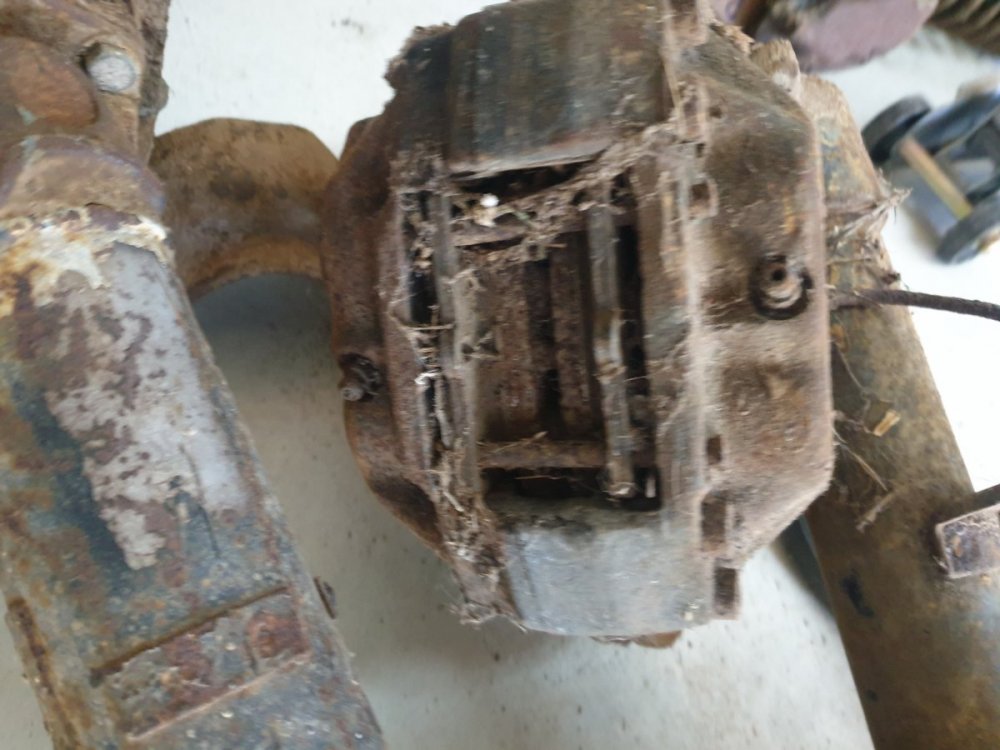

  7. More photos. I found the manufacture of the calipers they are ATE, but have never herd of this brand.
  8. Hi guys I have recently gutted the 260z and whist pulling the front suspension off I noticed the front breaks have been upgraded, as the disks are vented for starters and measure approx. 280 dia. The front calipers although they are rusty are 4 piston calipers. The only markings vissable are 155r and 155l. I have googled the shit out of them with no results . I have checked the most common caliper upgrades and none seem to match. Are any of you familiar with this ? I will upload a better image of the caliper tommorrow as it 1130 pm as I right this post. Also added a picture on the rottisery because why not Tia
