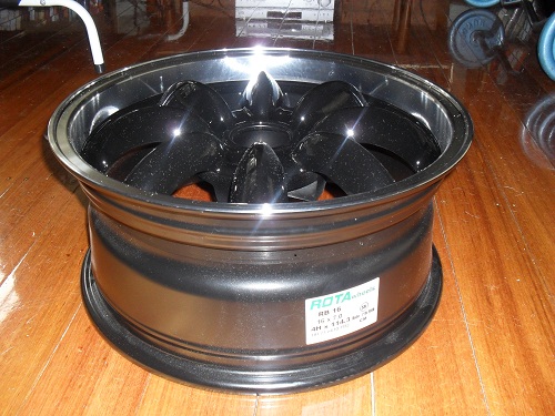

After reading a lot about all of the different wheels I bought a new set of the Rota RB 16 x 7". I got a sweet deal from the US - about $700 USD delivered to my door. Unwrapped them today

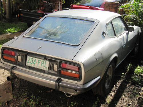

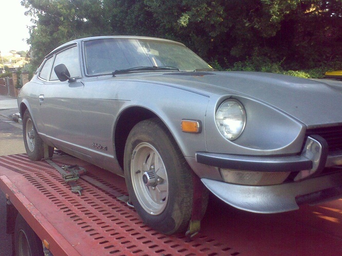

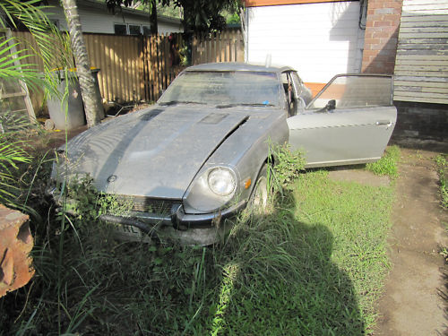

Ok - so as suggested by some, I am starting a build thread for the revival of this beautiful 1977 silver 260z 2+2 that was one of the luckier victims of the recent QLD floods. This is going back to the start, and I will add more soon. Purchased from a very friendly and helpful New Zealander who spent a fair amount of time working on unsticking the handbrake so that the transport could move the car on and off the tray as well as being available to answer my questions on the phone. He owned the car for 10years and kept it very original apart from a quality $2000 custom exhaust system and a now waterlogged pioneer sterero. The dead zed made its way onto the back of the truck and arrived ahead of schedule at my house in Melbourne. The first challenge, was to get the rolling vehicle off the main road and up a steep driveway to my garage and workshop. I tried towing it up (with two drivers) at first with my 1965 Rambler 287 V8, but it struggled with the gradiant. Then I tried to tow it with the HX 308V8 one tonner, but not enough weight over the rear axle meant a lot of wheelspin and not much movement. In the end the Euro Audi allroad was called in and did it with ease. Thus begun the clean up job, washing off the residual gunk from the flood waters and road grime. Photos for part one...attached, assuming they work.

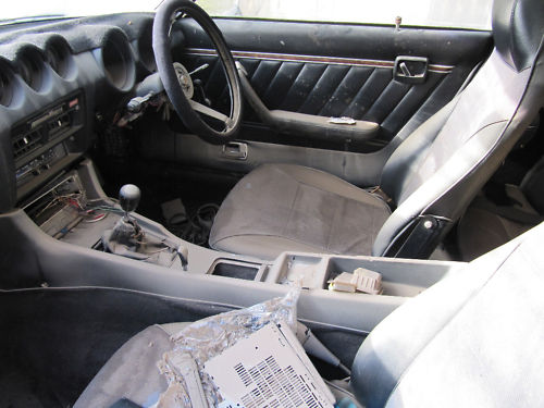

So I have begun the cleanup of my newly acquired 260z 2+2, which is in much better nick than expected. My wiring still seems pretty good and electricals appear to work fro most things. Car is turning over nicely, but there is no spark to the points and I am trying to work out if it is a relay that I am not aware of. I have replaced all of the fuses in the fuse panel as they had been in water. I can hear click, like a relay under the cowl panel where the wiper motor is, behind the firweall when I turn the key to on. I don't seem to have any fuel pump or spark. Does this sound like a hidden kill switch? or is there a relay or other fuse I should know about? Thanks Will post pics soon!
