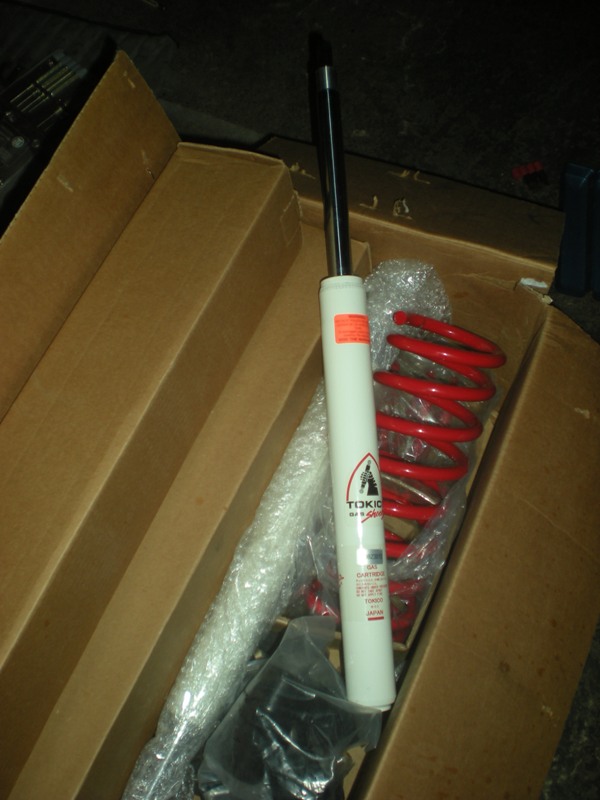

Yeah mate just trying to save someone some postage on a 280 tokico kit, like i said cost me $900 to get it here with the rest of the gear i got from the states company asked me if i could get rid of it so they dont have to pay for there fuck up, don't see how i'm making a quick buck, but anyway If anyone else can find a cheaper price for brand new gear then let me know what it is and Il put it to them. If not il just send it back. Part no. for the shocks are: BZ3012 Front, BZ3013 rear Thanks -
280Z Tokico Illumina Strut and Spring Kit
custommade replied to custommade's topic in Parts and Tools for Sale
Hey Tim, for a 280z, they will fit a 240 but the spacer needs to be cut for the rear shocks, the gland nuts are to large for the 240 strut housing and the springs will give you a standard ride height if installed in a 240. Not a big deal to make the kit fit a 240 but not what I ordered, so they are sending me the correct kit -
Brand New Still in box. Sent the wrong one I have a 240 so no good to me. Kit contains: 280Z KIT 4x Tokico Springs 4x Tokico Illumina Adjustable Struts 4x New Gland Nuts Part no. for the shocks are: BZ3012 Front, BZ3013 rear Springs: 5022f 5022r 185lbs front 200lbs rear I think $750 got them last week cost me $900 PM if your interested. Luke

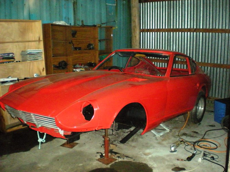

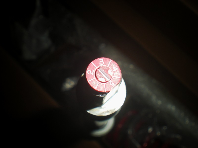

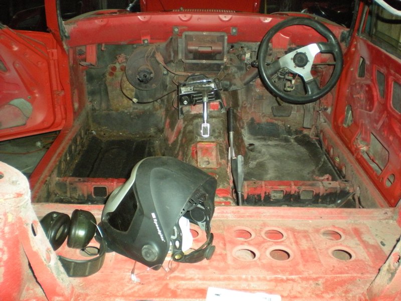

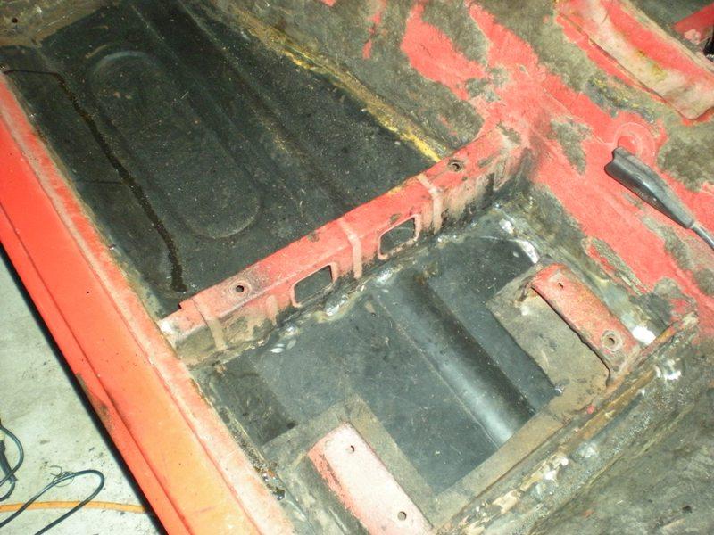

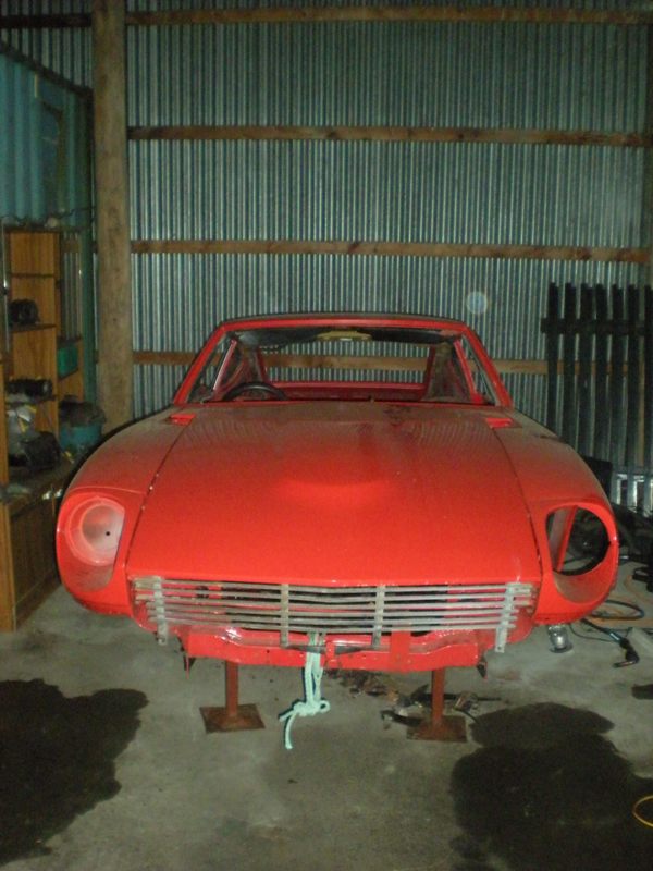

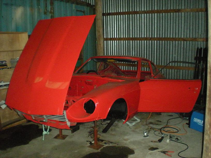

Hey Guys, Thought it about time I introduced myself. Ive been lurking on here for a couple of years now, had my 240 zed for about eight. Bought it when I was about 20 and in the exuberance of youth striped it bare and had it resprayed. There it sat for eight years. Other cars, bikes, women, work, always got in the way. But over the last couple of months Iv finally been doing a bit here and there. New floor pans. Rubber kit from Vintage rubber(F@#$ing expensive) Carb kits from Z therapy. and Tokico illumina strut/spring kit. Energy suspension bush kit. Got the Tokico kit from shox.com, when it arrived looked at the part numbers and its all for a 280z. Not what I ordered!!!! So sent them a pissed off email the kind were after you send it yo think I probably shouldn't have said that but this was the second time I had a problem dealing with them in as many days and about my 6th communication with them. They say they have ordered the wright kit from tokico and will send it asap....so time will tell. Looking at the quality of the struts I they are no Koni's The adjuster on the strut top is plastic and feels very flimsy would like to have seen it made from steel. But for the price I don't see anything else around. If you have the extra cash go Koni yellows. Any how heres some pics
