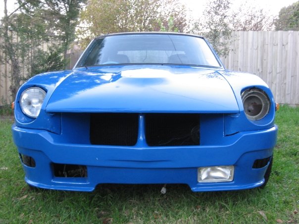

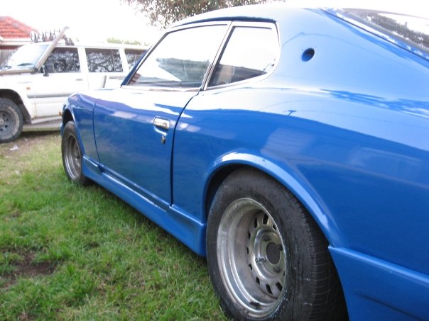

  4. I'd just like to distance myself from these photos. These are taken by the previous owner, I claim no liability for its content . Apparently they belong to his girlfriend. In all seriousness I am trying to sell this body kit. I'm not too sure how much it's worth so make an offer and you might be in with a chance.
  5. Hi guys This fibreglass body kit is one of a kind, built for a 260z 2+2. Includes Front, rear bumpers and side skirts. It's in Excellent condition, with only a minor crack in the rear bumper. I'm ultimately looking to swap this for both front and rear bumper (including mounts and indicator panels). Negotiable on price depending on the condition of the bumpers. Also comes with 2 fog lights and a small can of touch up paint. Price is negotiable, over $800. I'm located in Melbourne. Best to contact me via PM or email as I'm currently on night shift.
