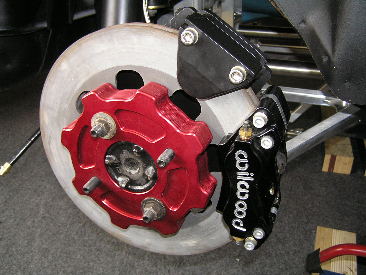

Rear AZC Coilovers, Billet Suspension Arms, Billet Moustache Bar, Billet Brace Kit, Wilwood 4 Pot Calipers Fitted. Also shows my newly designed Handrake Setup, which uses a Wilwood Mechanical Spot Caliper.

LOL i just had a read, alot of the questions are by kids i reckon. Woza did you buy the corner packages? Or did you buy the race kits and modified your own strut to accomodate? I wanted to know if thats a 240z or a 260z struts that were used.
Share this comment
Link to comment
Yep, I bought the kits and did it all myself. Its a lot cheaper that way. I assume that if you did Buy the whole assembly, you would be given the option of 240Z or 260Z Struts. I guess you'd need to confirm that before ordering though. Personally, I see no point in paying all that extra just for cutting a strut tube and welding a sleeve on ! haha :shock:

Woza may be good to start a new thread in the brake section so other people can join in with their 2cents worth. Do you have any pics with the hand brake cable in position, then we can all get our engineering hats on and see if it's going to work ok.
Share this comment
Link to comment
Good Idea Charlie Boy - I have posted a thread in the Brake Forums ! At this stage no.....I dont have any pics yet of the cable in position. I still need to get the additional cable mounts laser cut, bent & welded. Ive got most of the hardware that Im going to use for the cable, but need the mounts done before I can proceed.
