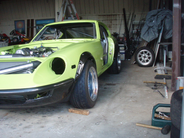

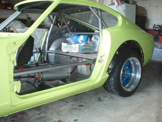

See attached photo of 240z with flares - extra wheel width is a matter of personal preference, but if you run the car mainly on the street be carefull as the car will "tramline" with wider wheels.
My car is track only & the bigger "blue" jongbloed wheels are 16x10 rears & 16x9 fronts with 0 offset. I will attached other photos of other wheels (in separate post) performance 15x8 -4 offset.

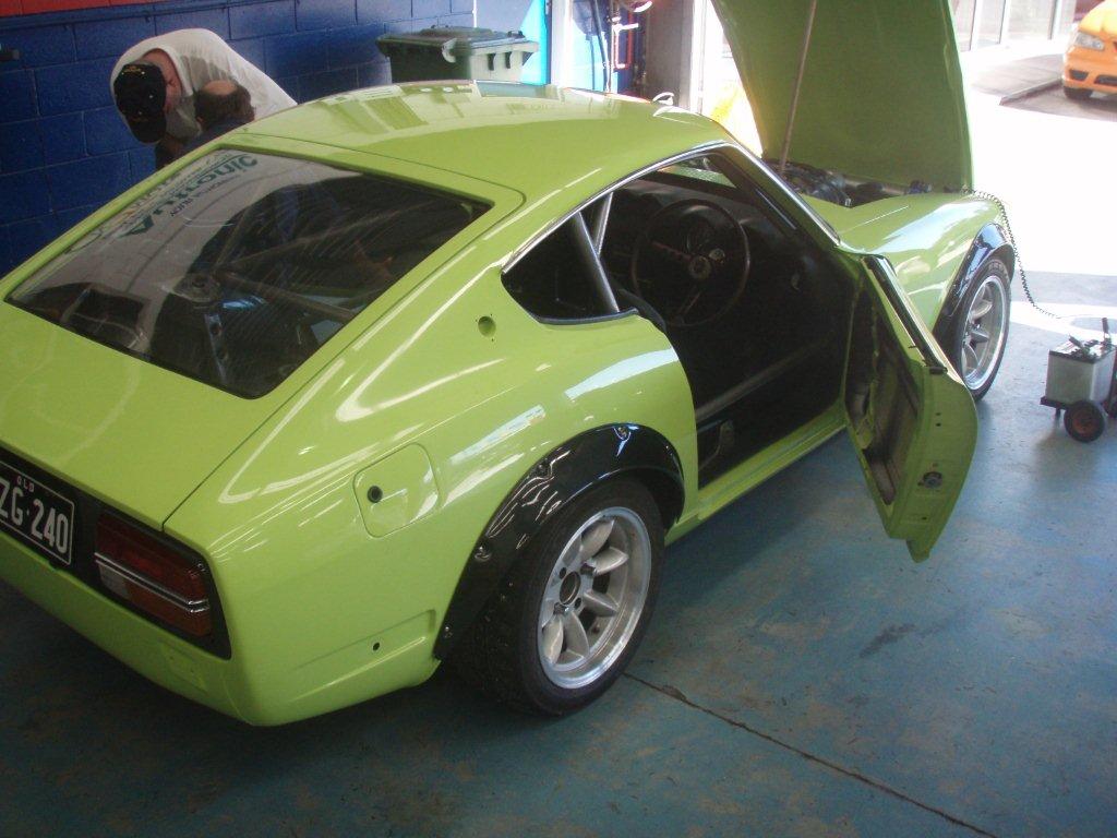

Second post with performance 15x8 wheels -4 offset
Hi
I should note the green 240z is running adjustable height coilovers with the smaller diameter king springs. Standard struts/springs do create clearance issues for bigger wheels etc. :)
