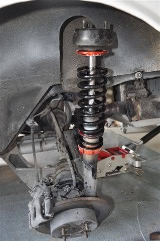

240Z Rear Coilovers

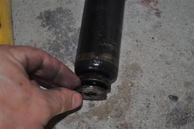

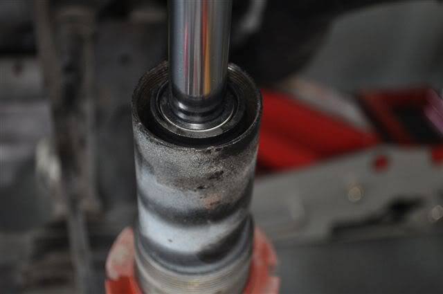

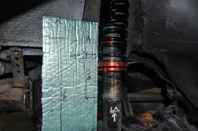

Factory strut tube height (I think??) 390mm

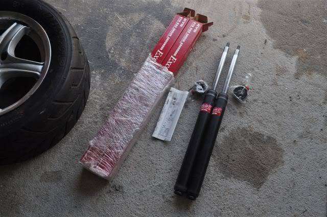

KYB Excel G gas struts # 365012 (requires one washer as spacer in bottom of tube)

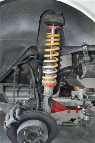

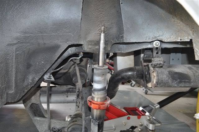

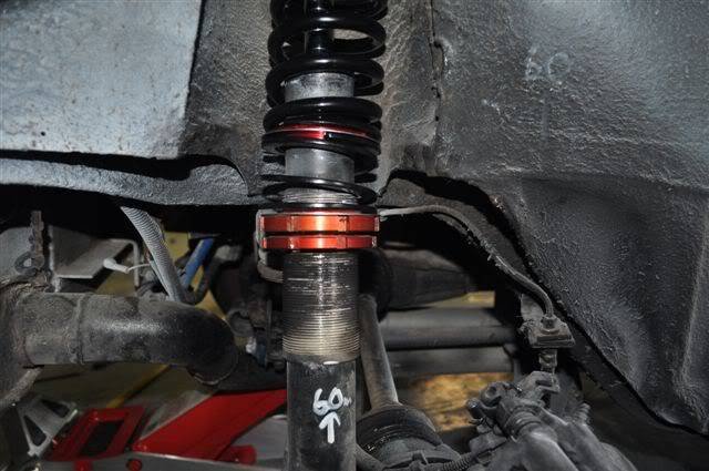

Coil over sleeve welded on at approx 90mm from top of strut tube.
Sleeve length is 120mm.

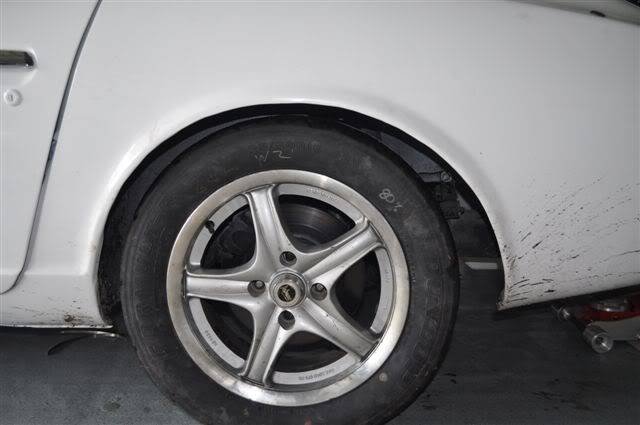

With 6kg Otomoto springs and the spring perch sitting approx 10mm from top of sleeve, there is approx a one inch gap between the guard and the 16” tyre. Approx 80mm further lowering available.
With 4.5kg King springs and the spring perch approx 50mm from top of sleeve, there is approx a one inch gap between the guard and the 16” tyre (as above). Approx 50mm further lowering available.
