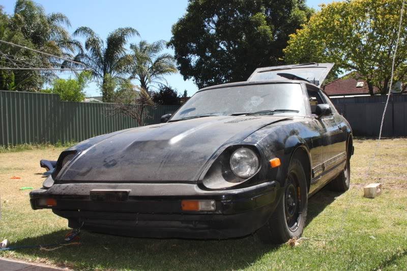

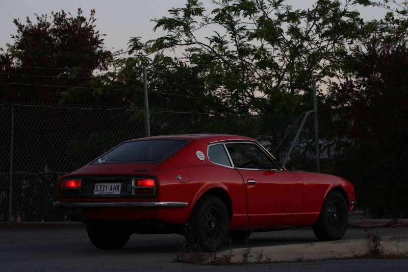

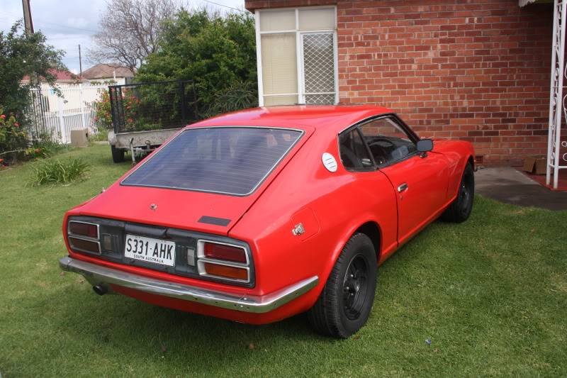

Well this is my Zed. Its a 260z 2+2 that someone got creative with before me.
I picked this up off a friend of mine after they moved interstate.
This was the condition it was in....covered in dust

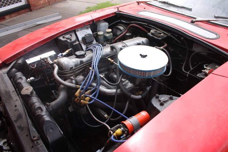

Pretty much fell in love with it. So i grabbed it and took it home. After we got it off the trailer I left it to idle in my driveway and all of sudden fuel was gushing out of the exhaust. So I turned it off and go to cleaning it.

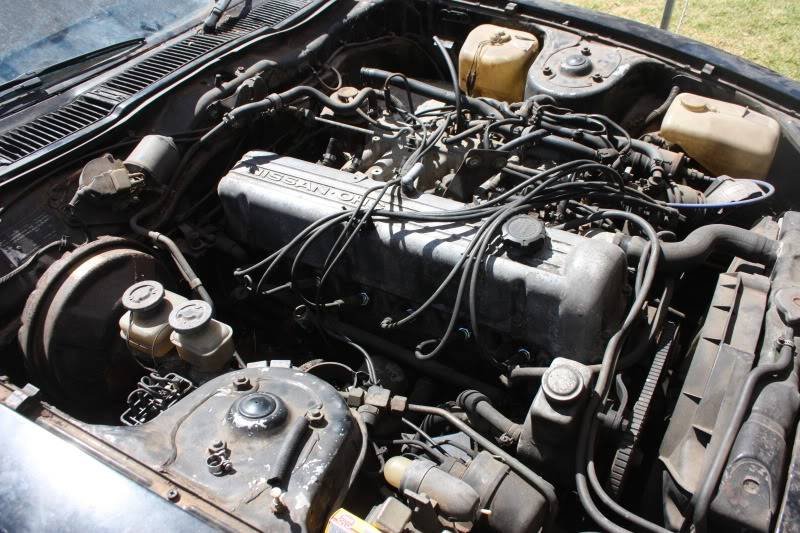

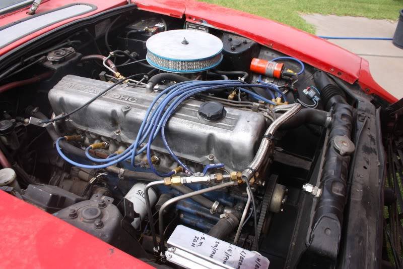

The motor....an L24

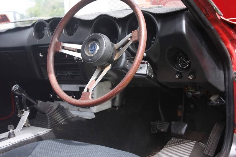

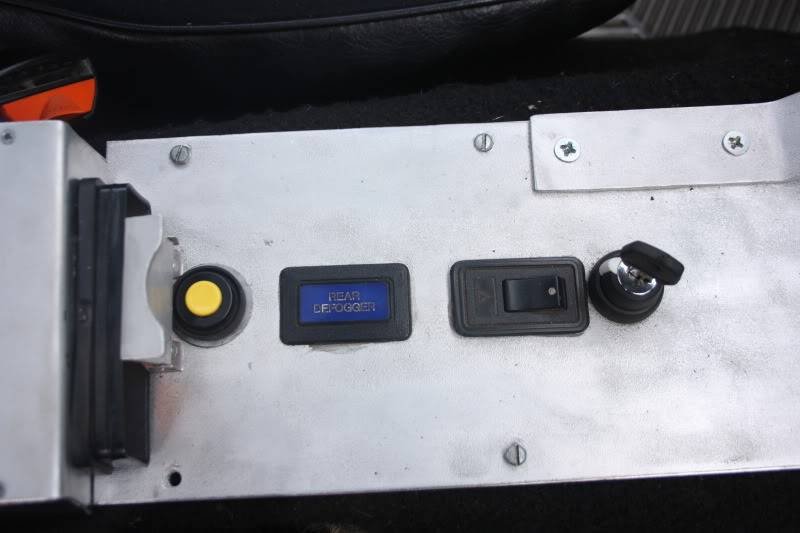

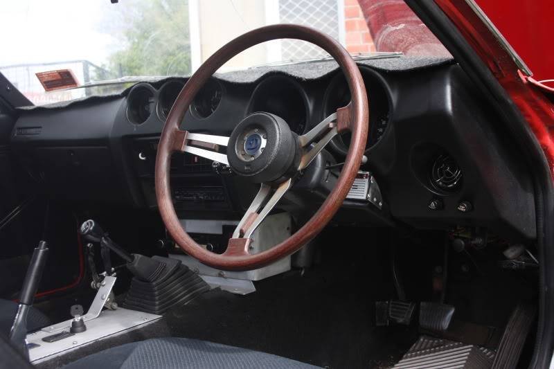

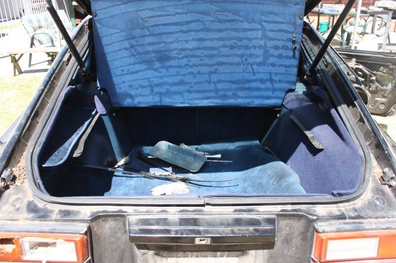

Interior...this is where it starts to get weird

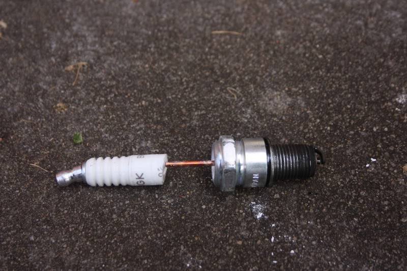

Pulled this out of number 6...thought it could have been the reason why it ran so rich, so I replaced it. Still no luck

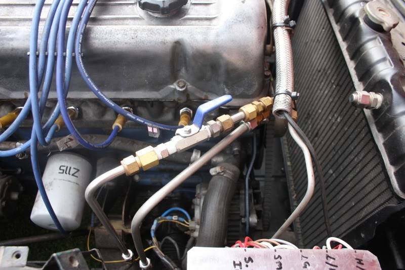

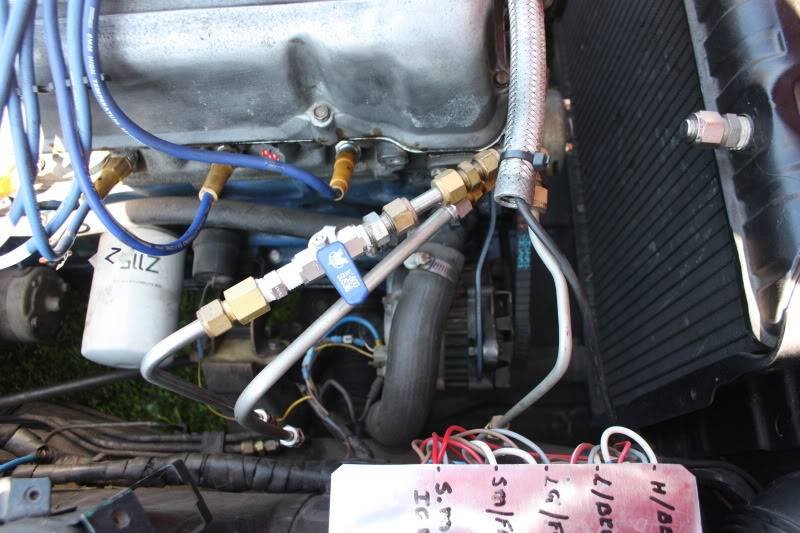

So starting poking around the engine bay...it had a weird fuel system setup.
After a few weeks of playing around with different people we came to the conclusion that one of the fuel lines was "supposed" to be a fuel breather. It connect to the number 6 runner of the inlet manifold, completely bypassing the carby. Could have done its job when it had the twin SU carbys on it, but with the single one it was creating a vacuum and sucking fuel straight out of the tank and in number 6.
So we blocked it all of and it ran a treat. Only problem now is, I dont know how long it has been running this rich (basically it has diluted the oil giving it an extra half a litre when I changed the oil).

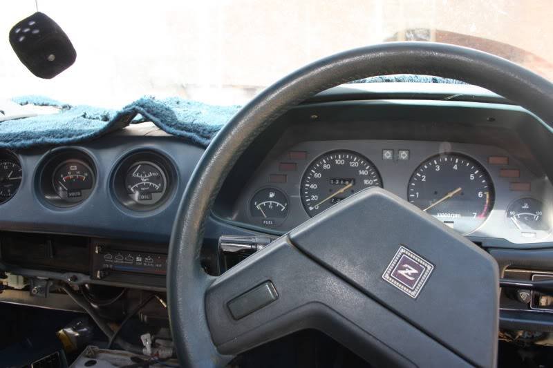

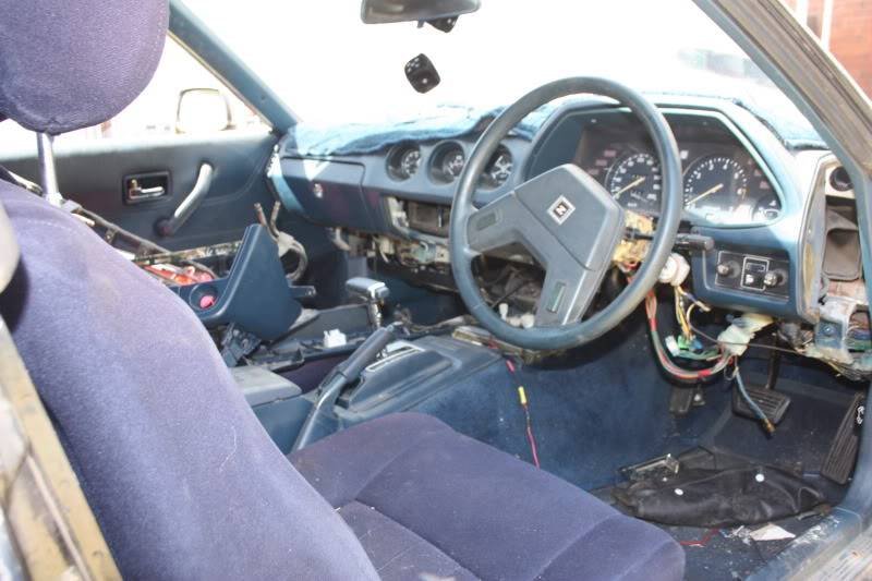

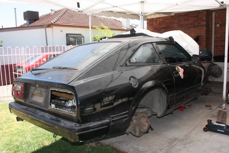

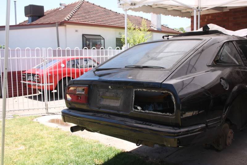

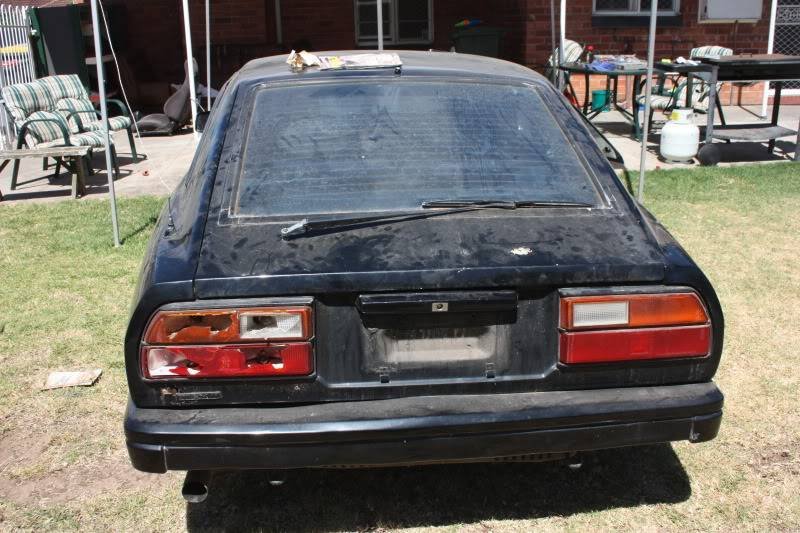

Yesterday I picked up a 280zx to use for parts. The chassis rails looks like its been driven through a volcano.
Plan is to rip the L28e out and shoe-horn it into my 260z along with the interior. The interior in the 280 is complete..unlike mine. Any parts I done use will be going up for sale.

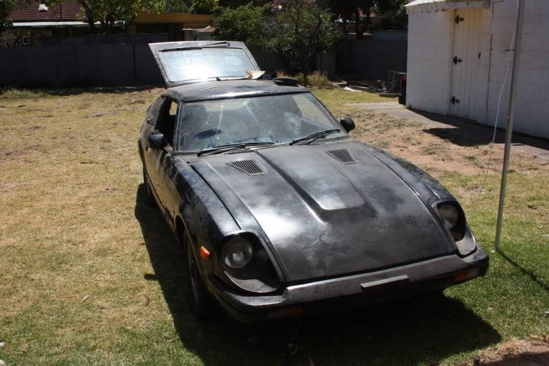

The 280 parts car

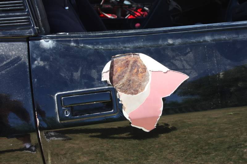

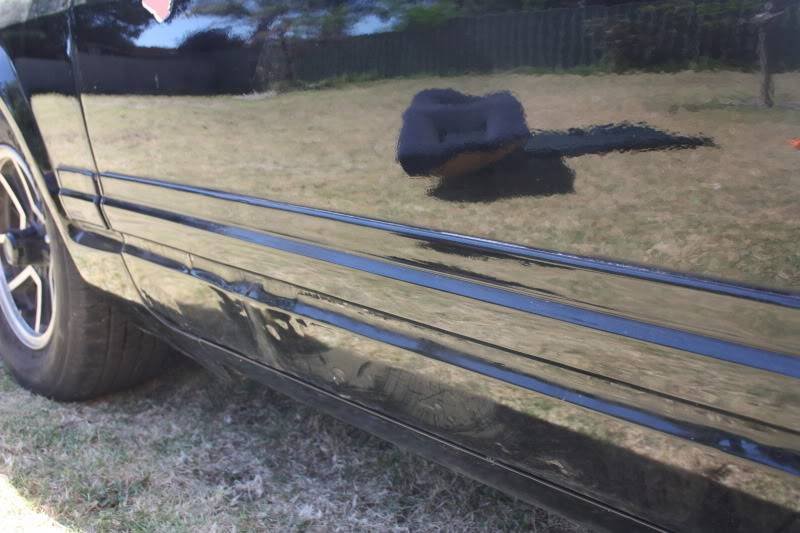

Drivers door...basically bog

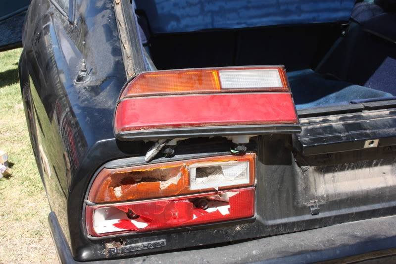

Replacement light

Also will a 280zx interior fit inside the 260? I've found the doors are differnt bit I dont know what else is.

The gearbox is a direct bolt-up :) As for the interior, I'm not quite sure how that will work.... You have both cars on site right? Get out a tape measure and see how the width goes, it could be an interesting conversion!

I'm always interested in interesting swaps, but to me putting a 280zx interior in to a 260 would be a bit of a step backward, but whatever floats your boat. Just as an FYI, the 240/260/280Z are all the same, more-or-less, the 280zx is a new model with a lot of new parts so I'm not sure how it would go for parts to swap into the 260, but probably not well. You may find you're best off (easier, cheaper) just nicking the motor from the 280zx and selling the rest of the car and getting another 260z 2+2 for a parts car.

Moved the parts car under some cover and put the rear on some jack stands. Seems there are some semi-decent Pedders shocks in the rear (with king springs *sigh*).

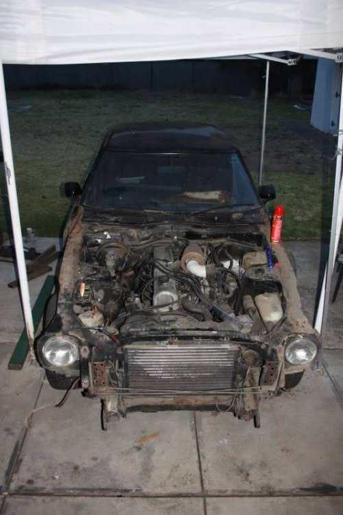

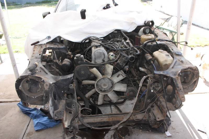

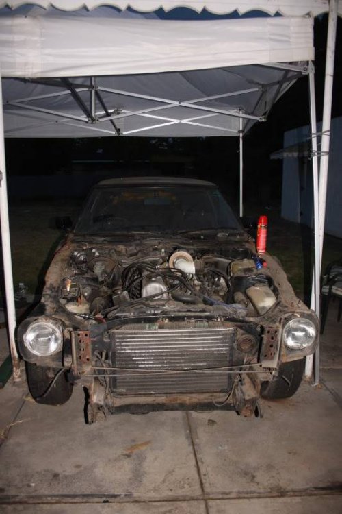

Pulled the front end off
rust is a bitch.
Got the 280 off the ground today

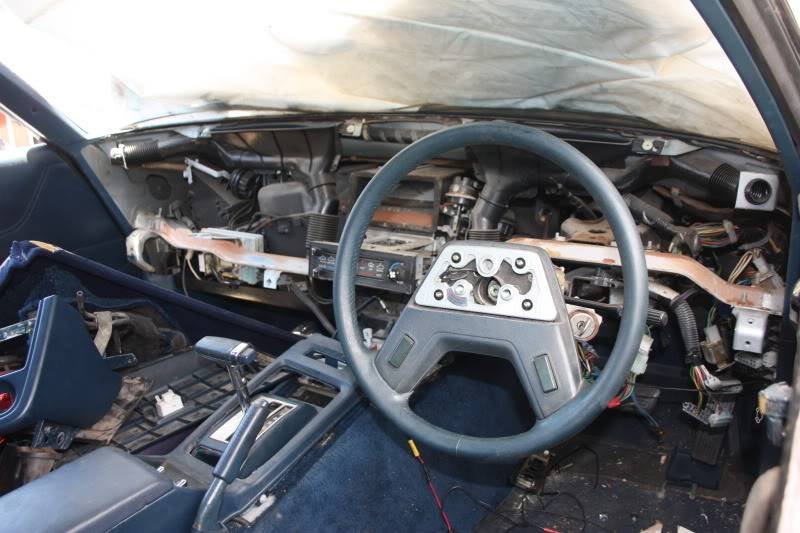

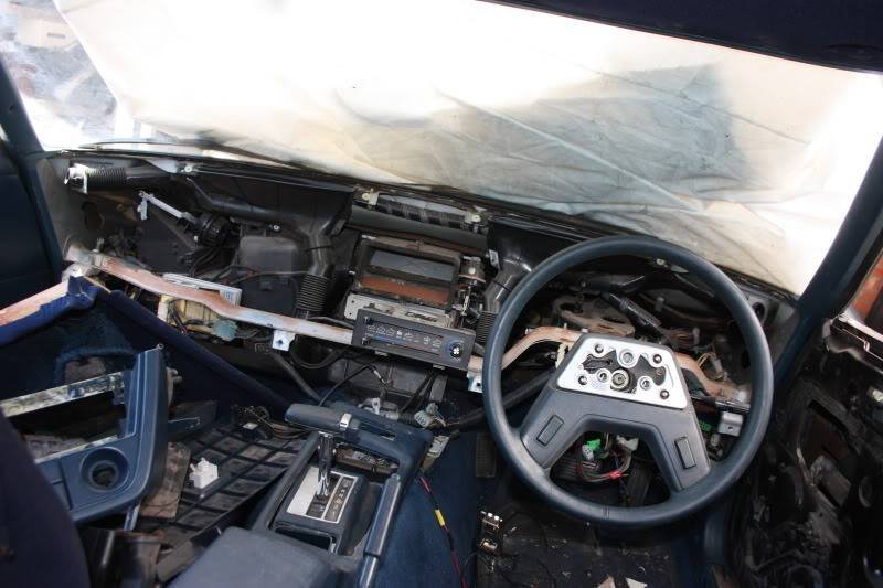

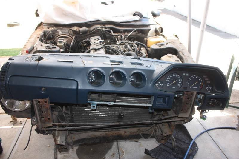

Started taking the suspension out and realised I need some more tools. So decided I'd take the dash out..
Seems to be fairly low k's

Love the FrankenZed concept, I reckon it would look very interesting with the 280zx Dash in it...might be a little too wide, might have to shave her down a bit on both ends..... the 280zx seats are more comfortable as well.
