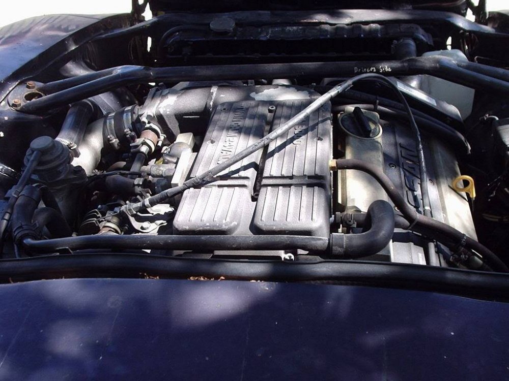

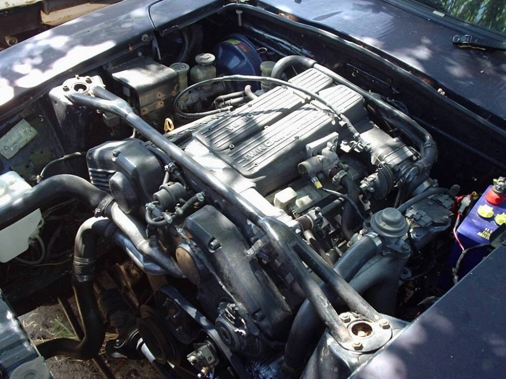

very tight fit with poor accessability for maintenance,aftermarket parts not as cheap or available once you deviate from standard,$ per hp probably better off with an RB25DET or RB30ET,resale value people probably prefer the RB route(put it this way ,i sold a complete running,licensed 2+2 with a VG30DET with programmable ECU and 5 speed for $3000 :'()
anyhow good luck with the venture and keep us posted
a few pics i took before i sold it
