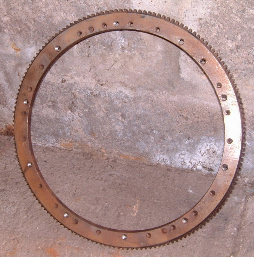

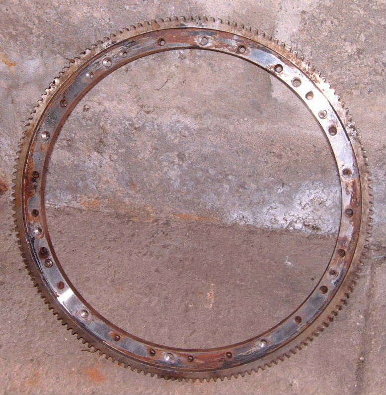

I also have a picture of a ring gear I've sourced which I'm trying to identify if anyone can help. (file size too big to attach, will try and compress)

I'm trying to identify this ring gear. It is 332mm diameter to the outer section and 310mm to the inside of the outer ring. Thanks.
I can't help identifying your ring gear, but it's not 280zx.
My 12/'81 (series 2) 280zx 2+2, NA, auto, has a welded flexplate, with an OD of 305mm.
I'm guessing that all L series flexplates would be the same OD, although there were differences in their profile to accommodate different torque converters.

The ring shown has 2 studs, 10 threaded screw/ bolt fixing points and one fixing point has two smaller threaded fixing points either side.
I've previously been told its not a 240Z manual flywheel but i'm still not sure about the variety of 280's.
Thanks.
Thanks again for the reply,
The ring was sold to me as being off a 1981 280ZX 2+2 Auto but as yet no one anywhere is aware of a 'non welded' flexplate but I'll let the subject run, It'll be good reference knowledge in the future when I update the other forums.
