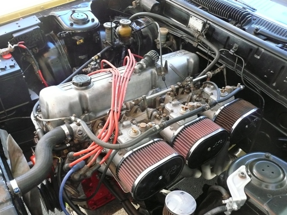

I've decided to go RB30 and so now I'm selling my L28 and triple 45 weber set up. A few details. Firstly the motor came from Nismo with webers and 3.0l bore. I can put you in touch with the person who imported it from Nismo. Motor recently (100k's ago) had a brand new camshaft from Clive Cams put in by Daryll Penley formerly of Automotive Tuning Centre in Welshpool. Daryl has serviced this motor over the past 10 years. The motor was dynoed after and produced 170hp@the wheels. The motor is stock apart from bore and cam. I've run it down the 1/4 mile and best time was 15.8 but my Datto weighs 1270kg and I'm not the best racer.The motor has a stock N42 head, N42 block bored to 3.0L from Nismo. The triple inlet manifold is from East Beer Japan, has Jap writing on it. The webers have not been touched since imported and they are remarkable, both condition wise and ability to stay in tune. I'm only selling because I aim to have above 230 hp@tw and turbo for me is the way to go. If your interested please call me, I'm looking for offers around $2200. Come and have a drive and listen, you'll be impressed I'm sure. Great upgrade for a Z. Ph 9581 8997

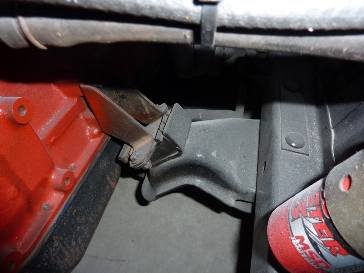

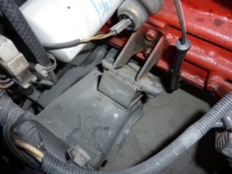

Will post a pic of mounts tomorrow. My car is being painted currently, but I'm going to have a look at it tomorrow.
I know the RB30 sump doesn't fit your Zs', but it does on my C210 Skyline.Do the RB30 mounts match up to the L series or is there an adaptor required from CRS

Thanks for answering my question. Reason I ask is I'm contenplating going down the turbo road with my N42/N42 set up for more HP. With my 3.0ltr bore and triple 45 webers, mostly stock engine apart from 72degree cam, I'm making approx 170hp @tw. 1/4 mile time 15.878. My Datto Skyline weighs 1260kg, probably heavier since the R200 went in. I'm wanting about 230HP @tw, which is asking a lot from the N/A I think, prove me wrong please. So if this figure is possible from the N/A, from the money aspect, is it better or cheaper to turbo the motor I have now or build up the N/A. I've seen stroker kits and they aint cheap and keeping in mind I can sell the triple set up to fund turbo parts. I know with turboing you can spend truck loads on turbos' and ECUs'. Also I'd have to lower my comp as it's around 9-10. Has anyone done the conversion from N/A to turbo and remember what cost were incurred. Appreciate your thoughts on this bogggling decision. Rick
