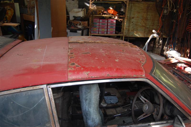

Patch Posted November 29, 2011 Posted November 29, 2011 [quote author=gilltech So on a sidenote, can 2+2 roof skins be used to infill sunroof holes on 2-seaters? Okay I am going to say yes,and unless I can get a 2 seater roof for a reasonable price this end of the country I am going to try it, here are some pictures of how close it is, will need to just hopefully jack the middle of the top frame up 5mm to give the same bow in head rail as I need the head rail both sides. and at the door frame the roof cut will have a dog leg and the the roof will be welded on the top edge of the hatch frame and the 240 side rail. Quote
Patch Posted November 29, 2011 Posted November 29, 2011 On the photo of the chrome strips where the clamps are is the part I am using of the head, that is at the widows edge, and has you can see it just needs a little curve to match, from that point back it changes too much.the 2+2 is the bottom one, as you can see different angle in the windscreen posts. Quote
gilltech Posted November 29, 2011 Posted November 29, 2011 So if the 2-seat vs 2+2 windscreen posts lean back at differing angles, are the windscreens themselves (the glass) still the same? ie interchangeable? Quote
Patch Posted November 29, 2011 Posted November 29, 2011 I have been told yes, so hope so as I hope to use my 2+2 in my 240z, as you can see there is not much of a change of angle, just enough to allow more head height for the back seats. I am using the top windscreen frame with the roof and that is the same. Quote
