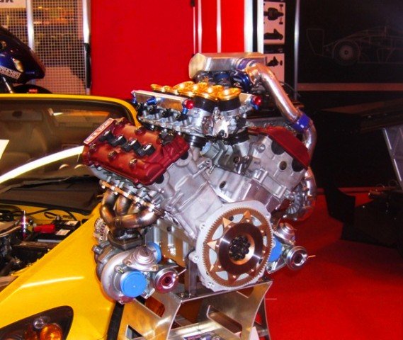

NZeder Posted June 20, 2011 Share Posted June 20, 2011 Synergy V8 or the Hartley V8 Quote Link to comment Share on other sites More sharing options...
NZeder Posted June 20, 2011 Share Posted June 20, 2011 Both those engines will fit in the Oz rules - 2400cc to 3000cc the Synergy unit 2400cc and 390HP and 95KG Quote Link to comment Share on other sites More sharing options...

Patch Posted June 21, 2011 Share Posted June 21, 2011 What sort of price are they asking though? Found this on the Hartly V8 H1 V8 pricing 2.8 liter V8, approximately 400 hp. Engine is inclusive of hardware as described below.... $27,700 · 6061-T6 Billet crankcase, sump, front cover and rear cover · Reconditioned Suzuki parts- heads, cylinders and throttle bodies. Heads are reconditioned with ground valves and seat, and new seals. Cylinders are bored to 84mm and NSC plated. · Billet crankshaft- 63mm stroke · Engine mounted sensors · H-beam 4340 billet connecting rods with ARP custom age bolts · Starter and 55amp mini alternator · 4 stage Pace or Aviaid dry sump 0il pump · Small flywheel for 5.5” clutch or large flywheel for 7.25” clutch · Custom rear engine adapter plate for popular gearboxes · 40mm billet velocity stacks and adapter seals · Test run engine · Installation Manual* Technical support as required for successful installation and operation · Box and skid as required for shipping Popular options for H1V8 (other options are available).... Ø 67mm stroke crankshaft upgrade 3.0 liter version of engine and related modifications to deck height and cam chains...$1,200 Ø DTA engine management system with software and connector kit…$1,800 Ø Programming of screens and integration of X-Dash unit …$150 Ø Performance modifications (cams and CNC ported heads) …POR Quote Link to comment Share on other sites More sharing options...

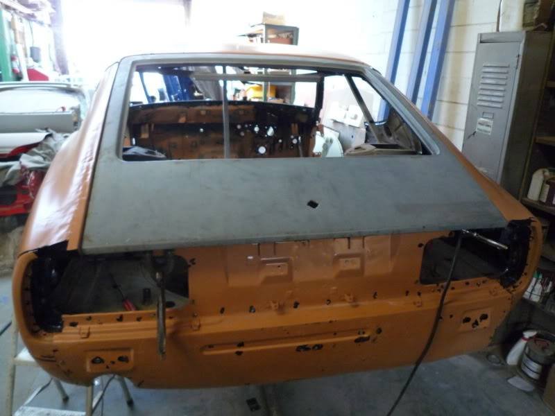

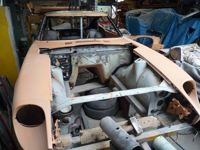

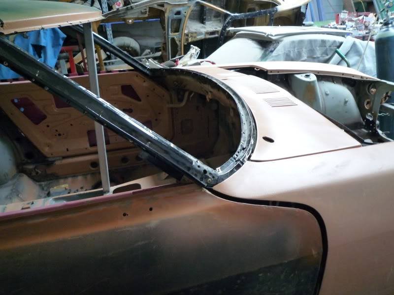

V8Datto Posted June 29, 2011 Author Share Posted June 29, 2011 Finding info on allowed engine conversion's is next to impossible, when I'm ready I'll let the engineer answer the questions. Not interested in the L6, I want to drive the thing not work on it More pic's. Still in the trial fit and test phase Using panels off other cars is always very handy to check measurements. Just in case mines not 100% Quote Link to comment Share on other sites More sharing options...
DeWit Posted June 30, 2011 Share Posted June 30, 2011 Awsome job on the build mate, i should have done that to begin with myself, but 5 years to build it was enough without adding another 2 for panel. In regards to an engineers, i have been talking to a few different ones. I went down the RB25turbo route, With an RB30 bottom end with very similar numbers in the garage. Its worth talking to a few different engineers, they all have different interpretations of the rules. As of the 1st of February this year you even need an engineers for club rego. VIC roads is closing all the holes, but gives you some outs. http://www.vicroads.vic.gov.au/NR/rdonlyres/CC48FC10-4D57-4F04-82E1-3BD72EF88340/0/VSI8.pdf As far as i can tell you just need an engineers to prove the car is safe for a "Street Rod" http://www.vicroads.vic.gov.au/Home/Registration/PermitsModificationsAndDefects/OtherPermits/ClubPermits.htm Quote Link to comment Share on other sites More sharing options...
Administrators gav240z Posted July 14, 2015 Administrators Share Posted July 14, 2015 So.... any updates on this build? Just went through all your photos which was helpful in terms of seeing how everything is welded together on an S30z and couldn't resist bumping this up for people who may not have seen it. Quote Link to comment Share on other sites More sharing options...
V8Datto Posted December 2, 2015 Author Share Posted December 2, 2015 Well I've moved house and have no room to work on the car ATM, Well heaps of room but no shed. Looked at an RB26 a while back, parts alone was worth it but engine could not be tested, not sure on previous history either. S30 shell is back together so a few more pic than is on here but not many Quote Link to comment Share on other sites More sharing options...
