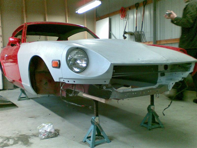

FuzzyDropbear Posted August 28, 2010 Author Posted August 28, 2010 So those crazy guys named Scoota and Dale dropped around today to see what had been done to the shell and to discuss what I could do about it. After we reached a conclusion of what I needed to do, Scoota, of course, gets that strange glint in his eye and asks "what power tools do you have??". So we started work on the side which I hadn't chopped the random bits of metal out of. So 'zap zap' and it looked like this. I sh!t you not when I say that random bit of metal hanging down is about 5mm thick! So Scoot knuckled down and started taking the grinder to the front end and we ended up with this segment cut out. [table] [tr][td] [/td] [td][/td][/tr][/table] With that chopped out, Scoot used it as a template and obtained the relevant segment from my parts car and did a bit of panel beating to get it straight before unleashed the fury with my new welder and set it up properly for me [table][tr] [td][/td] [td][/td] [td][/td] [td][/td][/tr][/table] The end result looks a million bucks, no random holes and pieces of metal riveted etc. onto the chassis. We also plugged up a few random holes that had shown up and test fitted the guard to make sure everything was nice and straight. A while ago, Gav was looking for photos and a brief description of why people found ausZcar useful, I think this photo of Scoot with the caption 'because I have found other people's Z's to chop up' would fit the bill? [table][tr] [td][/td] [td][/td] [td][/td][/tr][/table] Thought I'd also include a photo of what we removed.. Only a couple of layers there! Thanks to the boys for their work today, I think after today's tutorial, I'll have the confidence to have a go at any other segments I need to. Quote

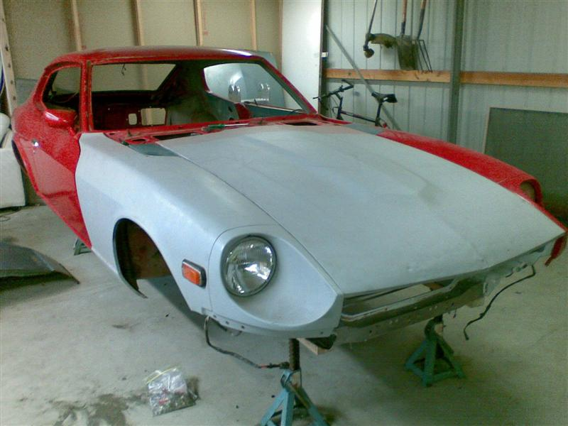

Scoota G Posted August 28, 2010 Posted August 28, 2010 How much fun was that, here's two pictures of the nearly finished product as featured in another thread. Quote
