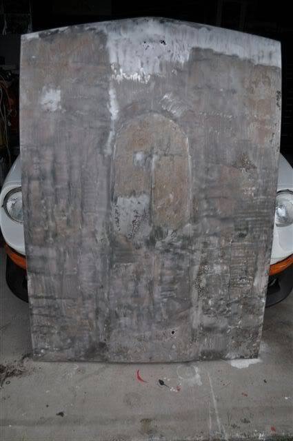

RB30X Posted July 23, 2010 Posted July 23, 2010 Hey John, where's part 2? I've got a bonnet that I'm preping and need your next episode. Need to know what sort of primer/filler to use. cheers Quote
Sirpent Posted July 23, 2010 Author Posted July 23, 2010 Hey Tim, Well Part 2 would have well and truley been up and posted by now if my boy hadnt gotten so sick and I ended up taking the time off work for my annual leave like I'd planned, unfortunately the last almost 2 months has been like winter in Siberia as far as my build is concerned and any progress on it. But seriously, cant you find a better bonnet than that ????? Maybe it looks worse in pics than it is, Im kind of the same, not very photogenic. What are you planning? Quote

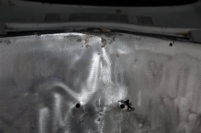

Zedsabbath Posted July 23, 2010 Posted July 23, 2010 A trick that usually works good for small rust holes Tim is soldering neat little bits of clean sheet metal underneath and building the solder up so it can be filed of on the outside of the panel, sounds a bit bodgy but if it's done where the repair can't be seen with rust proofing or insulation it's an inexpensive, quick and effective way to ensure the panel remains all metal It's conducive to lead wiping except you're filling a small hole Pete Quote
