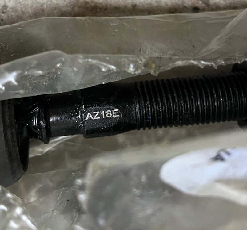

Roady Posted July 7, 2024 Posted July 7, 2024 (edited) Hey everyone, I’d got my hands on these inner tie rods which came from Z Car Depot a while ago. Anyone had any experience with them. The quality looks reasonable but Chinese made. Otherwise I can go through Ultimate Power steering… Cheers Edited July 7, 2024 by Roady Quote
