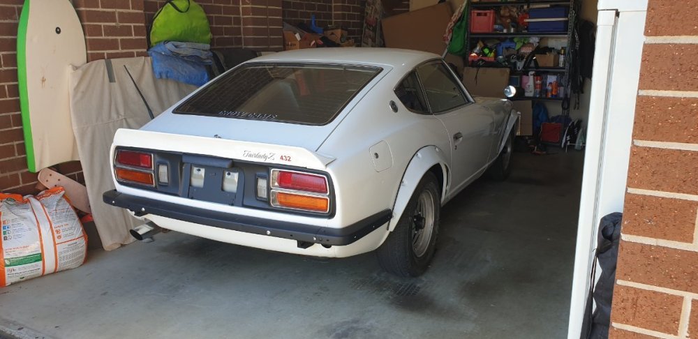

OdinZ Posted May 11, 2022 Posted May 11, 2022 (edited) So as a few of you would know, I made the decision to sell my 2+2 (https://www.viczcar.com/forums/topic/16813-neds-z-76-22/) early 2020, as I felt that I would need to spend too much money to get it to the stage that I would be some what happy with, and with a little one on the way and the wife buying a new car, it just made sense to me to make way in our single car garage. This finally sold in April 2020 just after we got out of Melbourne's first lockdown. Now for those who like long stories: As most people with the Z bug, I never actually stopped looking for another Z, preferably 2-seater (most have always been out of my budget), or if the right 2+2 appeared, I would still be happy, but this was not at the front of my mind during 2020. We all know prices started to creep up, and then we got of lockdown for the summer, I started paying more attention! April 2021 came around, an orange 260z appeared on Facebook for $40k I believe, but sold the same day. It was that day the wife and I discussed a budget should something like that appear on the market again. The seller also had a white 2+2 for sale as well, so I thought I'd go have a look. Not my thing, but he had another 2-seater, but as I umm'd & ahhh'd, it sold later that day. DOH! After chatting with Gavin, I decided to put a wanted ad on facebook and gumtree with a budget of $40k for a Z I could essentially hop in and drive. A couple of projects, some rust buckets and a couple of Zs for $70-90k. Then one guy just NW of Melbourne, messaged me and said lets talk. I have a white 260z (originally silver) with a 4.4L V8 from a Leyland P76, Supra 5-speed (W58), R180 diff (assuming OEM 3.7), he sent me some pictures and had a decent price range around my budget. I was a bit snobbish about the idea of the motor, and we also just went into yet another lockdown, so I kept the conversation open and said we will organise inspection after lockdown. He said no worries, I am not in a rush, and I am not going to list it. He wasnt even looking to sell it, but saw my wanted ad, I guess they work. I message him early December to see if he still wanted to sell, and he said he will let me know in a couple of weeks, so I reached out again and he gave me a non-negotioable price under my budget. Sweet! Organised to go have a look at it with the Z Godfather, and to both our surprise, the body was in very good condition and barely modified to fit the motor, and currently on club permit with the motor. We agreed on price, and said he will hold it until I am ready to collect it. January came around, picked up the car and took it to a mechanic, who said it wouldnt be an issue with the motor regarding the RWC, he would give me a list of things I needed to fix, and he also got the carbie sorted, so she starts up first time. Then the fun started, he did some work on the motor and the carbie, got it running, then tells me he wont give me a RWC without an engineers cert. (Car has previously been registered and on CPS with this motor, so not really his concern). Off to another mechanic, and the list of things to fix was relatively small compared to what I was expecting. - drivers side seatbelt freyed - door rubbers - tires cracked - bonnet safety catch missing - gearbox mount hitting metal - engine mounts to be replaced (standard 260z mounts) - exhaust too close to the steering arm (less than 15mm, could cause binding) - headlights not working (headlight switch and also loose connection at drivers side headlight) (The Japanese Torana) Edited August 31, 2022 by OdinZ 77260Z, gav240z, C.A.R. and 3 others 5 1 Quote

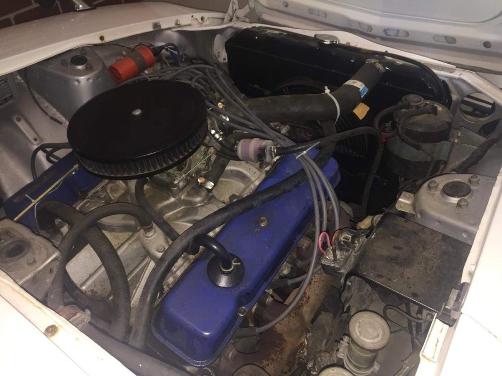

Administrators gav240z Posted May 11, 2022 Administrators Posted May 11, 2022 Best part is, being a late 260z the engine number is not on the ID plate in the engine bay. It just says type "L26" so you could swap an L-series back in and it would be "original" again. But the V8 is kind of fun, if you plan to tow a small boat in future. theremm, OdinZ and C.A.R. 3 Quote

OdinZ Posted May 11, 2022 Author Posted May 11, 2022 1 hour ago, C.A.R. said: Don't laugh at me, wait until I get you to cut my guards............ I also know you now want a V8 Z to go racing in! 1 hour ago, gav240z said: Best part is, being a late 260z the engine number is not on the ID plate in the engine bay. It just says type "L26" so you could swap an L-series back in and it would be "original" again. But the V8 is kind of fun, if you plan to tow a small boat in future. You heard it here first folks. Full disclosure, Gavin has since driven the car, and thoroughly enjoyed it's quirkiness compared to an Lseries 240ZBUILTBYME and gav240z 1 1 Quote

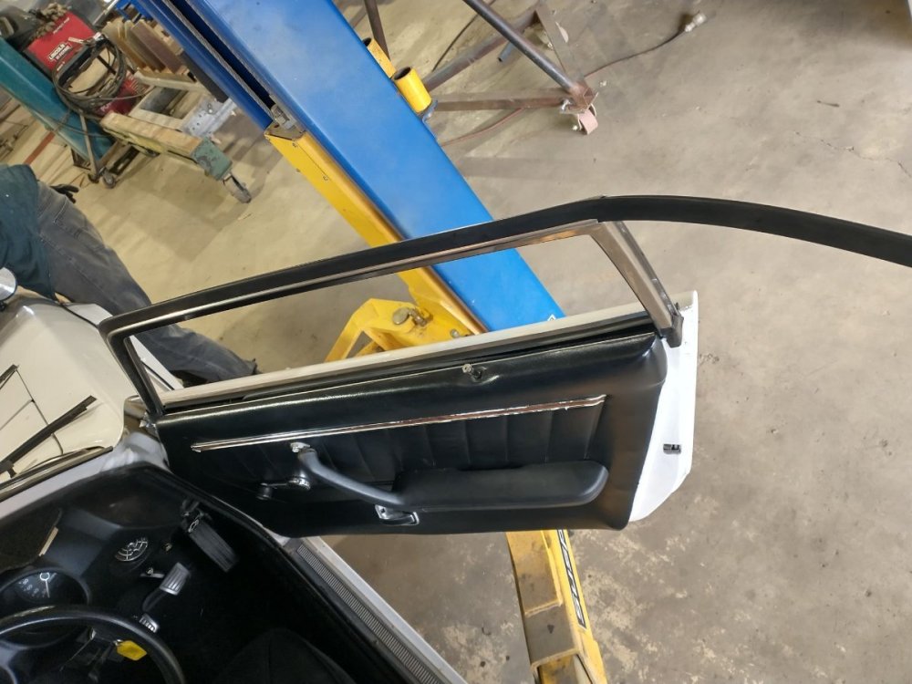

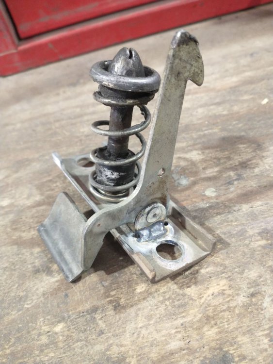

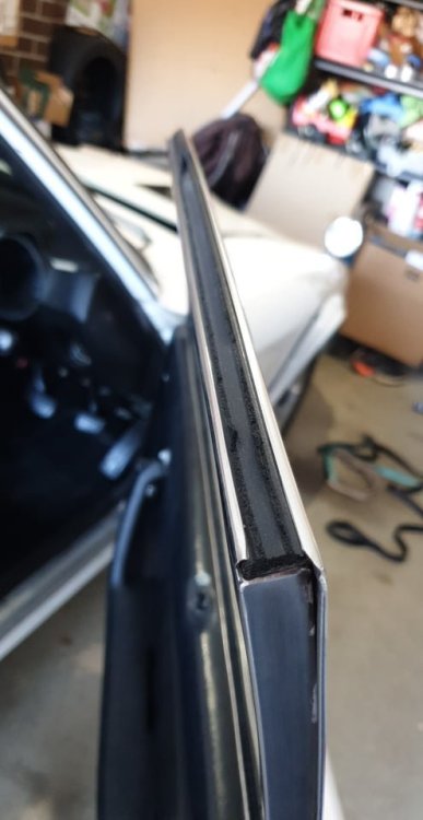

OdinZ Posted May 11, 2022 Author Posted May 11, 2022 (edited) So now I had to wait for my turn in the shop. First job, new bonnet safety latch fitted: Then to the door seals/rubbers The gearbox mount was slightly modified to stop metal hitting metal and causing vibrations. It was then blasted and painted: Edited August 31, 2022 by OdinZ Quote

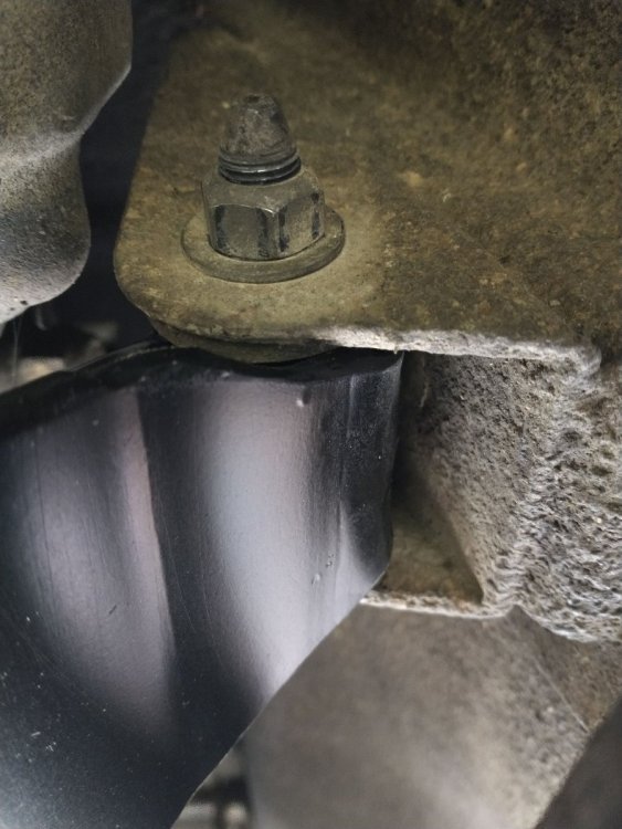

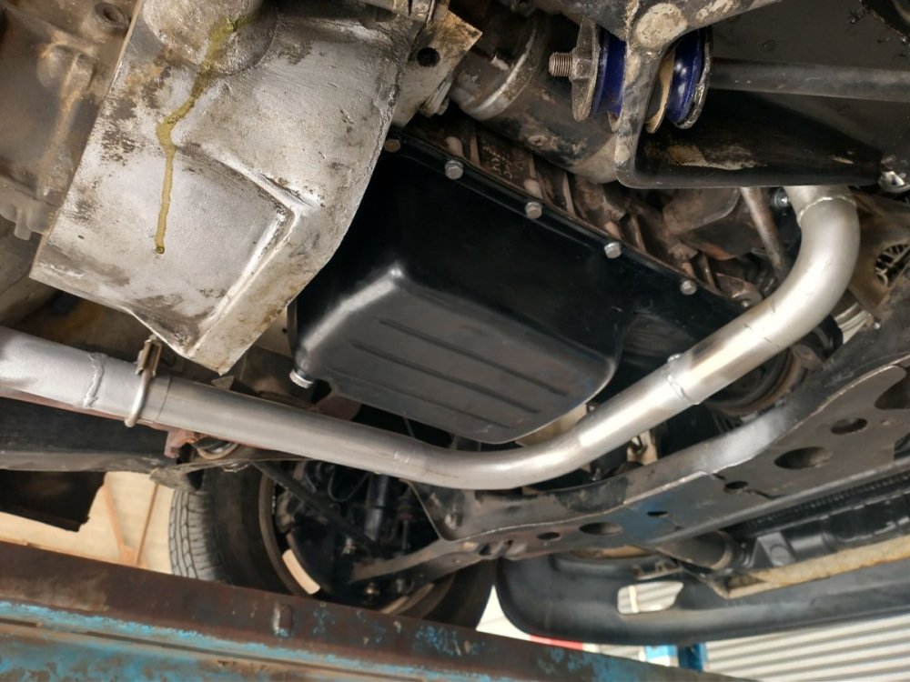

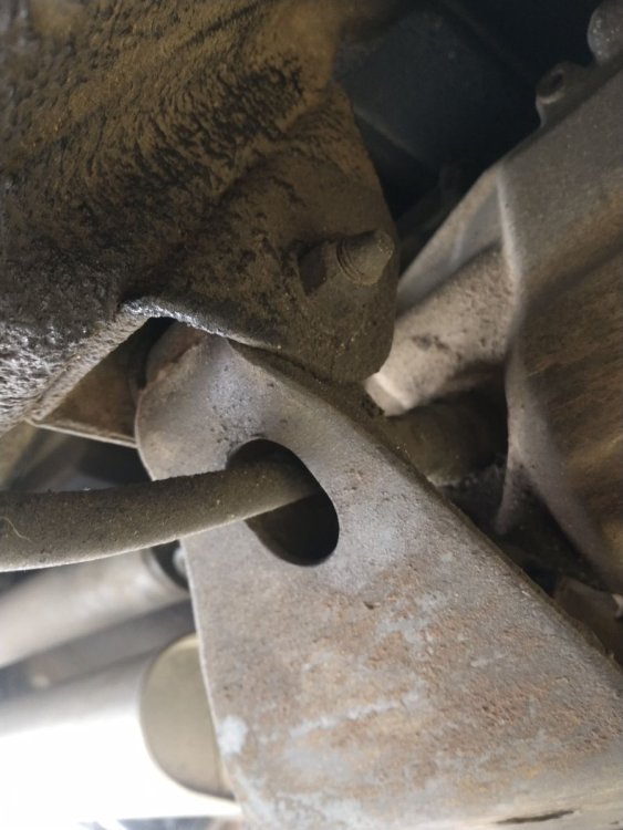

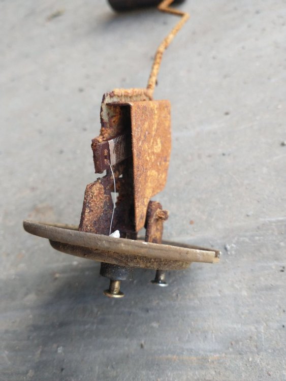

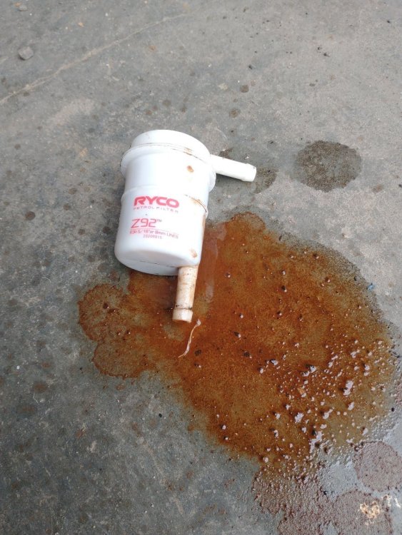

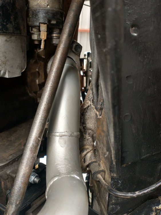

OdinZ Posted May 11, 2022 Author Posted May 11, 2022 (edited) New engine mounts & bolts, and you can also see the restricted exhaust and where it was very close to the steering arm, although kind of hard to tell from this angle: Off to the exhaust shop next Next, to work out why the fuel gauge wasnt moving..... Edited May 11, 2022 by OdinZ 240ZBUILTBYME 1 Quote

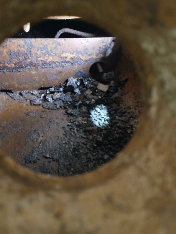

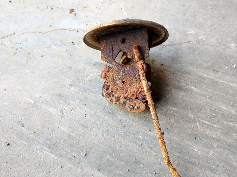

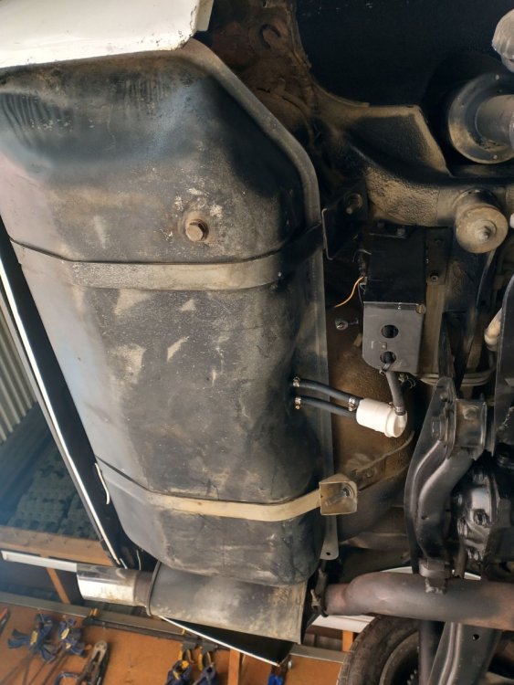

OdinZ Posted May 11, 2022 Author Posted May 11, 2022 Well this might be the reason: And as you would expect from the fuel tank & filter New sender has since been installed and the fuel tank has been cleaned out, dried and re-installed: 240ZBUILTBYME and gav240z 2 Quote

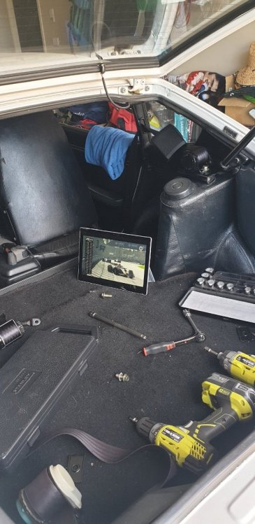

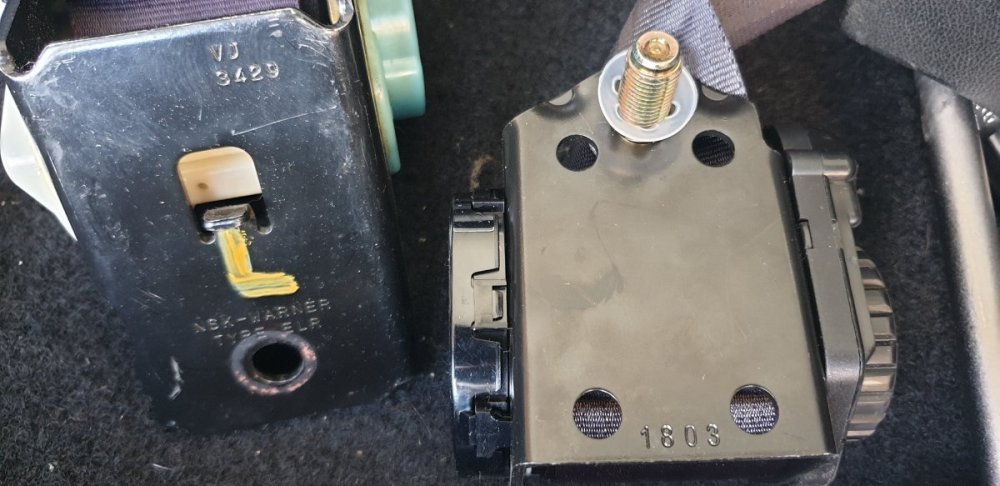

OdinZ Posted May 12, 2022 Author Posted May 12, 2022 (edited) Once I got the car back home, it was just a matter of waiting for the new seatbelts and finding the time to put them back in. We choose to get both sides rewebbed so they matched and were both new, seeing as they are the main safety device in the car, it was a no brainer. Seatbelt king supplied new reels in the end as legally they are not allowed to re-sew these, but they do use the rest of the old hardware. The new ones do not have the locating pin, hopefully this wont be an issue, as when I installed the new reels with the newly supplied bolts, they came loose when you slightly twisted them, so I used the old bolts and havent had any issues. Next up was to tackle the headlights, so swapped out the headlight switch, and they seemed to work for the first couple of days, and then passenger side was bright, but the drivers side was very dull. I cleaned out the connectors to the switch, seemed good, but then played up. The RWC mechanic said he would take a look at it for as well, turned out, a loose connection at the headlight........phew! Edited August 4, 2023 by OdinZ gav240z 1 Quote
