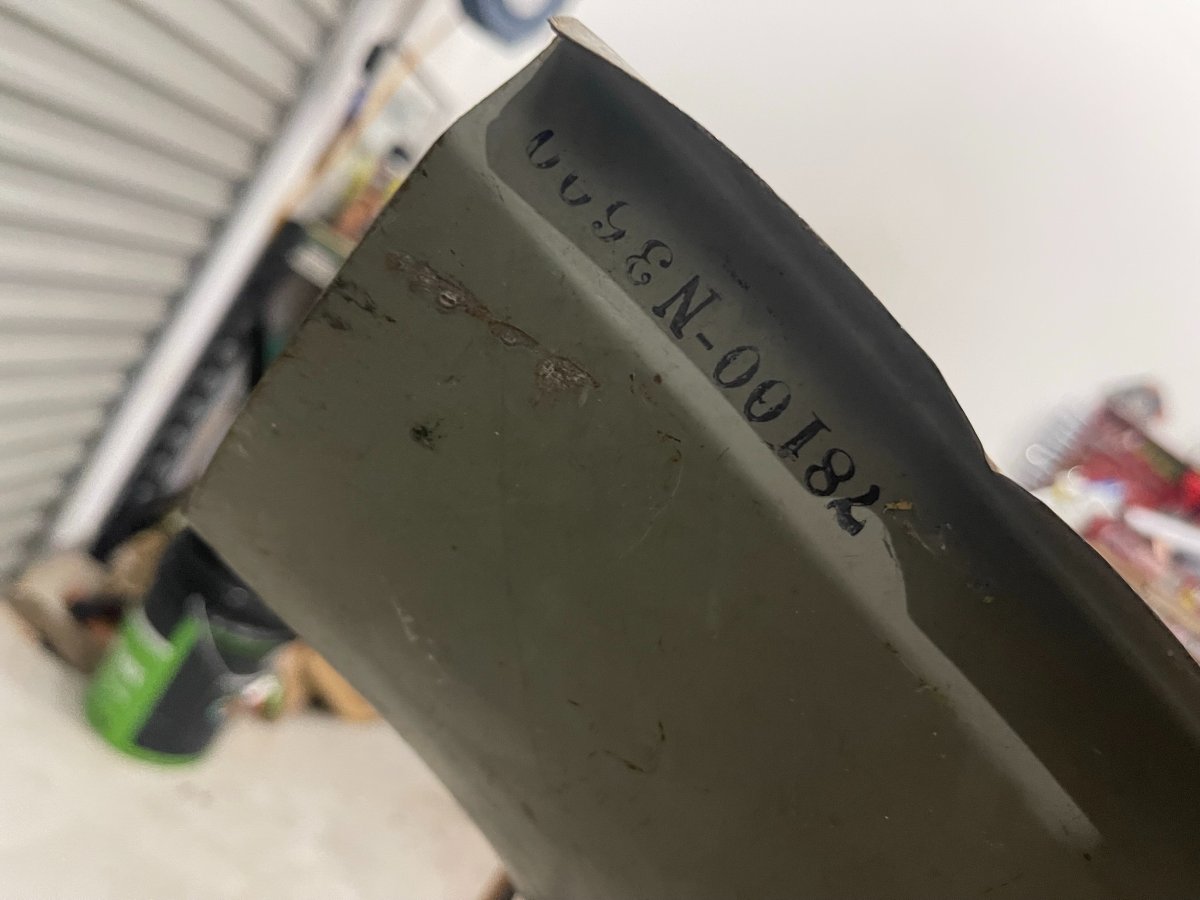

They are US spec quarters, so the indicator hole needs to be filled in. The drivers side could be early 260z 2 seater - There is a few extra holes around the bumper area which will need to be filled in.
IMG_6116.thumb.JPEG.d838d43e6e3b699e90db8d3b4599983a.JPEGIMG_6112.thumb.JPEG.bb9bb0e09244cc42caa2f9e65cdd34f2.JPEG
Factory rust. This is the behind the 260z quarter where the extra bracing/holes are. I won't be using these brackets behind here anyways.

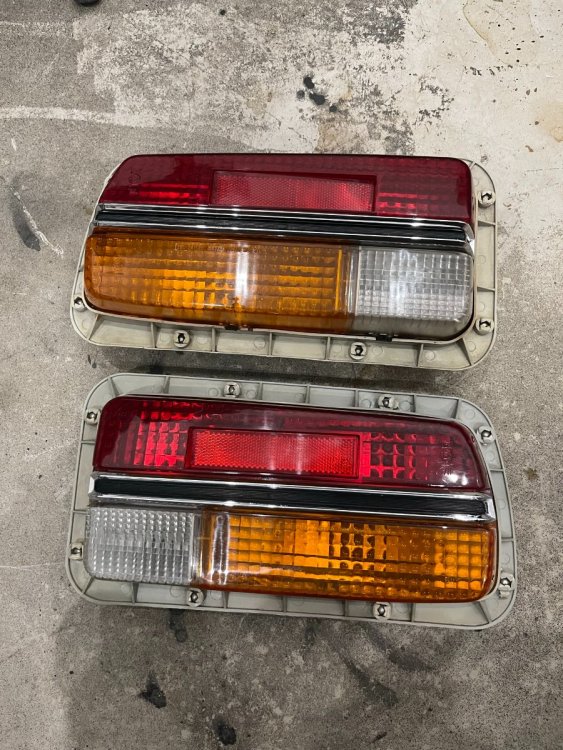

I also picked up a pair of lightly used rear tail lamps. They're immaculate and could come off as New old stock.

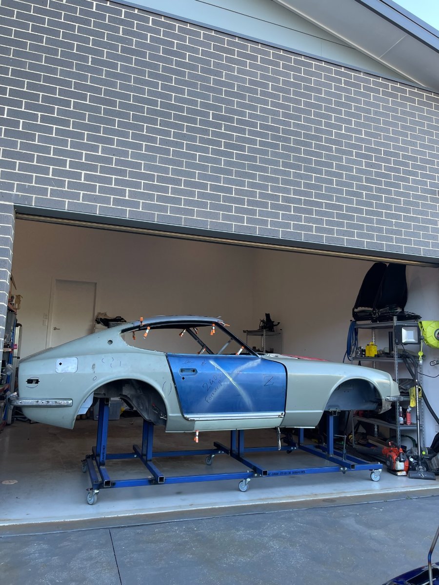

Once trimming was complete, I put the quarter on for a quick mock up.. and for the first time in what seems like along time - It now resembles a 240z again! (well, somewhat)

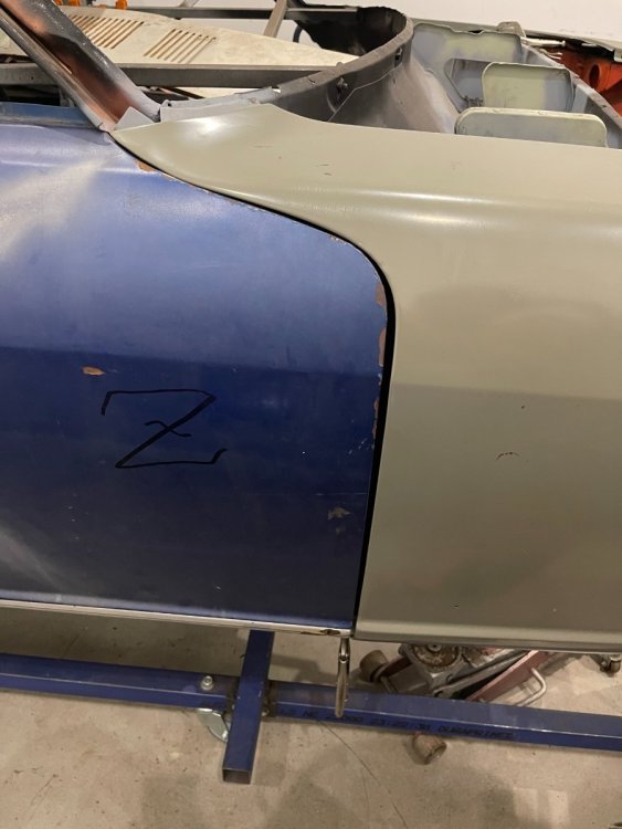

Resurrected classics front guards came in - Thanks Lachlan F for organising these.
At a glace, they look pretty decent - especially for the price tag.
There needs to be a little trimming around the edges, some holes to be drilled. But overall they seem to be a good replacement panel. The only semi-issue is that the tops of the guards have quiet a few ripples in them from pressing.
IMG_6327.thumb.JPEG.fa94f6c22c3e077d5132d2591a673215.JPEGIMG_6324.thumb.JPEG.286750def799433eca705080efba8071.JPEGIMG_6333.thumb.JPEG.4bf09cf37d55a1a36bf75cb9abb1a48b.JPEG
Gaps look funky because nothing is bolted on or lined up. Going to now make a start on getting the front clip ready for blasting.

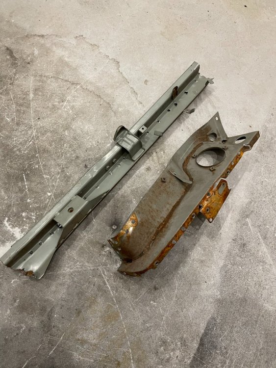

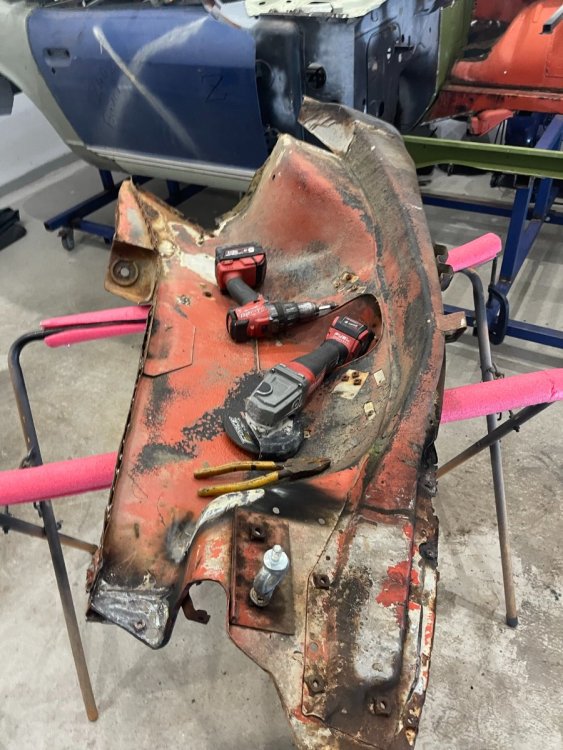

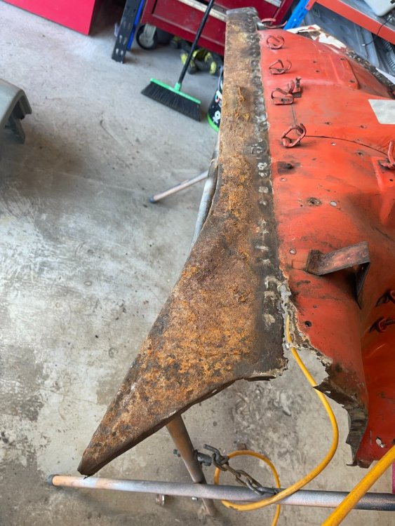

Got a start on preparing the front clip for sandblasting and repairing today - Drivers side was the start.
Rough cut to get the old chassis rails off.

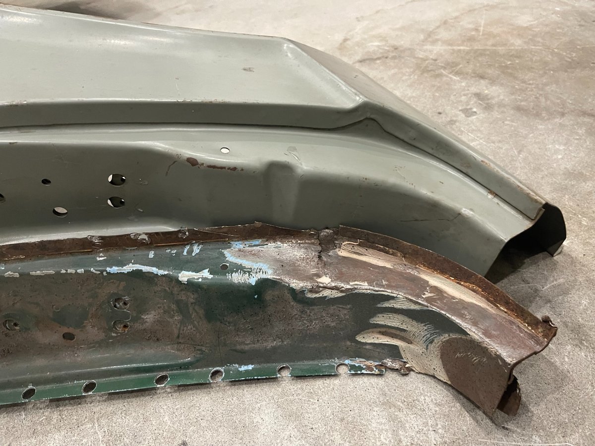

Unearthing all the hidden surface rust - something to note, the Chassis rails seemed to be significantly heavier than the 240z versions. Possible heavier gauge?
Only took about 2 hours to get the old chassis rail off as gently as I could. The KF vintage rail lined up perfectly with the existing engine crossmember bolt holes.. But something else seems to be happening.
In this position, the new Chassis rails are hard up against the firewall (where they are supposed to be)
The guard to door gap is not too bad, and the guard holes to front skirting panel area mounting points are nearly centred. Which indicates to me that the front clip/chassis rail is in the right position somewhat. (All panels are only mocked up at the moment, but bare with me)
IMG_6427.thumb.JPEG.2bed2e925d5c3a3a85ea227bd865920e.JPEGIMG_6428.thumb.JPEG.71e135549284b1d5700db08d684c0100.JPEG

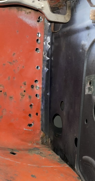

Now, i'm finding that there is a 10mm~ gap between the firewall and the surround skirting panel. This should be flush to the firewall like how the chassis rails are. I'm scratching my head over what could possible be wrong in this situation.
If the chassis rail is too far backwards, and if it were modified to go forward for the skirting panel to be pushed back flush against the firewall, then the door to guard gap would not existing anymore.
IMG_6409.thumb.jpeg.85e01e21f9e3d98555670416b080da5f.jpegIMG_6430.thumb.JPEG.a2d16a8563488bb0e92d8b82d5c05b04.JPEG
This gap also seems to be too big going off existing photos of non-crashed Z's. It's like the clip needs to move back 10mm, but the chassis rails and guard doesn't.
Are the engine crossmember holes in the chassis rails in the wrong position? Do the door hinges need to be adjusted back? (Still unadjusted from factory)
Quiet a strange one!

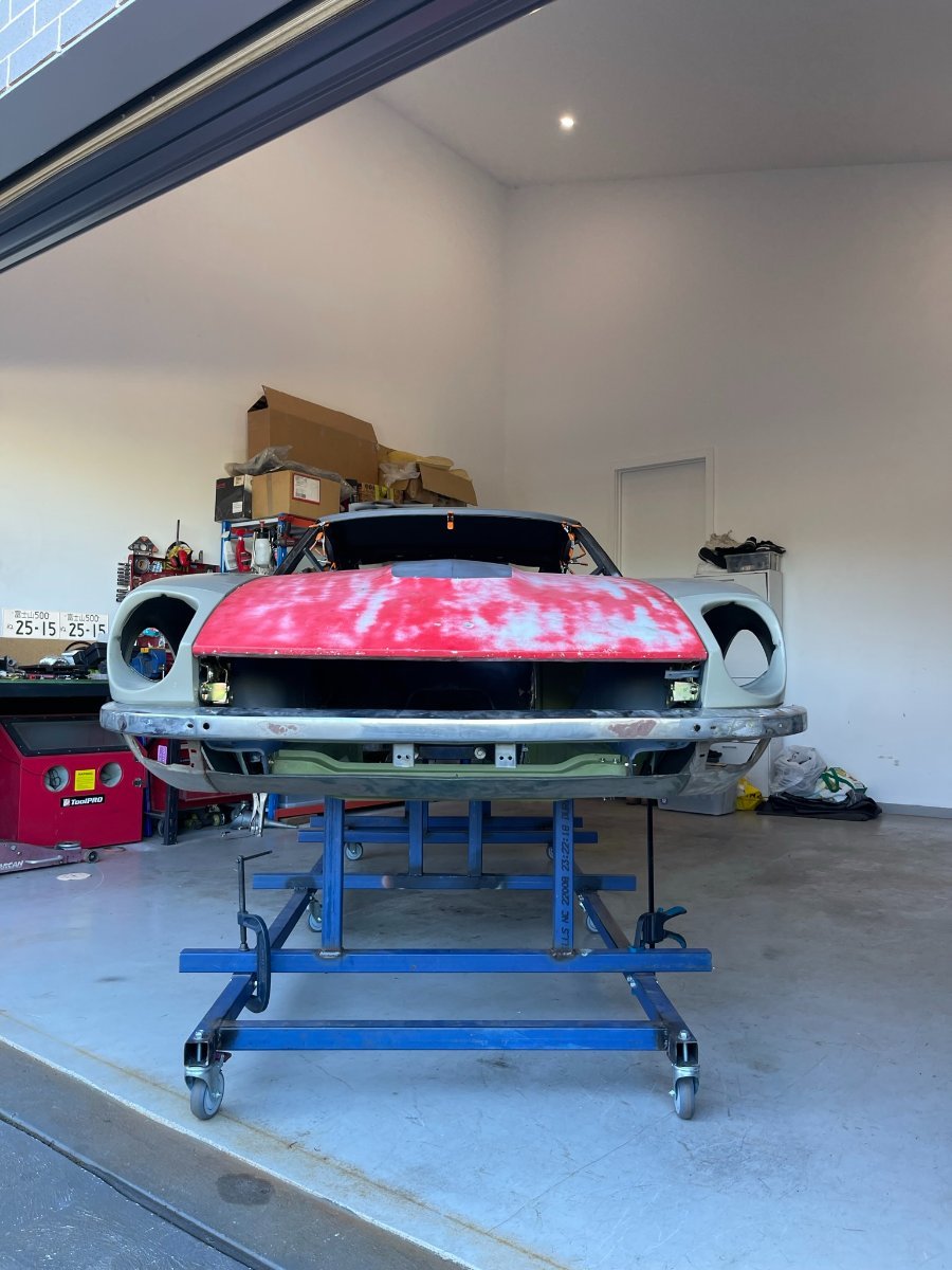

Getting closer. Front clip pieces sandblasted.
IMG_7665.thumb.JPEG.7b58763d6ca692ed5b3dfbd60ed88552.JPEGIMG_7664.thumb.JPEG.1eb1b3c806591c4f81a96c6fdd1455d4.JPEG
A little crusty on the edges/battery tray area, but overall not too bad at all.

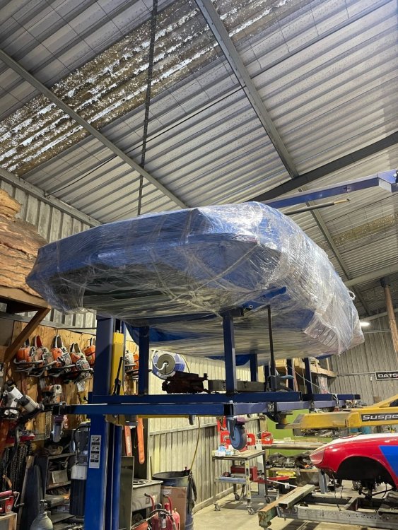

Wrapped up, heading to C.A.R.
When the 9:30hr drive turns into 13 hours. Shout out to the tarp for disintegrating itself at 5am in the middle of nowhere. Had to head to bunnings and wait for them to open to get some plastic wrapping to keep it in one piece.
