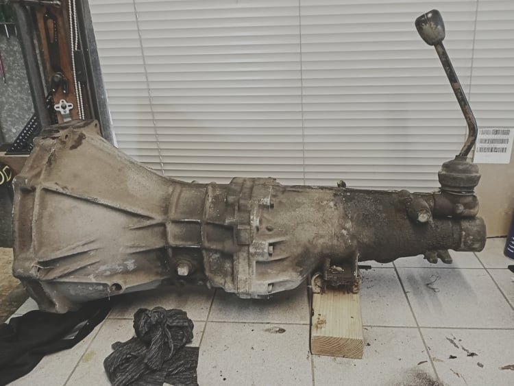

RunawaySloth Posted December 20, 2021 Author Share Posted December 20, 2021 (edited) Have this 5 speed for a possible auto to manual conversion. All the parts I need- master and slave cyl, flywheel, clutch/pressure plate all seem to be available new, mostly as aftermarket parts. The clutch pedal is the main thing I'll have to figure out. Get some lines made up. There'll be plently of unforseen hiccups no doubt. The body is coming along slowly but surely. Almost finished the right hand sill repair- replacing most of it. The left one is in pretty good shape and fortunately won't require such drastic action. Edited December 20, 2021 by RunawaySloth Quote Link to comment Share on other sites More sharing options...
C.A.R. Posted December 20, 2021 Share Posted December 20, 2021 You actually need a clutch AND brake pedal. JDM-TOY 1 Quote Link to comment Share on other sites More sharing options...
RunawaySloth Posted December 21, 2021 Author Share Posted December 21, 2021 (edited) 12 hours ago, C.A.R. said: You actually need a clutch AND brake pedal. Yeah I know! Saw you sold a pair fairly recently. Apparently the auto brake pedal is wider due to the extra room? Don't have another pair lying about do you? Or any leads? If I get completely stuck I'll cobble something up. Edited December 21, 2021 by RunawaySloth Quote Link to comment Share on other sites More sharing options...
C.A.R. Posted December 21, 2021 Share Posted December 21, 2021 11 hours ago, RunawaySloth said: Yeah I know! Saw you sold a pair fairly recently. Apparently the auto brake pedal is wider due to the extra room? Don't have another pair lying about do you? Or any leads? If I get completely stuck I'll cobble something up. PM Sent. Quote Link to comment Share on other sites More sharing options...
