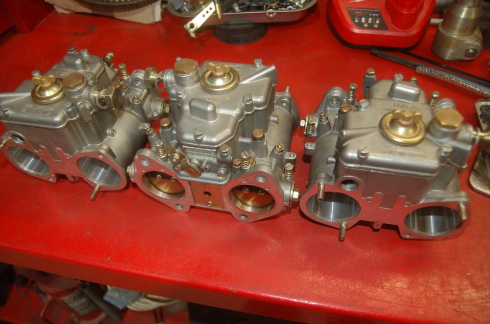

Champ54 10 Posted February 13 Share Posted February 13 Hi Everyone, Has anyone here had any first hand experience with the Chinese Knock Off Weber 45 DCOE carbs. I would like to hear from someone who has them fitted to a 260Z L28 engine. Preferably anyone who has them running well. I have a set on my L28 but they will not idle correctly. This is a fully reconditioned L28 with a 60 thou overbore. Standard cam, reconditioned N42 standard head head and block. Flat top pistons. All new timing chain, gears, guides, and tensioner. Set on position 1. 1. I have checked and rechecked the timing several times and it is absolutely correct. Currently set at 12 degrees advance. 2. Checked and rechecked the valve clearances and they are absolutely correct as per the book. 3. New points correctly set. New condenser. 4. Mixture set using a Colourtune spark Plug (nice blue flames in the chamber) 5. Re-Jetted the idle jets from 55F8 to 50F8. Made slight improvement but still wont idle below 1850 rpm. This is with the butterflies fully closed. 6.Some backfiring through the carbys. Re-jeting improved this but not fully sorted. 7. Engine starts dieseling when ignition switched off. 8. Fuel pump is Carter P4070. Fuel Regulator set at 2.5 psi. Any more and the carbs flood. I've tried to check the actual pressure but it will not read on the 0-15 psi gauge. Is running a fuel return line to the tank. 9. Float levels are set at 12mm. Checked and rechecked. If anyone can suggest what else I can try short of chucking the JASF Weber knock offs and fitting genuine Webers help would be greatly appreciated. Best Regardsw, Champ 54 Quote Link to post Share on other sites

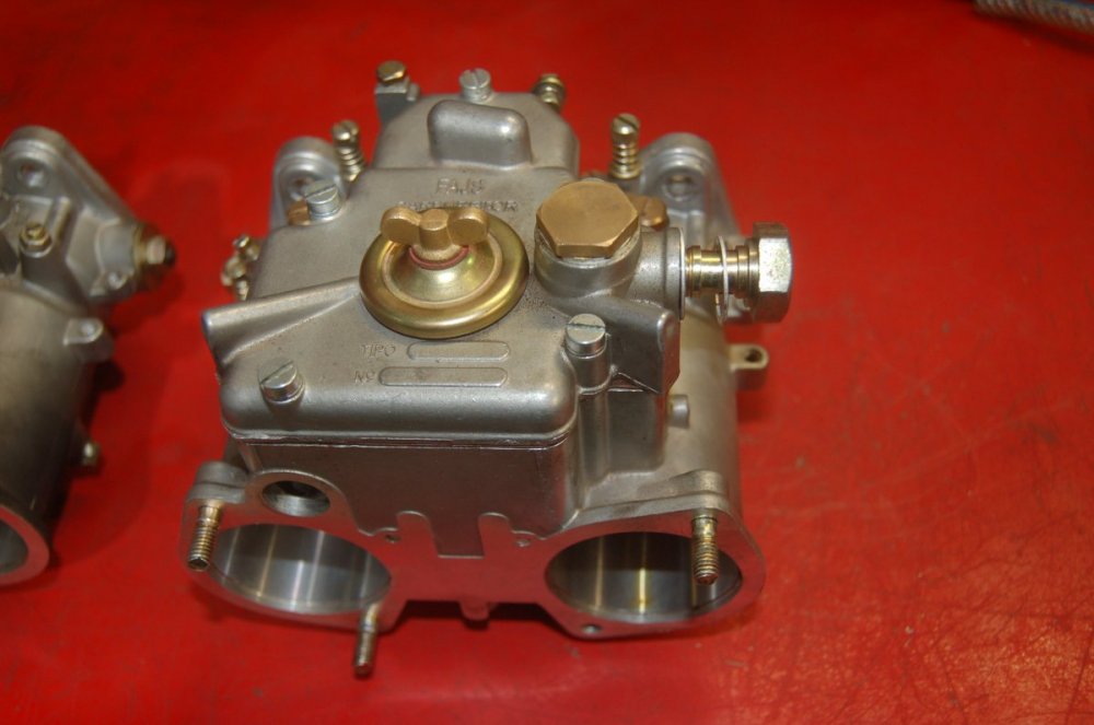

Champ54 10 Posted Sunday at 07:29 AM Author Share Posted Sunday at 07:29 AM Hi everyone. Thanks for all the suggestions. I finally bit the bullet and bought 3 new 40 DCOE Genuine Webers and they work just great. Got them tuned in very easily. Also I may have discovered some of the problems with the JASF junk. 1. the throttle stops were very poorly made and required slight modification to get the butterflies to close fully. 2. these carbs have 5 progression holes and when the butterflies are fully closed 1 progression hole is still fully exposed. I didn't try plugging it up but that possibly would have helped.With the poorly made throttle stops 1 1/2 progression holes are exposed. 3. I think the 45mm with 36mm chokes may be a bit large for my basically standard L28 4. In one carb the throttle pump jet in one side was not working. Switched it to the other side where it worked so the blockagewas not in the jet but somewhere else in the carb possibly the casting.I didn't investigate further. Thanks again for everyones tips. The L28 is now purring like a kitten. gav240z and AndBir 2 Quote Link to post Share on other sites
Administrators gav240z 2,554 Posted 17 hours ago Administrators Share Posted 17 hours ago Any photos of the knock off ones? Any way to tell genuine from Chinese copies? Quote Link to post Share on other sites
