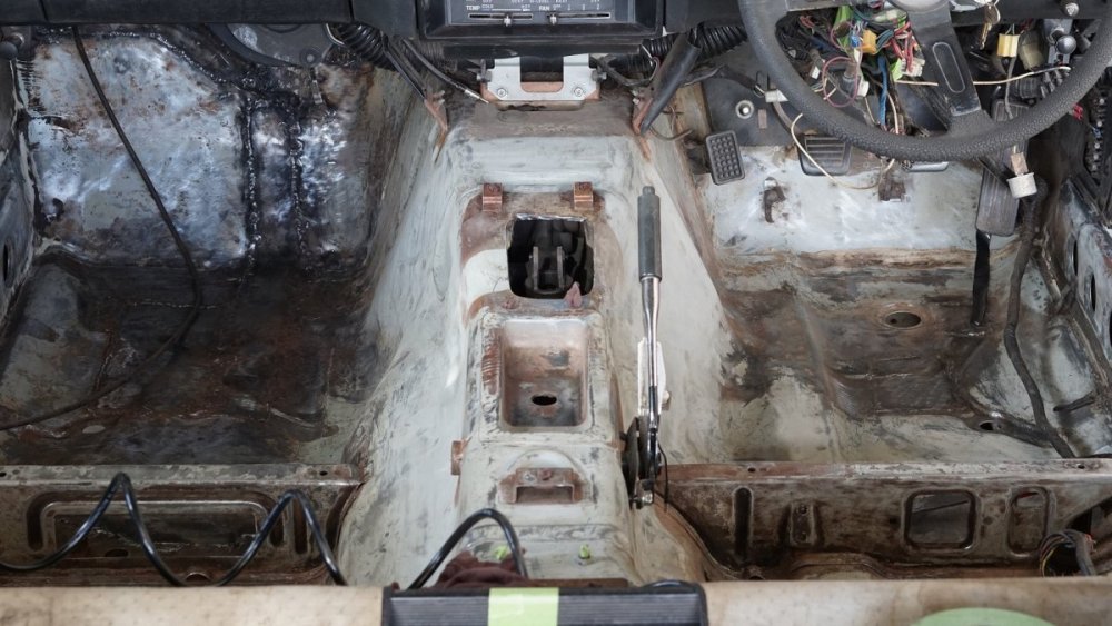

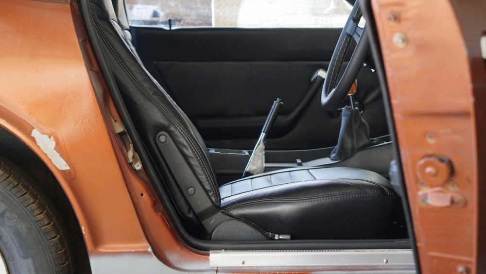

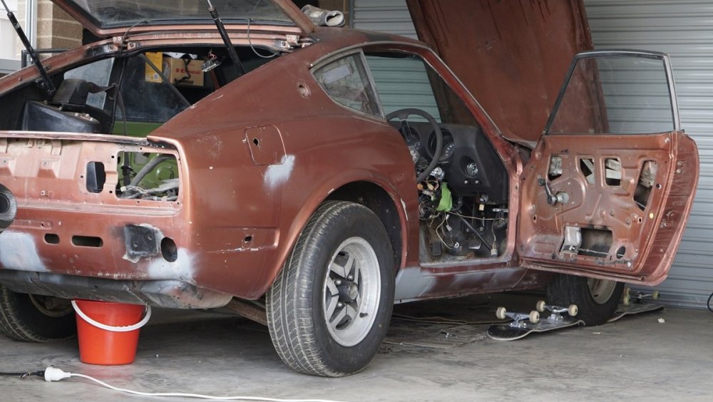

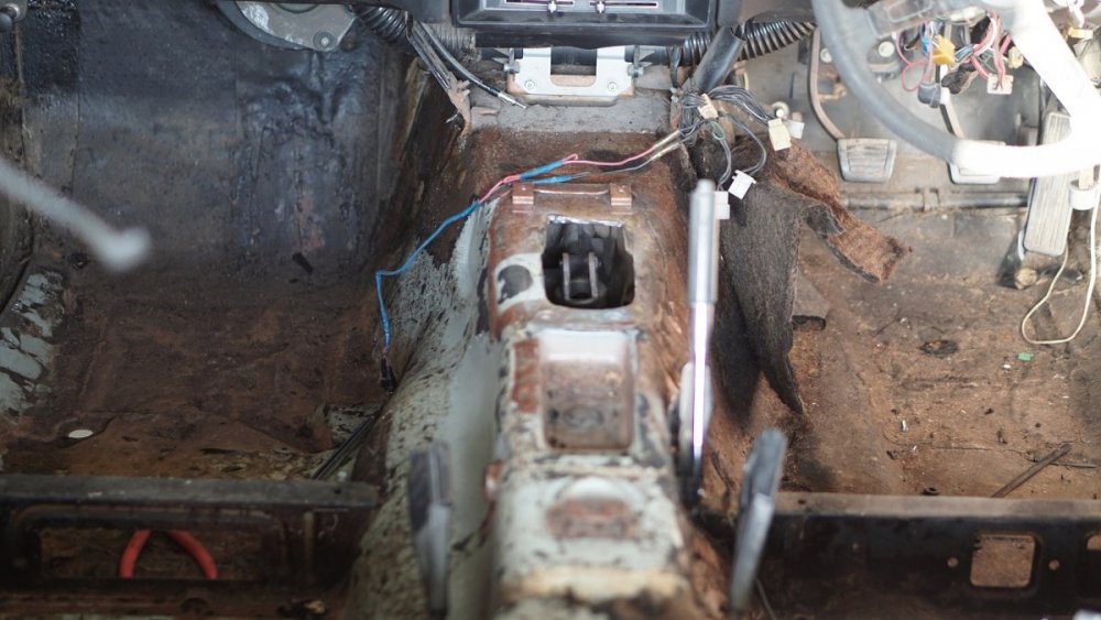

I have however managed to get a bit done. For better or worse I've sanded and painted the tunnel and floor pans in POR15, fixed up the dash and re-upholstered the seats. I had a local fix up the door cards but they ended up disappointing a fair bit, but will get the job done for now. I also changed the headers and installed the rest of the exhaust system, but this will need to be adjusted by a professional in the future as it has some pretty unpleasant notes I think are from it not being fitted and held in place well enough. I also cleaned up / painted the rear tail light housings, and just figured out how to get nearly all of the indicators and lights working as they should be. With the help of co-workers the car slowly fires up now when the battery is well-charged, but I've hit a few roadblocks which will need a seperate topic on the electrical page haha.

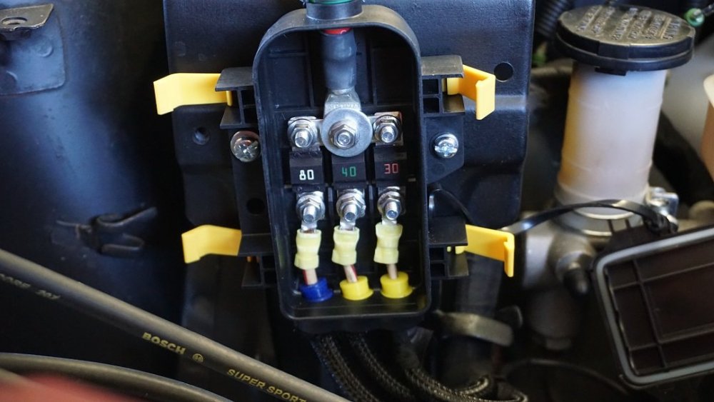

-cleaned up the fusible link setup, all seems to be 'working' the same after the change

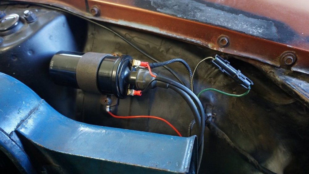

-cleaned up the wires around the ignition coil - I've got an E12-80 ignition module style distributor and had to do some re-wiring to get the tacho to work.
I let the car idle for at least 20 mins this morning, planning to check ignition timing if I could get it to operating temp, and then tune the carbs. Took the video, but then when it started to warm up it started to stutter and slowly die so I switched it off. It would start a little after this and run if I hit the accelerator, but eventually it just wouldn't even start. I haven't really let it idle for long periods before so I don't know whether this is because of something I've done recently or not. It may have been the battery dying because I removed the jumped wires at one point, so perhaps the wiring circuit wasn't charging the battery (complete guess, I just followed the steps right at the bottom of this guide (http://atlanticz.ca/zclub/techtips/alternatorswap/index.html).

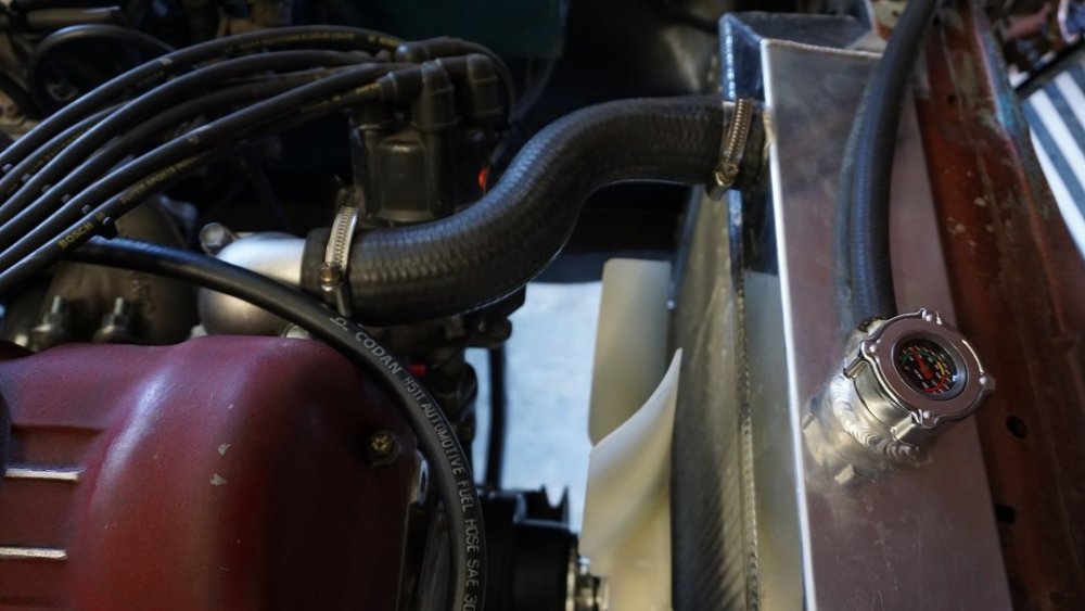

The coolant hose between the front top of the engine and the top of the radiator doesn't heat up - the hoses going to and from the cabin do and the valve cover gets hot. The top of the radiator is cold and the radiator cap gauge never increases since changing to the jiggler thermostat - before with the jiggler-free thermostat it got to 60ish degrees after idling for more than half an hour, but never actually to the 80 something degree operating temp as far as I could tell.
So - I can charge the battery and install the correct diode to complete the wiring in place of the voltage regulator, and this may fix the car dying. If it does then I'll check the ignition timing and attempt to tune the carbs. I know it's hard to tell - but should I be checking anything else first with all that smoke coming out of the exhaust? There's a slow oil leak from the oil pan gasket in a few spots, but I don't think that'd be the culprit?

the fact that the radiator top tank is not getting hot after 5 min let alone 20 is a serious problem, did you put the thermostat in the right way up? maybe your engine is seizing not over fueling I wouldn't run it till you sort this out.... take out thermostat and refit the cover, remove the bottom hose and reverse flush the engine through the bottom hose, water should run out the water pump.. HTH

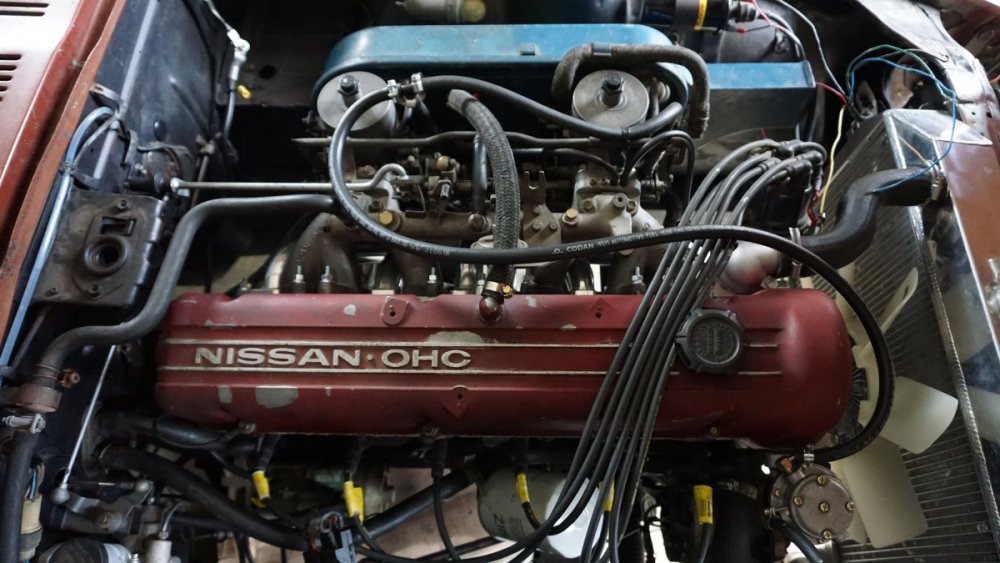

I suggest you check the hard fuel line set attached to the engine, that it's all clear and not rusty, and make sure the return line restrictor portion is not blocked.
I only have rubber fuel line from the mechanical pump attached to the engine (also don't have an electronic pump at the rear), there's a pic I think on my first post. Still, I was worried the return line being a bit narrower than the send might not be helping?

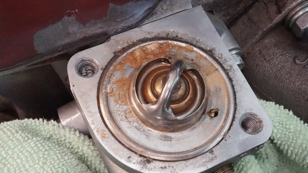

Originally when I got the car there was no thermostat and it ran like this the first time it was fired up. The old housing was rusty, so I replaced the housing and cover and put in a thermostat - again I had no idea what I was doing so I made sure to look up the right way to put it in. I would've swore it was the right up, but I've just taken the cover off for peace of mind. Please tell me I haven't managed to somehow put it in upside down thinking it's the right way up? The thermostat I swapped it out with a few weeks ago was more or less the same, just with a 2mm-ish hole where the jiggler is on this one. And more worryingly why do I now have all this nightmarish gunk that wasn't there a few weeks ago?

Who installed the alloy radiator and how long ago? I'm thinking it must be well and truly clogged up with crap from the motor and maybe some kind of antifreeze additive that is turning to sludge, if the heated water is unable to travel up to the top tank. Both motor and radiator needs a thorough clean out. Back flushing with the old garden hose might not achieve much despite what some people say but better than nothing. If the radiator is well clogged then take it to a shop to be properly cleaned out. You'll just have to do the best you can in situ with the motor, water pump and hoses.

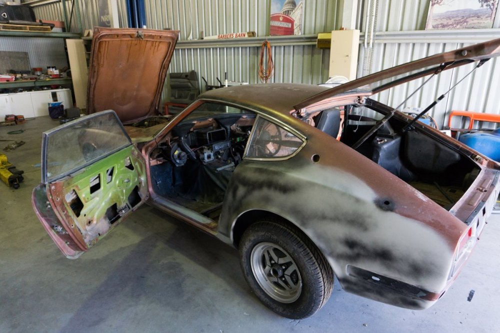

FWIW. Have you noticed that your two door shells are different? I'd say the LH door is off a 240Z, I'm going by the cut-outs and shapings on the inner faces. Be aware that the window winders, positioning and geometry of same, are different, and of course the trim and hardware fixing points are different between 240Z, early 260Z and later 260Z. Swapping doors across the various cars is a whole separate discussion in itself.

the engine and radiator will need a good flush, gunk could be oil contamination but more likely it has had an anti freeze or stop leak added to the coolant which has congealed in the system, either way fix this first and worry about the carbies later, the jiggle valve faces the front of the housing, towards the radiator, it is in the right way.

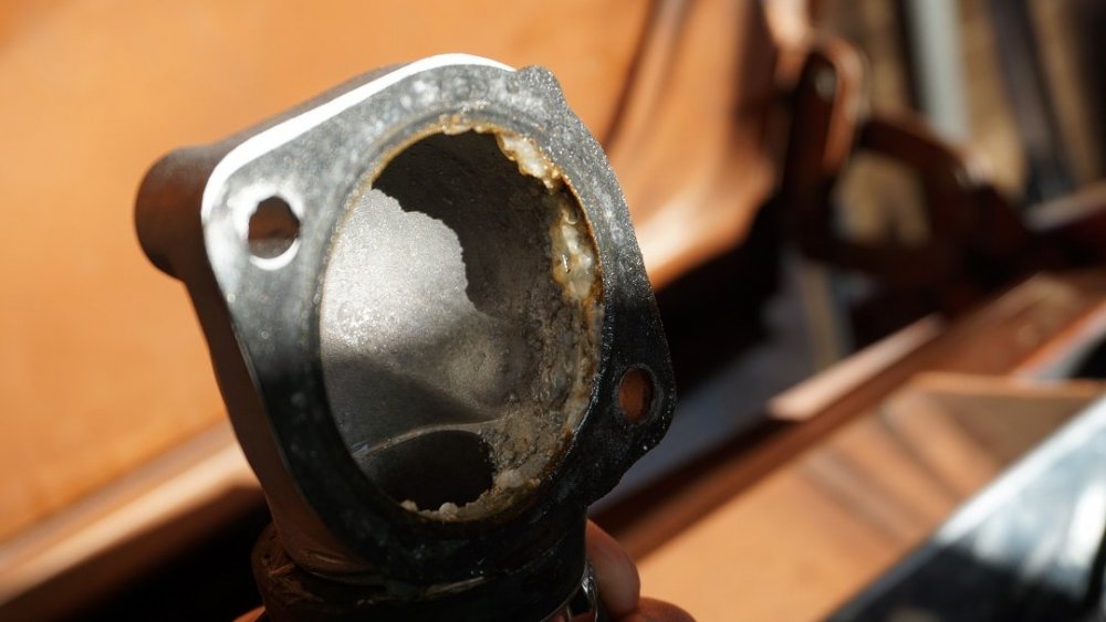

It was a new eBay piece I installed maybe a year to a year and a half ago? I had no radiator before that, and I myself have never put anything other than garden tap water through it. I even flushed the radiator a few weeks ago when I had it out to replace those clutch fan grub screws. I've known the whole system needs a proper flush but figured I'd do one after it's rego'ed - then I could add in a proper cleaner and drive it around to cycle the cleaner instead of just push it through once.

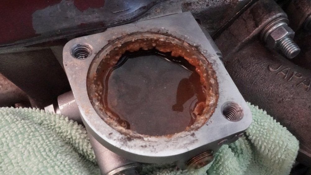

So I've just reverse flushed the engine as recommended. Put the thermostat cover back on with no thermostat inside, disconnected the top radiator hose at the radiator side, disconnected the bottom radiator hose at the radiator side, and then used the garden hose with one of those Bunnings trigger handles to seal it against the top hose and push water through. Did the same with the radiator, only connected the top hose back to the radiator and pushed water through that way. Both now run completely clear water flushes.
Both engine and radiator flushes pushed out maybe 6-8 4L buckets of rusty water. Ididn't see any gunk or debris come out of the engine at all, and couldn't spot any leaks anywhere. The water seemed to flow through as it should, I think? No pressure build up up top, just all came out through the bottom hose as far as I can tell.
The radiator was more or less the same, but with a few tiny pieces of film, almost? You can barely see them in the pic.
What do you guys reckon I should try next? I've confirmed the thermostat works with boiling water again (which I did as well before installing it), which is why I'm so confused about the whole thing. If the thermostat works, and the engine heats up, why isn't the top radiator hose heating up radiator side after the car's been idling for half an hour? Should I idle it with no thermostat and then kill the engine if I can confirm the top of the radiator heats up, just to confirm water circulates the whole system properly? Or switch back to the thermostat with no jiggler pin?
I love that you spotted this straight away. I didn't realise until I got the door cards back from the upholsterer (after a year of waiting) and went to put all the fittings on. It just never crossed my mind that someone would swap out a door with a different year model door. I was pretty disappointed with the door cards though, so I just installed wellnuts in the wrong door to get all the fittings on. Kinda dodgy, but for now I have functioning arm rests and occasionally functioning locks etc. When I can afford to source the right door and buy respectable door cards I will though for sure!

Well as always it's the problem of finding a matching door to the damaged or rusted out one, spare S30 2-seater doors aren't thick on the ground. As I understand it there were at least 5 significant shell variations across the various markets the cars were sold in.
However, there are now repro doors available which is a relief to S30 restorers no doubt. I see that they are advertised on eBay as 240Z/260Z. I just don't know how that works when the mechanism is specific and layout is different on each.
