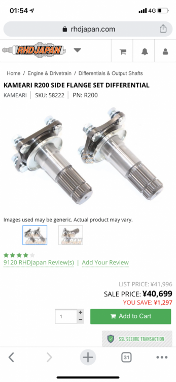

So these are the kameari Subaru R180 diff to half shaft adapters. They are really pretty.... 8) so the splines go into the Subaru diff and flanges onto stock halfshafts. Chuck your stock z diff front face flange and diff backplate onto the Subaru R180 and hey presto 240z LSD for under 2k!
My z man has to check the internals on  the Subaru diff to make sure everything’s healthy and then it’s a done deal!

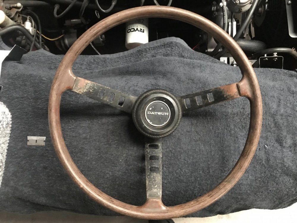

My car never came with a oem steering wheel, so I was considering the jdm comp steering wheels from MSA. But after a poor review of them  by Peter T and my z man here in perth I decided to see if I could find a stock one. Looked online and most are around the 300 to 500 USD dollar mark . Quite pricey....especially with shipping.
asked my z man if he had any available and he did! It’s rough, but it’s mine! And it’s a much more reasonable price than ones from the states.
A little resto and it should come up nice!
Edited by 240ZBUILTBYME

Good choice Ryan.
That will look great with some work. The horn pad even look in OK condition. I restored my wheel and I'm very happy with it. The steering can be heavy with these cars so a big wheel helps. I went for the polished spoke look rather than the black.
Jeff

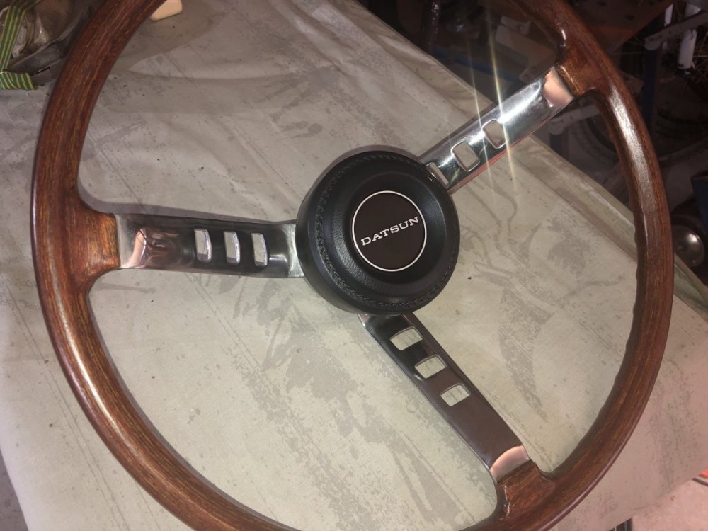

1 hour ago, CBR Jeff said:
Polished FYI
That come up nice Jeff! I’ve been through most of your build thread but must finish going through it, lots of golden nuggets of info I’m sure!
The silver black wood combo is very nice, what product did you use for the wood? I like the tint, I find some people use a product that has too much red in it. I don’t know what the stock color is like
Did you get a new horn pad or just repaint or clean up the original?
Ryan
