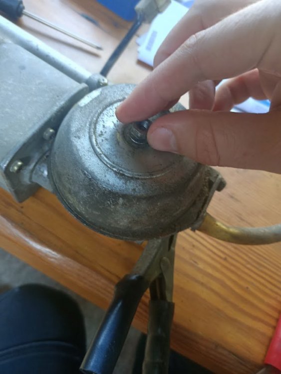

Step 1.
Remove the nut and (1) washer.

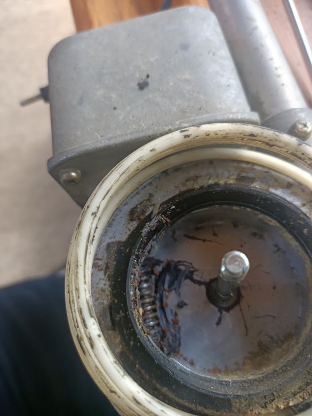

Step 2. This will reveal the winding assembly, which has 1 washer underneath also. Remove the washers and set them aside.

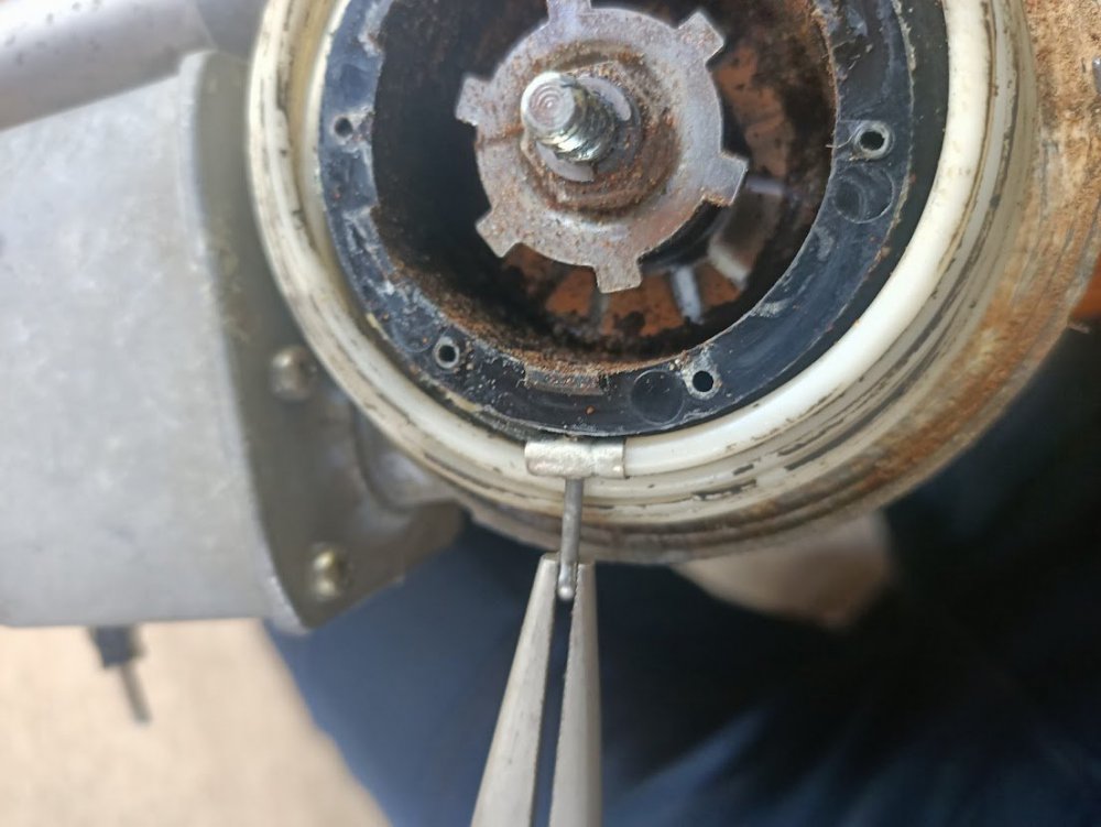

Step 3.

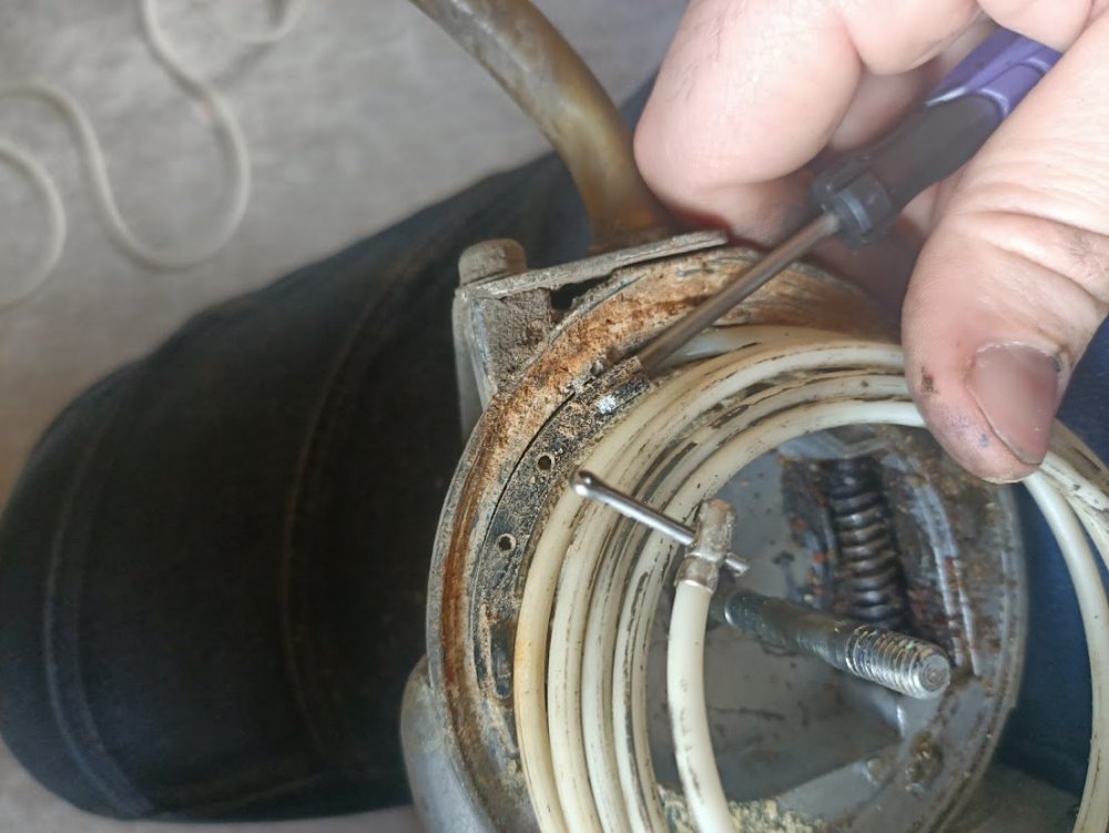

You can see a pin that holds the plastic/nylon chord in place to the assembly. You'll need pliers to straighten them out and be able to remove it. (Similar to castle nuts on ball joints).

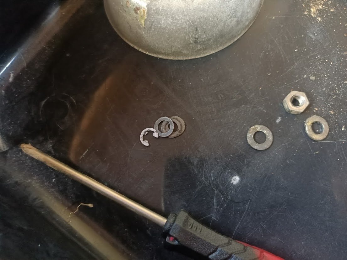

Step 4.

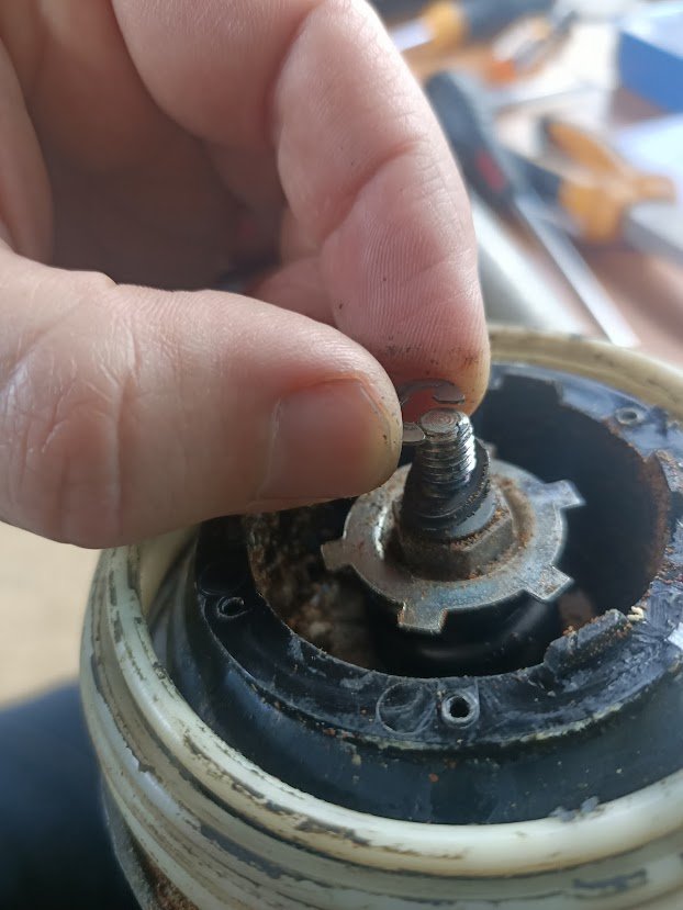

There is an e-clip that is holding on the assembly, a small flat head screw driver should be able to pry it off. There is 3 washers underneath that. Set them aside.

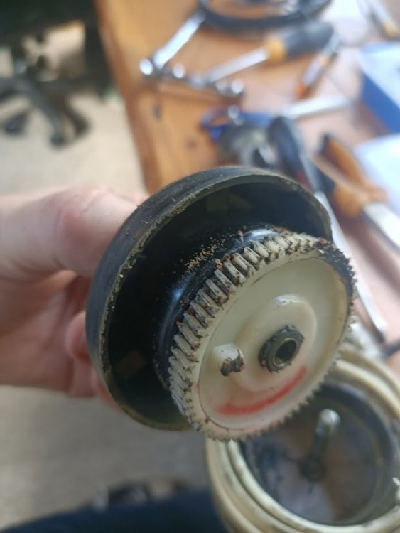

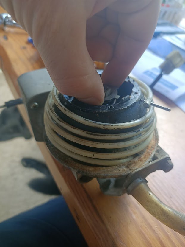

Step 5. You should now be able to move the winder assembly.

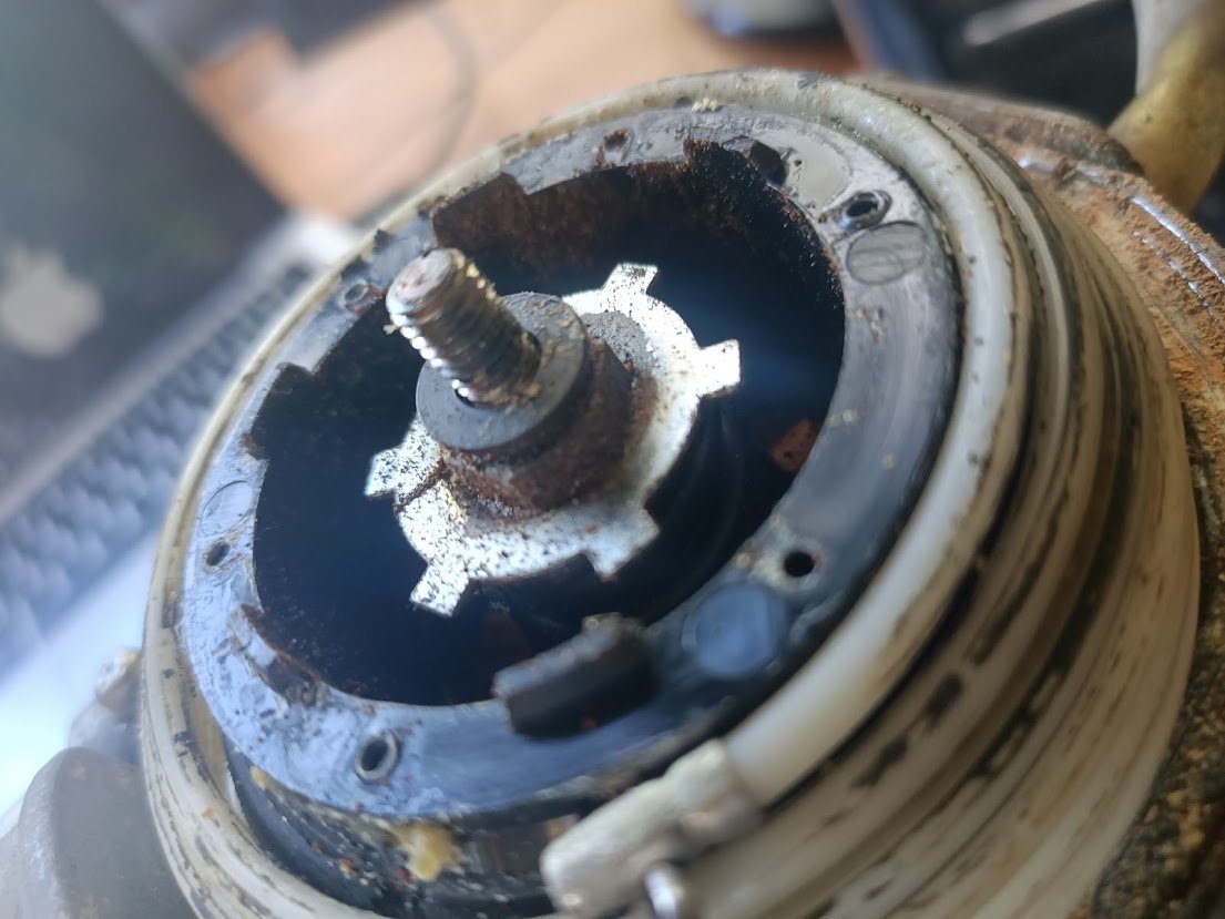

There is a black dust cover/plastic shield underneath. I believe there was 1 screw I needed to remove but it's very fragile and was already a little broken. So be very careful removing it.
Step 6.
Underneath the assembly you can see the gear that is turned which in turn moves the nylon string and pushes the antenna up and out.

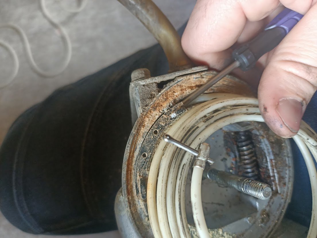

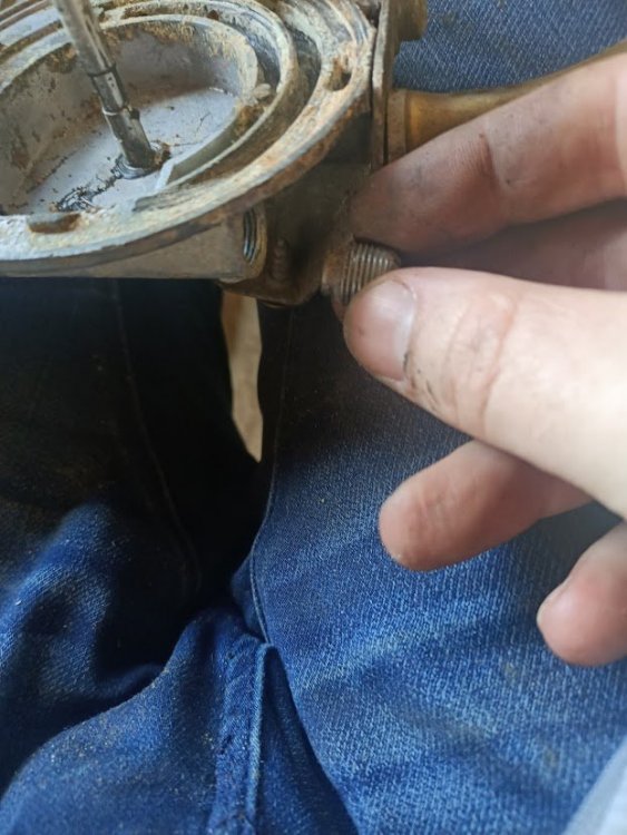

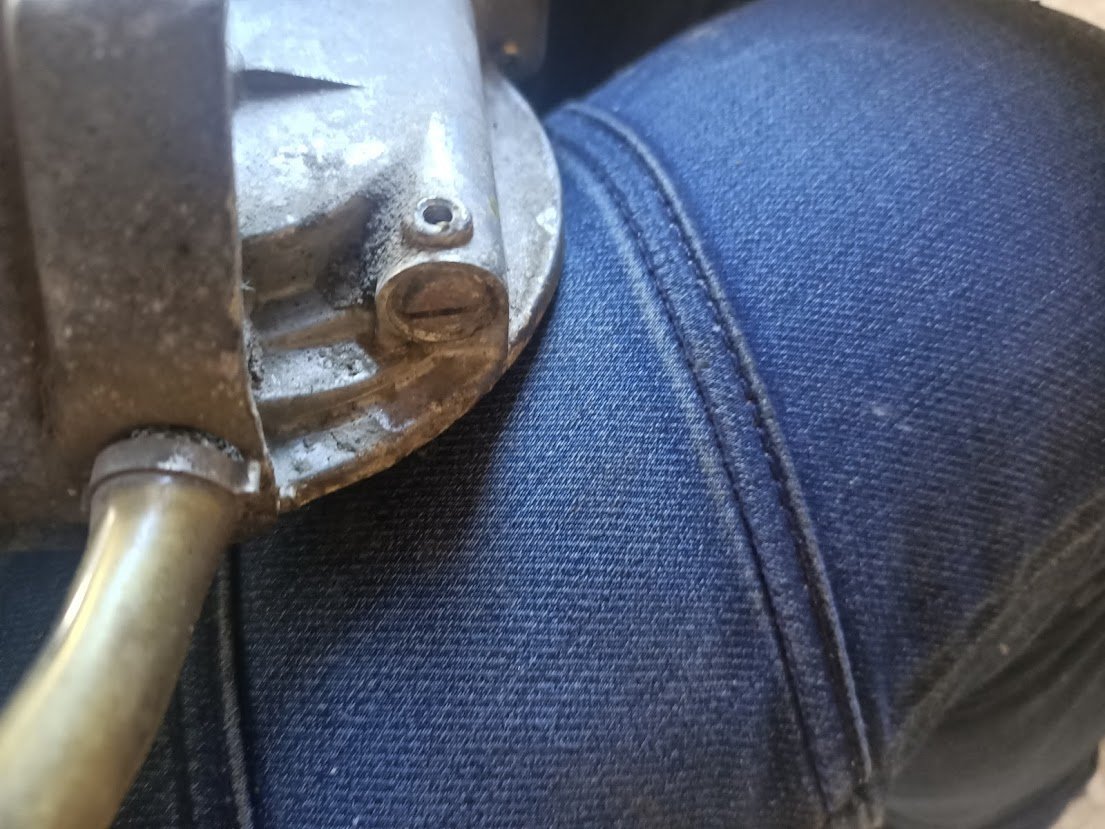

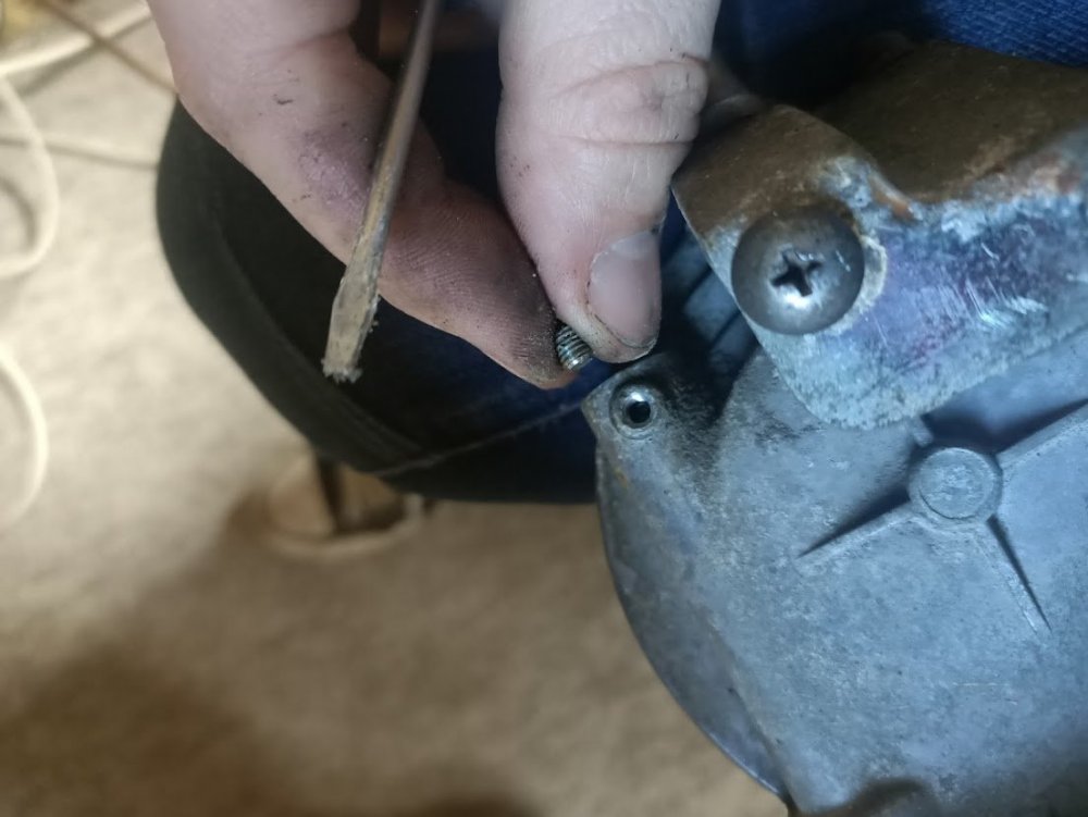

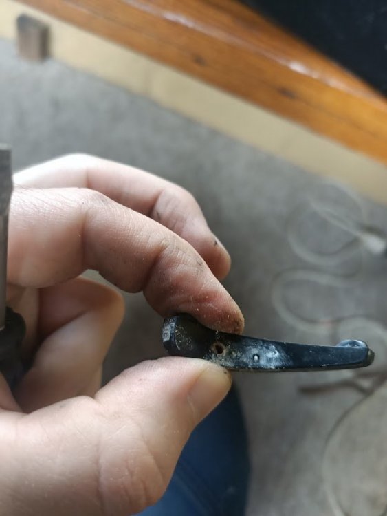

There is a locking screw on the outside body, this holds in the black plastic retainer that the nylon string runs underneath of.

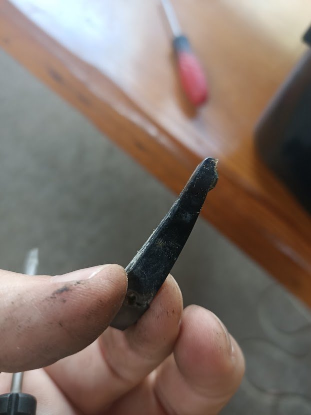

Step 8. I knew this would happen, I tried to gently pry up the black plastic bit, but it broke.. I think the amount of gunk / rust and rubbish in the area had seized it into the body. You might try WD40 or another penetrating lube spray if you give yours a go and may be able to save it from being broken.
Step 9.
It broke right on the screw hole line.
I should be able to glue it back together for reassembly..

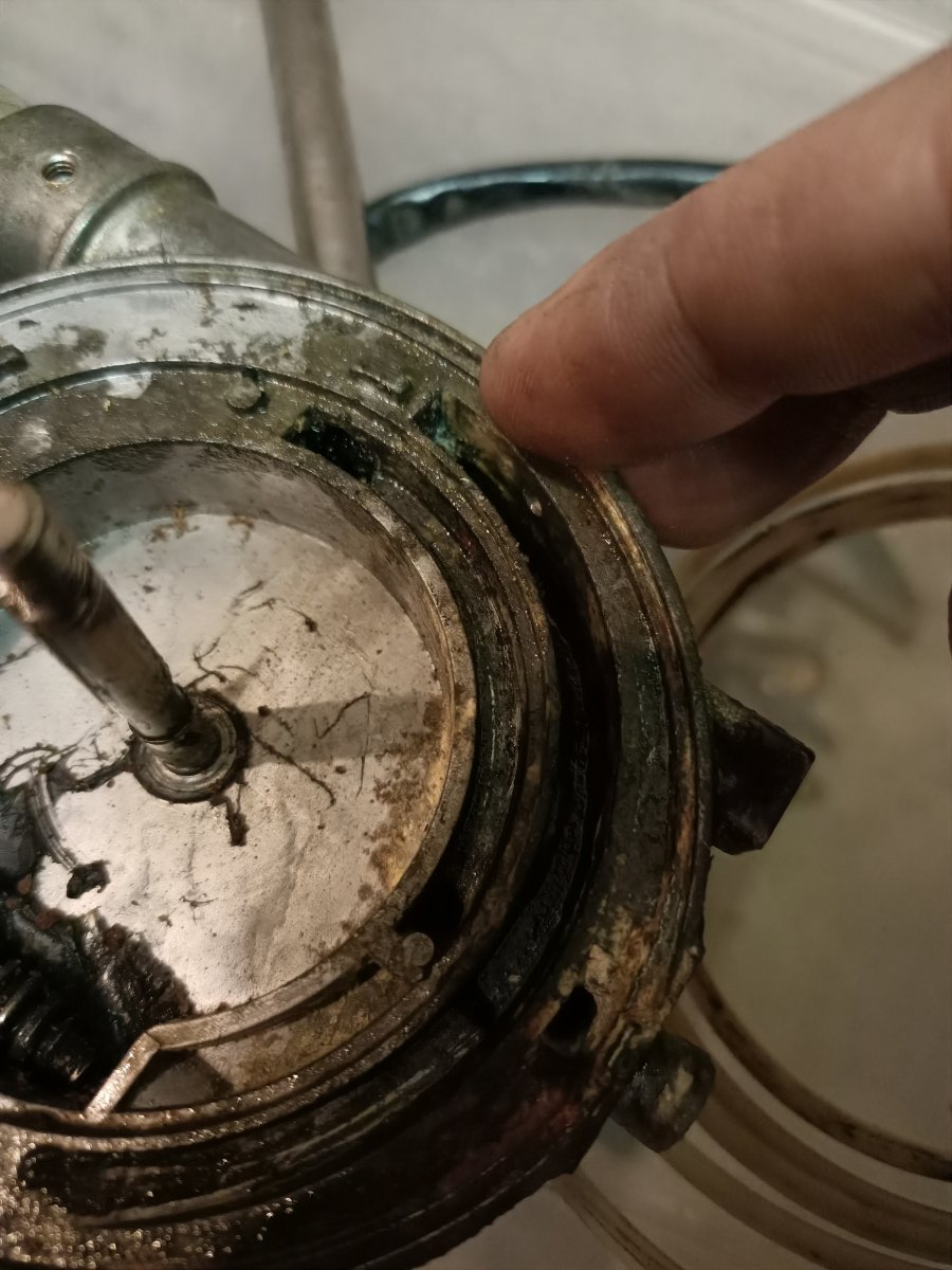

Step 10.

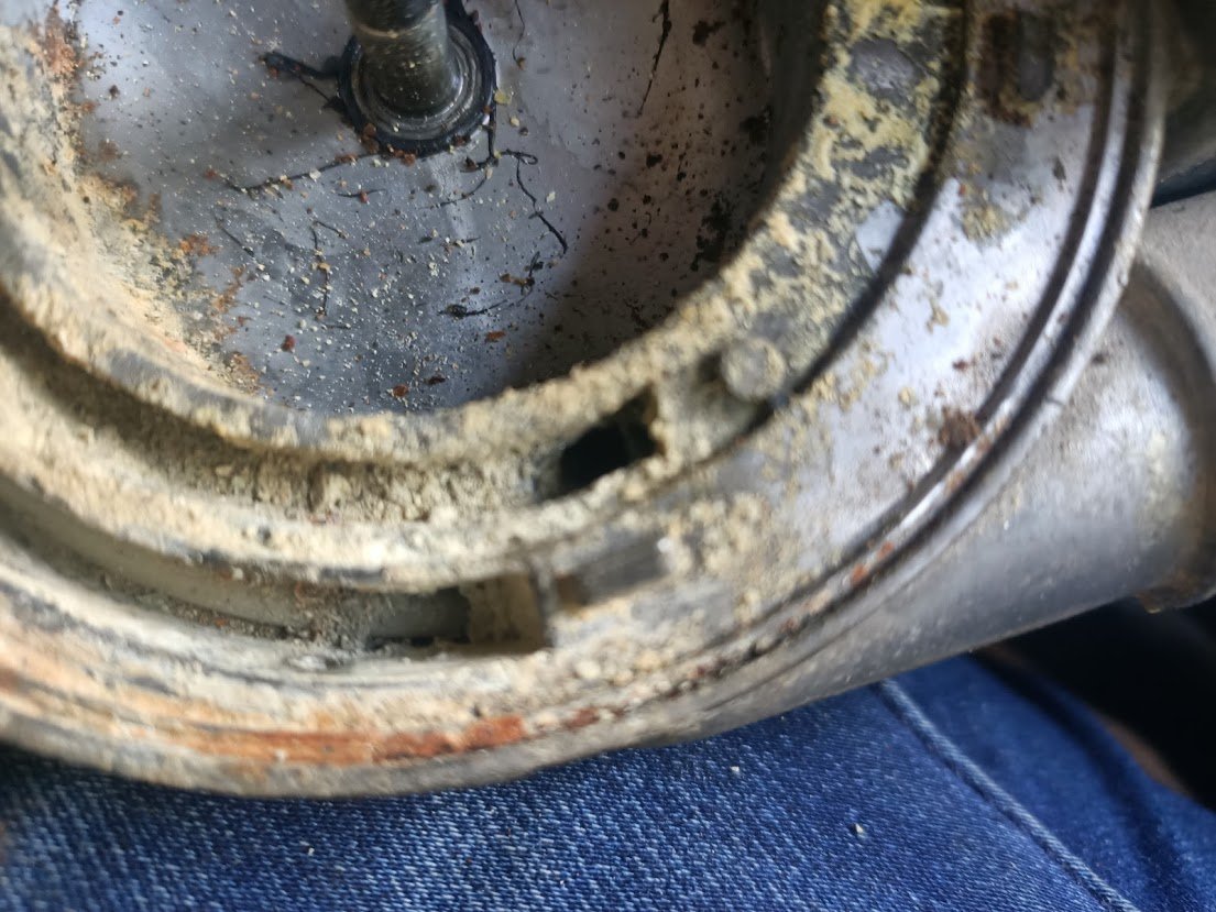

Look at all this gunk..this is causing the nylon string to bind up and stop moving..

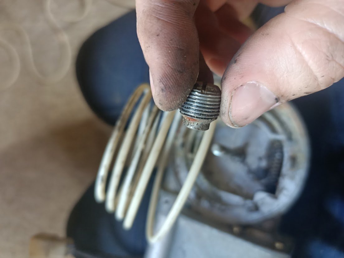

Step 12. At the bottom of the housing is a retaining / locking nut.
This allows you to remove the screw at the base of the motor shaft that spins.

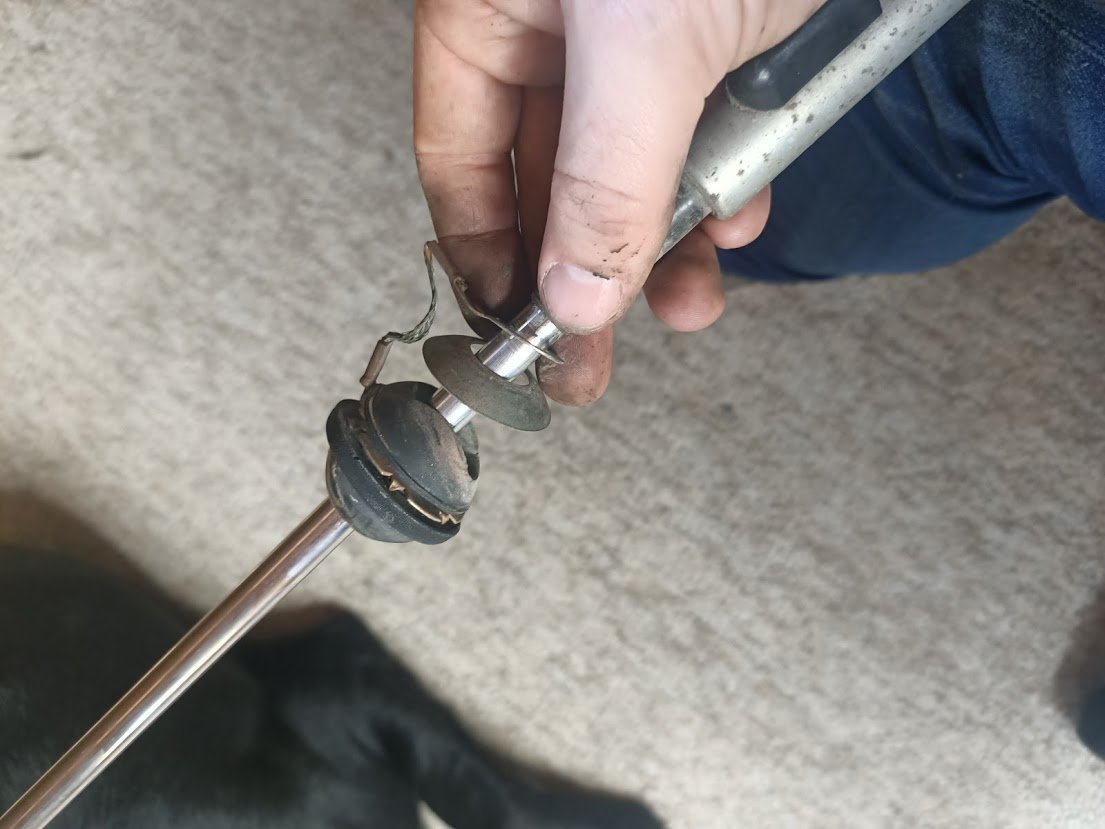

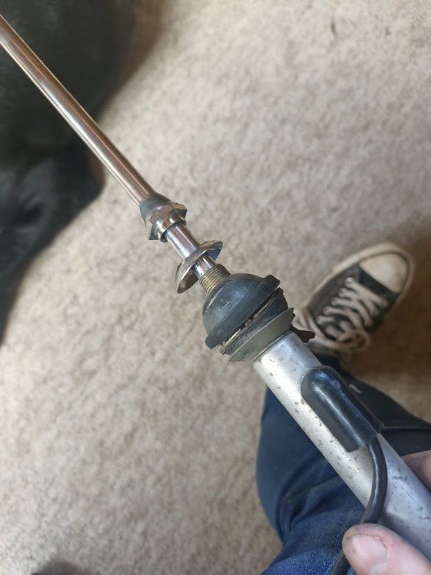

Step 13. You can remove the nut at the top of the mast, keep track of the order of the rubber/finisher/trim bits. These are now being thankfully reproduced by www.240zrubberparts.com

Step 14. I still can't separate the housing and mast assembly, they seem to have binded together.
The other problem is I can extend the antenna itself, but only the top and bottom portions. The middle sections won't extend and seems to have rusted/sized up. I don't want to force them apart either. I may try some penetrating spray and a heat gun or torch to free it up. But not sure what's the best way to go without breaking it!

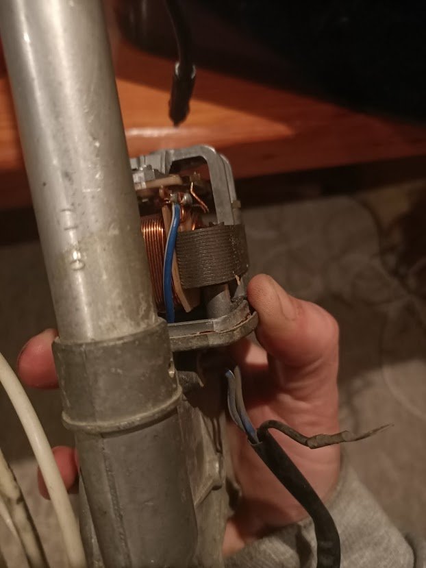

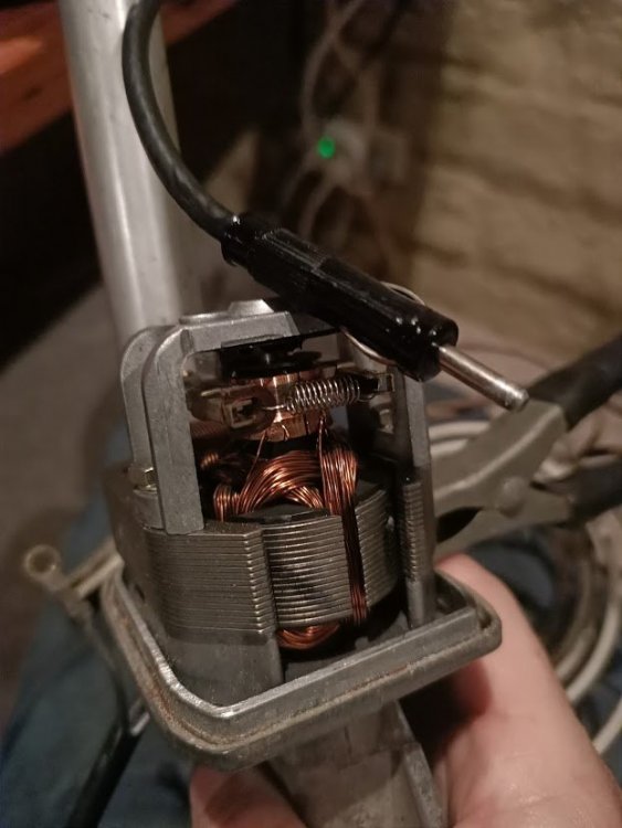

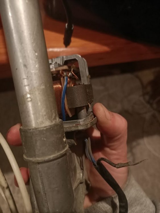

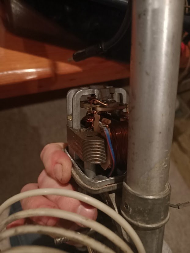

Step 15. The motor assembly itself.

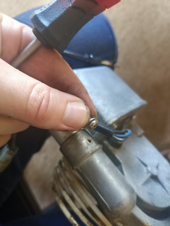

First polarity photos for later reference, since you need to de-solder these points to remove the loom from the housing.

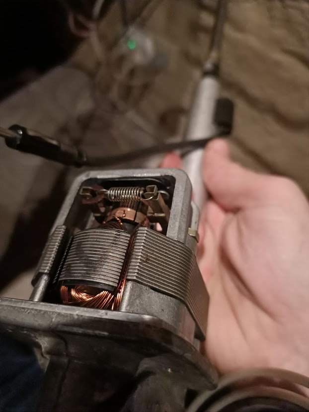

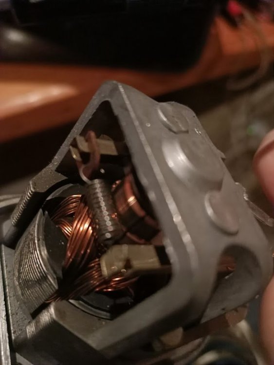

Step 15. Cleaning the motor commutator and brush assembly.
Can you see the black carbon mark on the round cylinderical brass thing? Well I used this lube/spray/cleaner.
Yes I should have put a rag down to prevent spillage on the wooden desk! Don't be like me.
I used q-tips/cotton buds to clean the carbon marks off the motor and you can see how dirty the tips got!
You can push the spring left and right to clean the commutator surface!
I should have taken video before, the motor would turn, but very slowly... and it would go slow, faster, slow, faster..
However after cleaning it up you can see it moves quickly now! Like someone put a rocket up it's dress.

There was so much crud and gunk down the bottom of the assembly/body that it was preventing the nylon / string from moving in the body. So it's no wonder it stopped working.

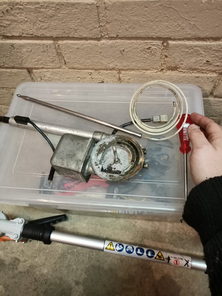

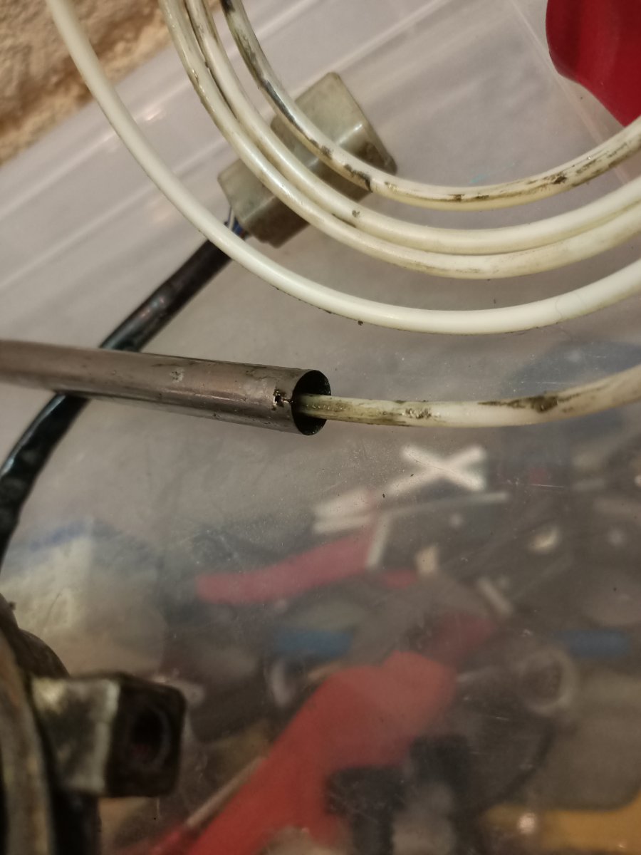

So I managed to get the antenna out.
I sprayed some of this..
Into the channel here.
Where I'm pointing.

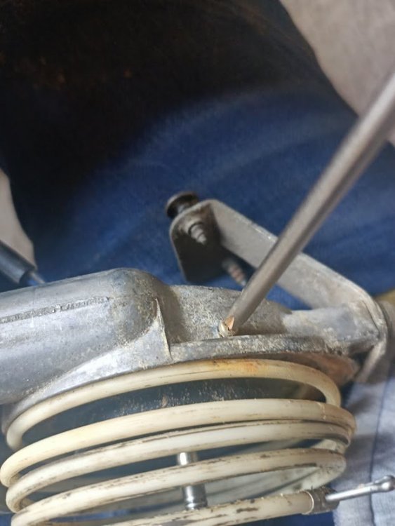

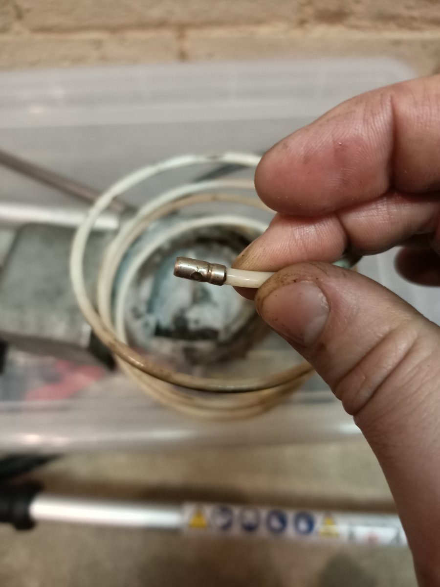

This part was catching so I had to use a screw driver to push it down into the channel and thread it past.

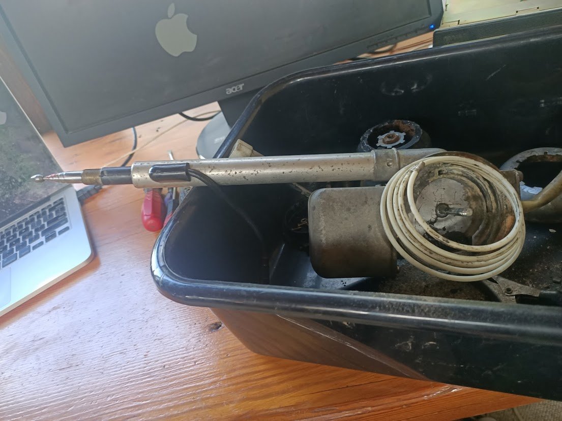

You can see it apart here.

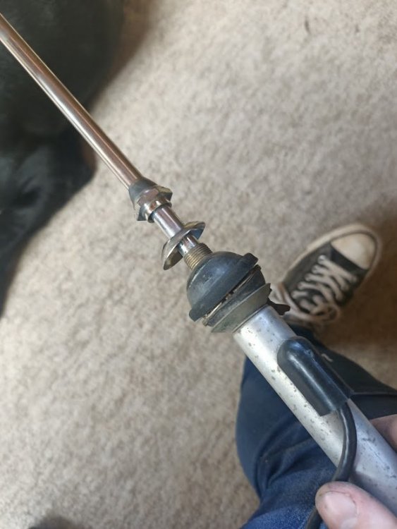

But I couldn't get all antenna extensions to extend. I sprayed a lot of the liquid wrench into the antenna tip and have let it soak. I used a propane torch to lightly heat it up, but still wouldn't budge.
So I may soak it in oil or similar.. but need to be very gentle since these are so easy to snap / break otherwise.
I also cannot yet separate the long antenna mast tube from the body of the assembly. It's like an interference fit. Also tried heat here to no avail yet.
