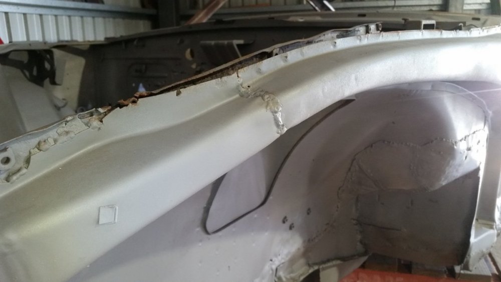

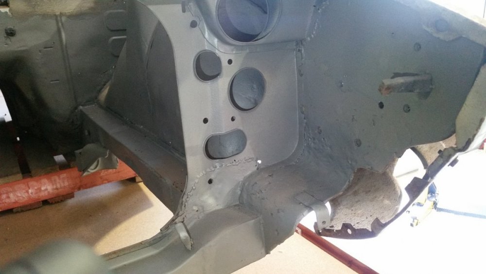

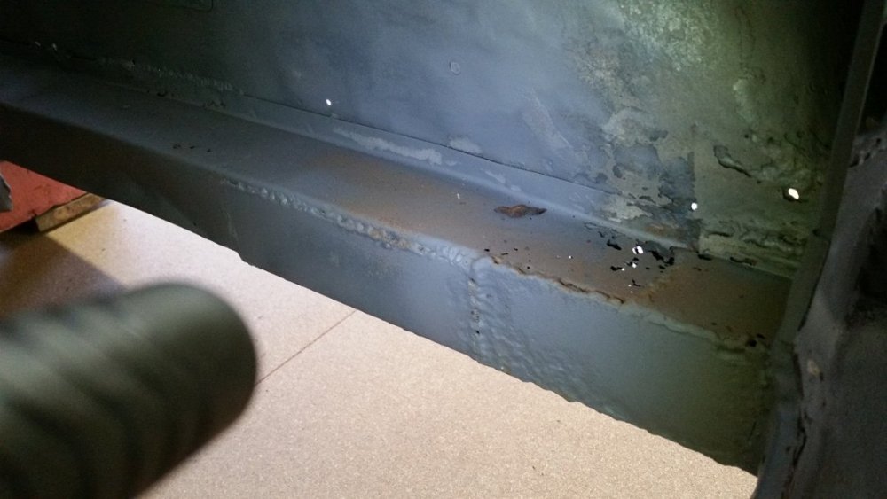

Here's a sample of what we have to tackle..............note the very very poor previous repair work.

I see what you have to deal with. Not that unusual though. What is the rear half of the shell like, given the front has had so many rust repairs?
Got any photos of the 260z front clip you're looking at? In order to compare.

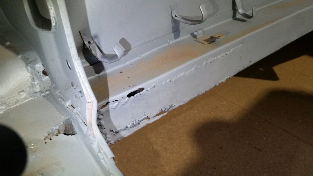

The rear is rough but manageable. Just the usual rusty areas.

Do you think the previous repairs are all rust repairs or are there some crash damage repairs also?

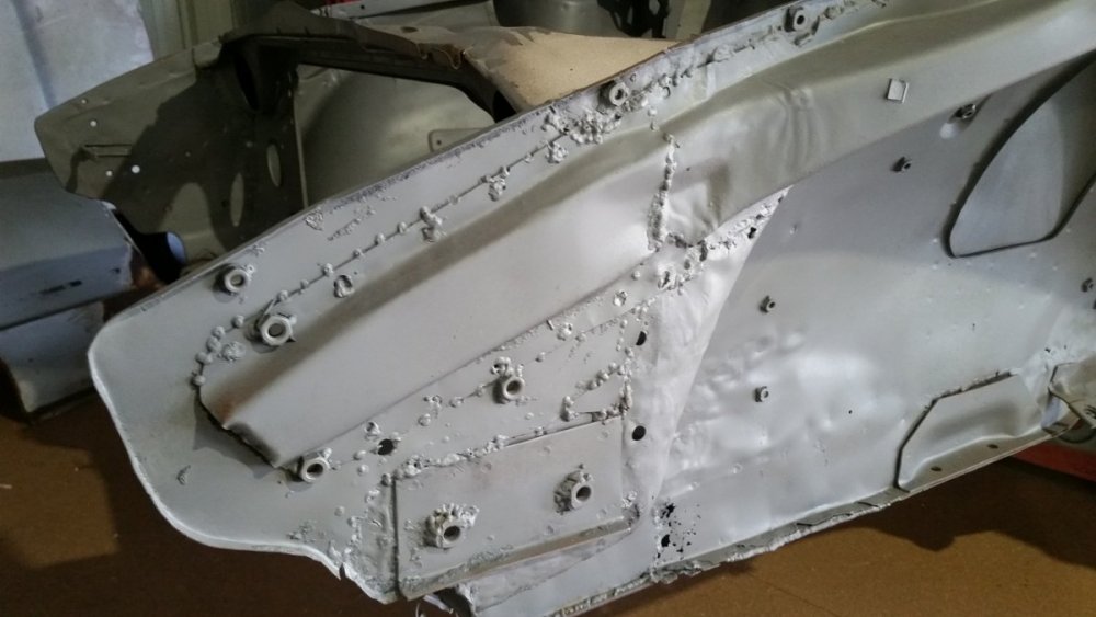

the fella had an interesting technique of welding.
What year is the 240?

It's a big mix of rust repairs and crash repairs, probably all done on the cheap in the eighties or early nineties.
No aussie compliance plate, but build 114

There would be many many hours of work to repair all that mess. If the 260z front clip you're looking at is an early one and fairly good then you'd be better to put that on IMO, quicker and cheaper and a cleaner end result.

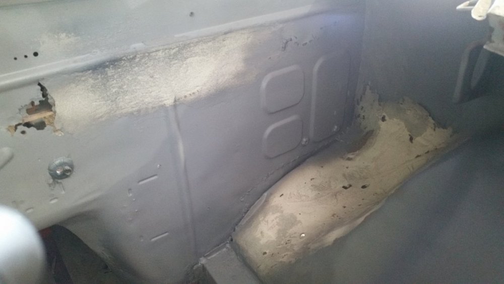

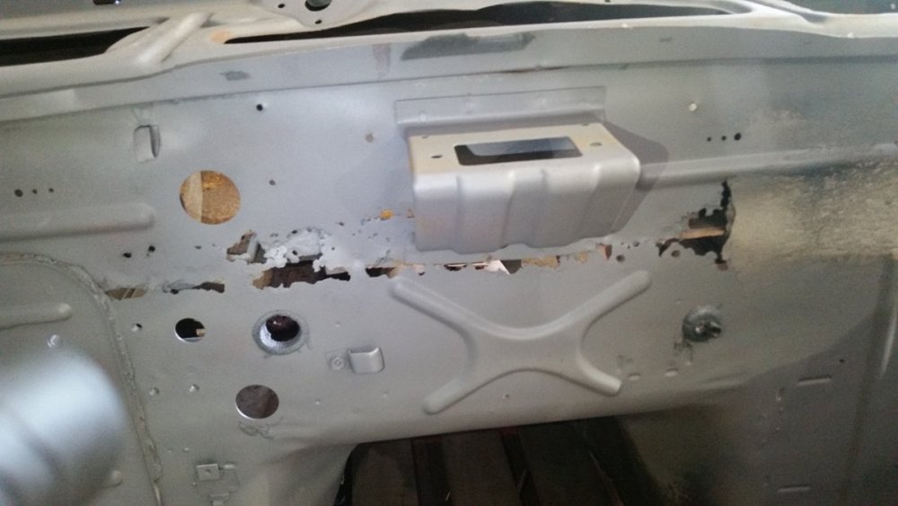

Disappointing that the firewall is so rotted. Why do you need a new roof - rust, or replacing due to a sunroof?
What are the floors like? Rear chassis rails? Hopefully not more of the same.
Interesting to see stitch welds in the RH front corner of the radiator support panel. Why? Has the RH apron section beside it been replaced at some stage?

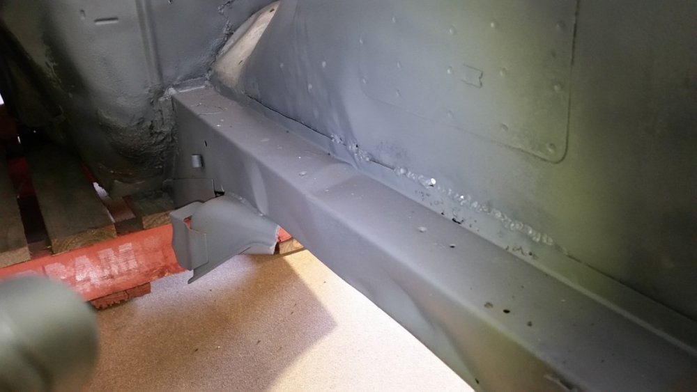

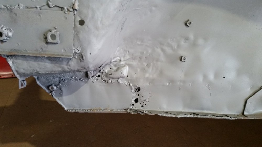

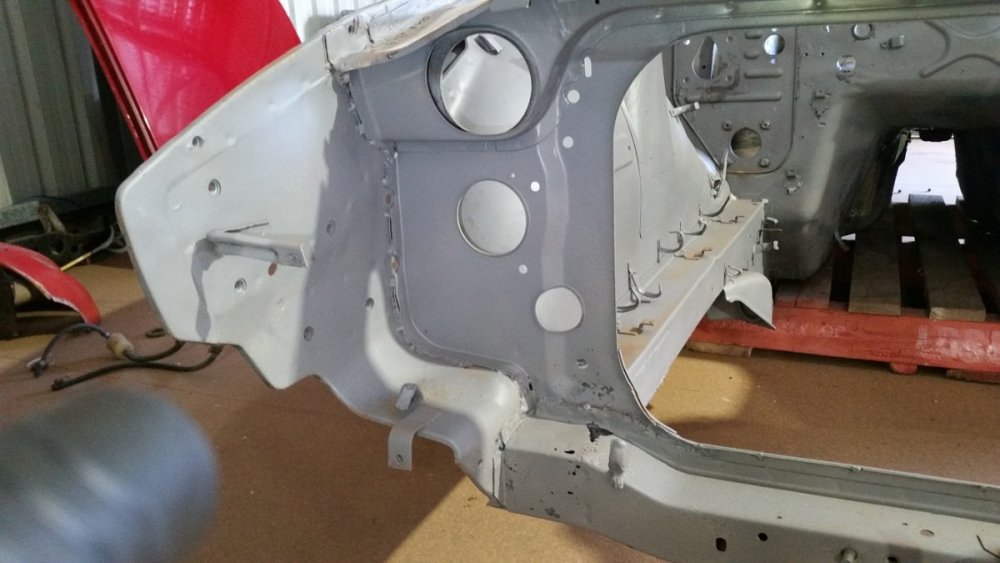

This is the 260 front cut I bought, very clean virtually rust free, just some mild damage to the RHF section.
Heater and air con holes will have to be modified, but please let me know what else you notice that I might have to change.

That's the later 260 style of radiator support (deeper), and various engine bay bracketry. Is there any ID tag still on it to say what year?
So what are you going to have when you're done, a 240 or 260? ;)

No ID tag just chassis number. Will try and make it look as 240 as possible (removing unnecessary brackets)
All the 240 panels will still bolt up right? Guards, grill, bumper brackets etc?
Have yet to sit them side by side for comparison analysis.

Your replacement clip looks to be in pretty good shape, so well done finding that.
The late 260 radiator panel & X-member is quite different to the 240 and early 260, and so a give-away if you use it on a 240 but only the learned would know the difference. But the later 260s like yours didn't have the black flexi ducts in the front corners of the engine bay, so you might want to use the original 240 radiator panel in any case. And the grille fixings and splash pan shape are different too. Best check fit everything you intend to use prior to completing the bodywork and paint.
