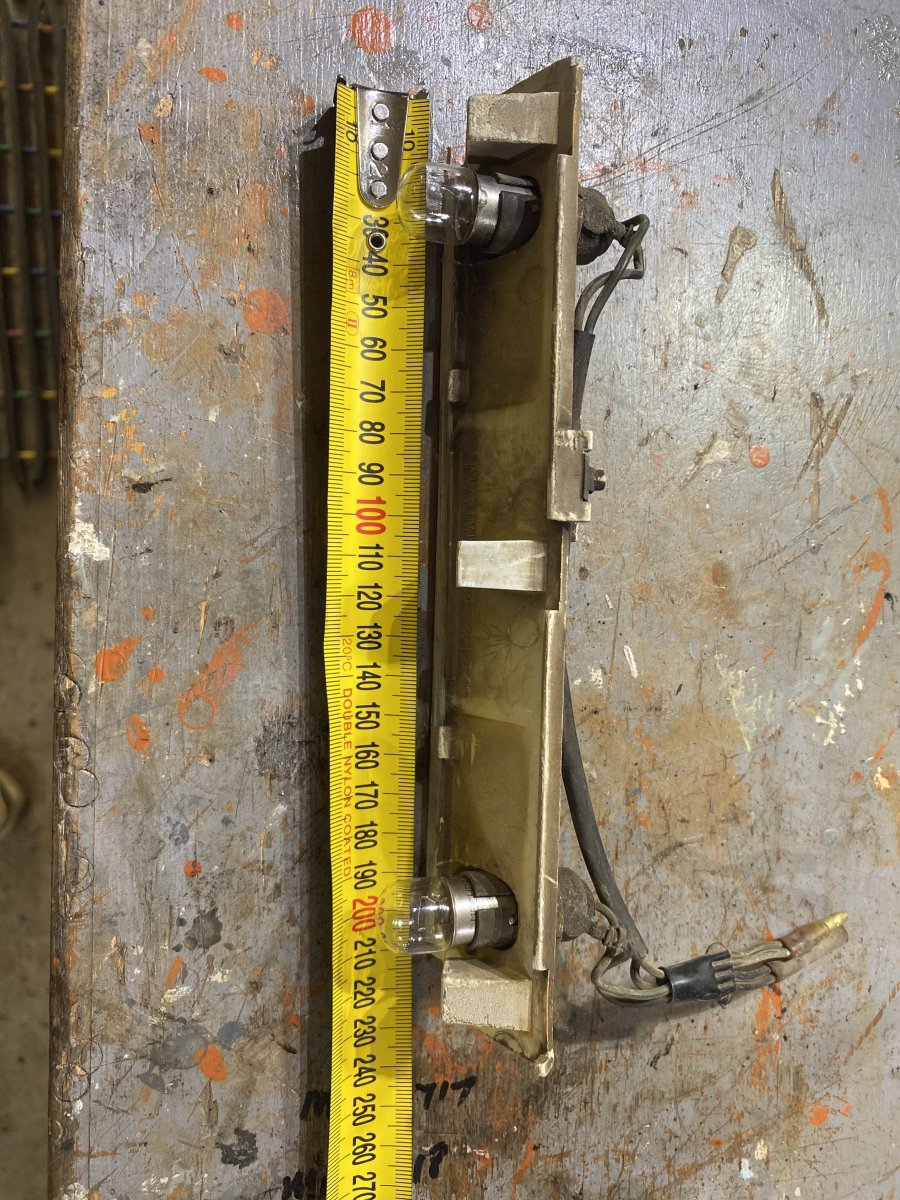

13 hours ago, nat0_240_chevZ said:
Jeff,
the one pictured abd looking to produce is ~270mm long.
Check your dimensions and advise.
Thanks NatO. I don’t have the entire item but what I have (the white section) is ~215 long

That's the one jeff. Cheers for posting pic to confirm.
Ill also look at remaking the gasket to the correct size, as the Nissan ones are >2mm out of size, causing them to crack when stretched over time.
