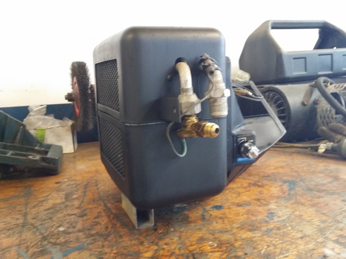

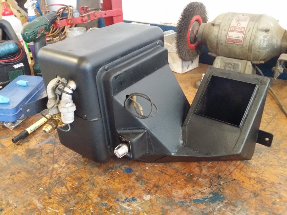

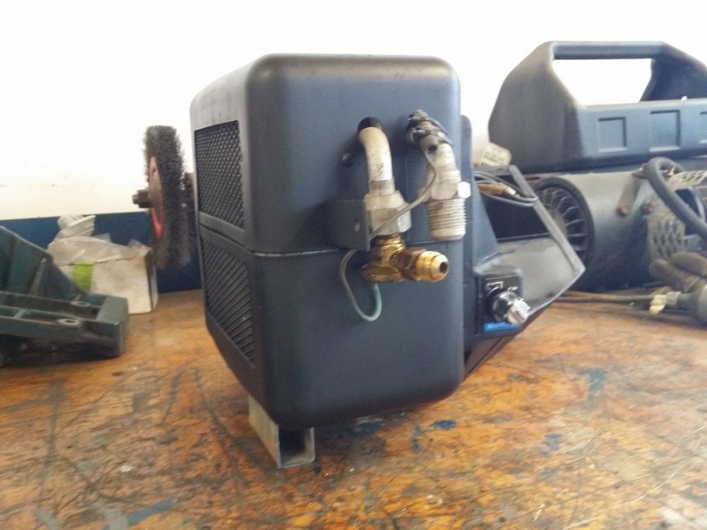

Try find an old unica under dash unit... These were fitted back in the 70s I think possibly a dealer option.. This is what I used, this puts the air out the dash vents. There's a good compressor bracket from the USA, the rest is just generic parts, compressor, Condensor, dryer and hoses.. And some basic wiring
I kept all the info of parts used if you need

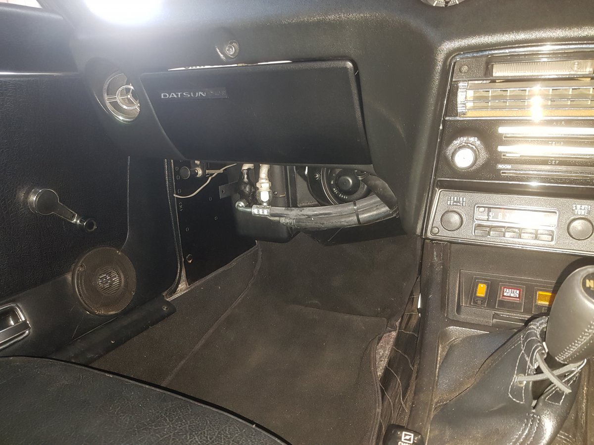

My 71 240z has a dealer fitted kit. I can take reference photos if it would help? After driving Sydney to Melbourne today in 40+ degree heat. I think aircon is a requirement in Australia now.
The unit in mine looks a bit different to the above, but sits in passenger footwell.

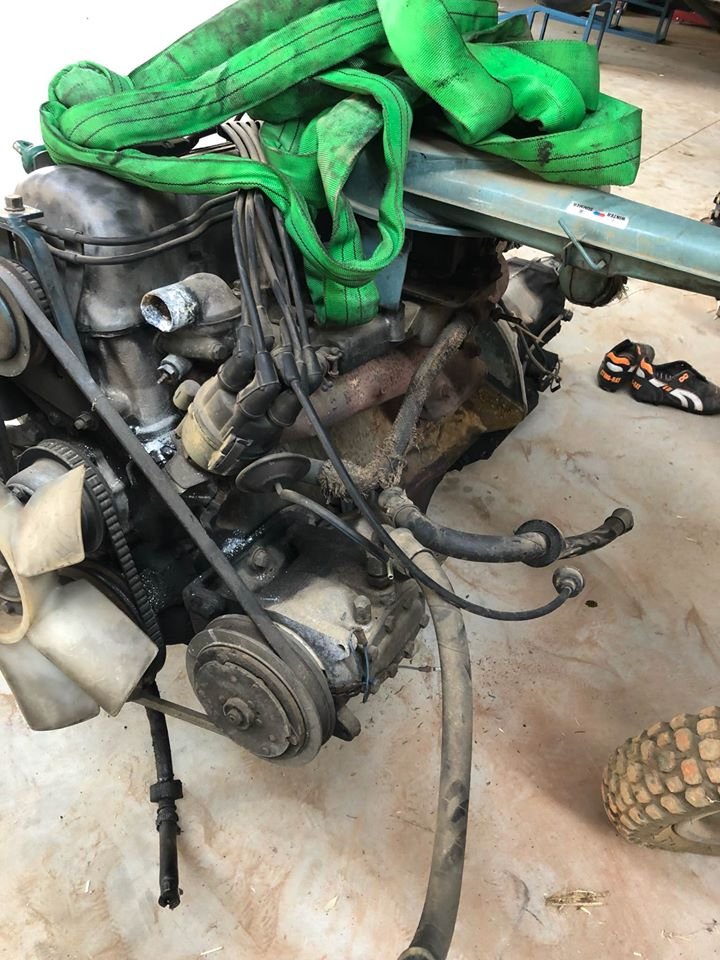

My tip is to find a pulley that will work, then find a compressor that is readily available / reasonably priced, then make or get a bracket made to suit all those bits - its probably easier to get a modern compressor and fabricate a bracket than find an original bracket and then have to find a good condition compressor to match the factory bracket.
The setup I did back in the 90's  with an underdash unit + original pulley + homemade bracket + a custom hose or two + compressor and everything else from a VL commodore worked a treat and was pretty simple to install. Only downside was losing a bit of passenger knee-room

Yes it's great, only downside which I'm looking to change is cold air only comes from dash vents and not foot well vent.. Which is just the design of the original heater / fan system. I just need to put a tee piece in somewhere..
I'll dig up my folder of info... I spent a lot of time on researching

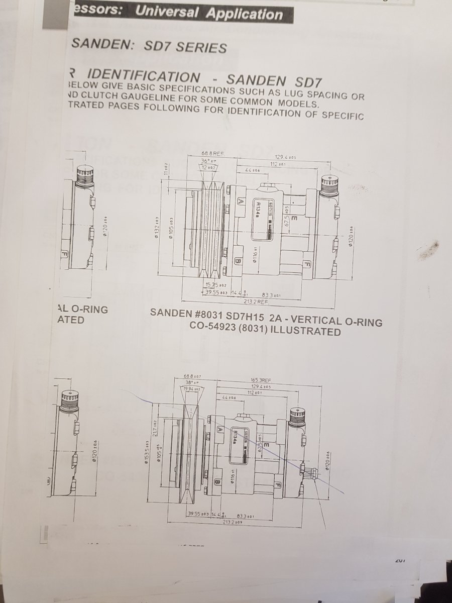

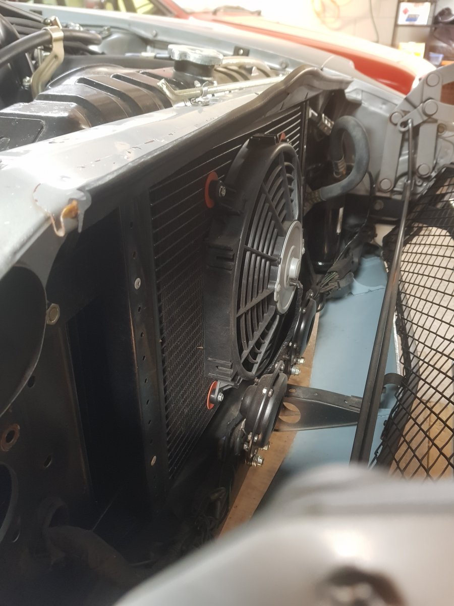

I bought the Condensor off ebay, it was a Sanden but can't find any info on it at the moment. I remember now it arrived bent and negotiated a deal where I think I paid almost nothing for it.. And then straightened it.
