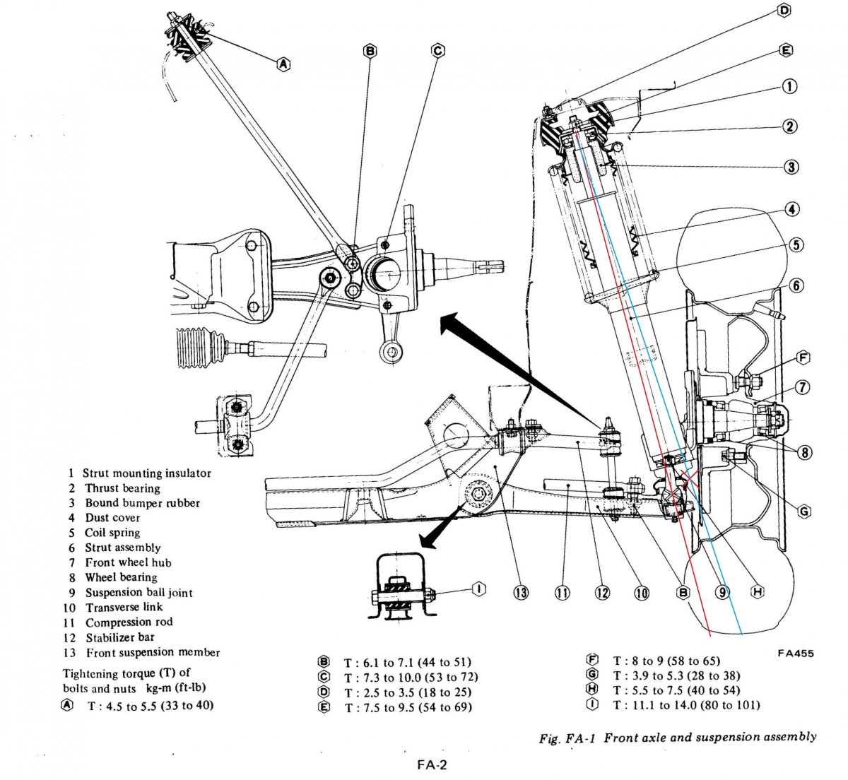

I have copied the diagram below from a 260Z manual and I've assumed it is identical to a 240Z (?).
The red line represents the Steering Axis Inclination (aka King Pin Inclination) of a OEM set up. The blue line represents the altered SAI which resulted when I raised the pivot point of the LCA on the crossmember and also moved it further outward (ie. lowered the car and widened the track). Red 'X' marks the new location of the ball joint. The red line indicates a large POSITIVE scrub radius as standard, something that is now not considered 'the go' for Macpherson struts and may be why OEM cars have relatively heavy steering (?) All wheels on modern cars have significant positive offsets and I wonder if that is anything to do with achieving NEGATIVE scrub radius (?).
Anyway, the blue line suggest the SAI on my car is now pretty close to neutral - although my 16" tyres have 22mm more radius that OEM 14" tyres and could produce slight positive SAI. The information out there tends to suggest a neutral SAI makes the steering less stable so that MIGHT be the issue I have? Although it's a little flighty at speed on uneven surfaces it's still quite heavy at very low speeds.
Any thoughts?

Hi Peter, not sure if I understand what you're trying to articulate above but relocating the inboard LCA pickup point (or even swapping to a longer aftermarket LCA) won't affect the SAI as the relationship between the top strut mount and the lower ball joint doesn't change, it's fixed.
The only way to alter the SAI on a strut setup is with different offset wheels or to change the angle of the strut tube to the hub carrier.
Your changes above will certainly change the track, the bump steer characteristics, the roll centre and also camber gain rates but not the SAI.
Roger

You're absolutely correct Roger, crikey, what a senior moment I had there.
I remember (now) that I was going to re-bore and sleeve the strut location to minimise camber change on a widened track but ultimately decided against it.
I can't recall the off-set of OEM wheels but the wheels I've fitted have 0 off-set however the larger dia tyres should reduce the scrub radius but not that much.

Posted (edited)
On ‎6‎/‎13‎/‎2019 at 9:53 AM, RLY240 said:
..... relocating the inboard LCA pickup point (or even swapping to a longer aftermarket LCA) won't affect the SAI as the relationship between the top strut mount and the lower ball joint doesn't change, it's fixed.
Roger,
I'm not sure I agree with the above.
I hope my memory is surviving, but I remember the KPI as being the angle between a vertical line from the lower ball joint and a line between the upper and lower pivot points (The strut mount and the lower ball joint).
Moving the LCA pickup up, down, in or out (and the LCA length remaining constant or changing the length of he LCA) will move the lower ball joint in or out relative to the strut mount.  This movement has to affect the KPI, as the strut mount stays fixed any change of the lower ball joint position has to either increase or decease the KPI.
If the diagram above is accurate, then having the KPI line through the centre of the tyre means there is no 'scrub angle'.  Effectively reducing the 'auto-centre' of the steering to zero and therefore full steering input is required to straighten the car.  This also has the effect of meaning that any change in geometry due to suspension travel will require steering input to rectify.  The higher KPI will also produce more negative camber and more toe-in on compression (because our steering arm is forward of the spindle?) - which will produce a little understeer and may result in a 'feel' of wandering as it will require more steering input to correct.
The upside is that the steering should be quite light.  :)
Again, if I recall correctly, much of this can be improved by increasing caster angle - pushing the wheel forward - which also reduces the KPI and increases toe-in.  This will make the steering heavier but increase the auto-centring and 'feel' of the steering.
It may be a good idea to jack up the car, remove the spring (and the shocker?) and push/pull the suspension through its full travel.  Measuring the changes through travel will show you exactly what is happening.
Something to remember is that many of the negative issues here can also be the result of low tyre pressure (simply allowing the car to 'roll about' on balloons) - so that would be my first check as it is the cheapest.  ::)
I hope this helps and I hope I've remembered my trade school suspension classes correctly.
I've never even held one of the TTT bump steer spacers, but again if my brain is working, it seems to me that these would bring the LCA angle back closer to stock with only very small changes to KPI, caster and camber as they seem to me that they don't alter the lower outer pivot point they just bring the LCA back into the right arc.  At least that's what they look like they would do to me.

Maygz, I don’t disagree with you, my comments about the SAI not changing related to Peter’s diagram where he was expecting a change to the intersection of the SAI and the contact patch which doesn’t change.
Sure, pushing the lower ball joint outboard increase the actual KPI angle and also camber angle but doesn’t affect the relationship between the strut and the tyre.
Roger.
Share this post
Link to post
Share on other sites
Roger,
yes, that is something I didn't see when I looked at Peter's diagram.  Obviously the drawn position of the tyre needs to be moved to stay in the correct relationship with the now moved stub axle - as you are quite right that the relationship with the stub axle (and therefore the wheel and tyre) with the strut tube is unchanged by changing the KPI.  Peoples, please ignore my comments in the above post regarding 'scrub angle' as this doesn't really change (with the exception of possible reduced tyre/road contact due to increased negative camber)
The most significant change made by the move would be increase of negative camber
It would be interesting to see how much the KPI (and therefore camber) changes through suspension travel even with what I suspect is only a move of the LCA inner mount by about an inch.
