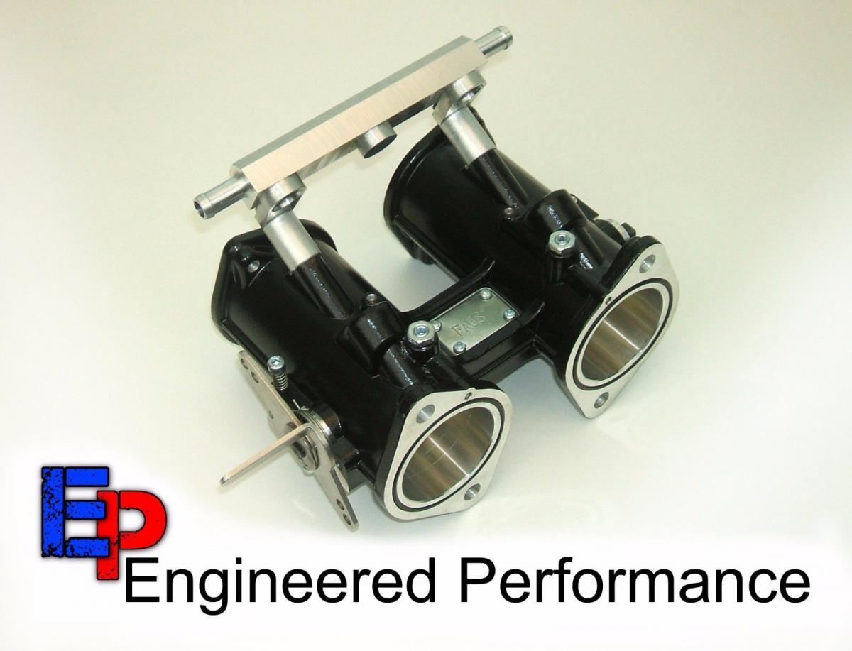

Hunter Posted July 11, 2018 Author Posted July 11, 2018 (edited) Gav, Thanks for that information, looking at more Fuel Injection. Brent, Yes looked at the Heritage, they are limited in fuel injector choice, especially for my engine capicity. Greg, The EP Performance look interesting, had experience with them? Lampy, 3.096 Stroker, uses a LD28 crank from a diesel, 48mm to 50mm I think will be adequate, Just size the injectors right. Lurch, Just eating popcorn? surely you would have some advice? Edited July 12, 2018 by Hunter Correction Quote

GregTas Posted July 12, 2018 Posted July 12, 2018 I have no experience with the EP throttle bodies. It did a bit of research on throttle bodies when I was thinking of going NA for my car and of everything I could find they looked like the best value. With a throttle body really just a butterfly and an injector I couldn't could see the value in some of the more expensive ones. RAP260 and Hunter 2 Quote

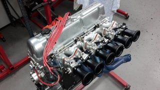

C.A.R. Posted July 12, 2018 Posted July 12, 2018 2 hours ago, Hunter said: Gav got hold of Josel, he gave me a link to this. https://www.racetep.com/zcar-tpgtuning.html Or you could buy the exact same thing from Steve @ EFi Hardware for the same price. That's what I did: gav240z, RAP260 and Hunter 2 1 Quote
