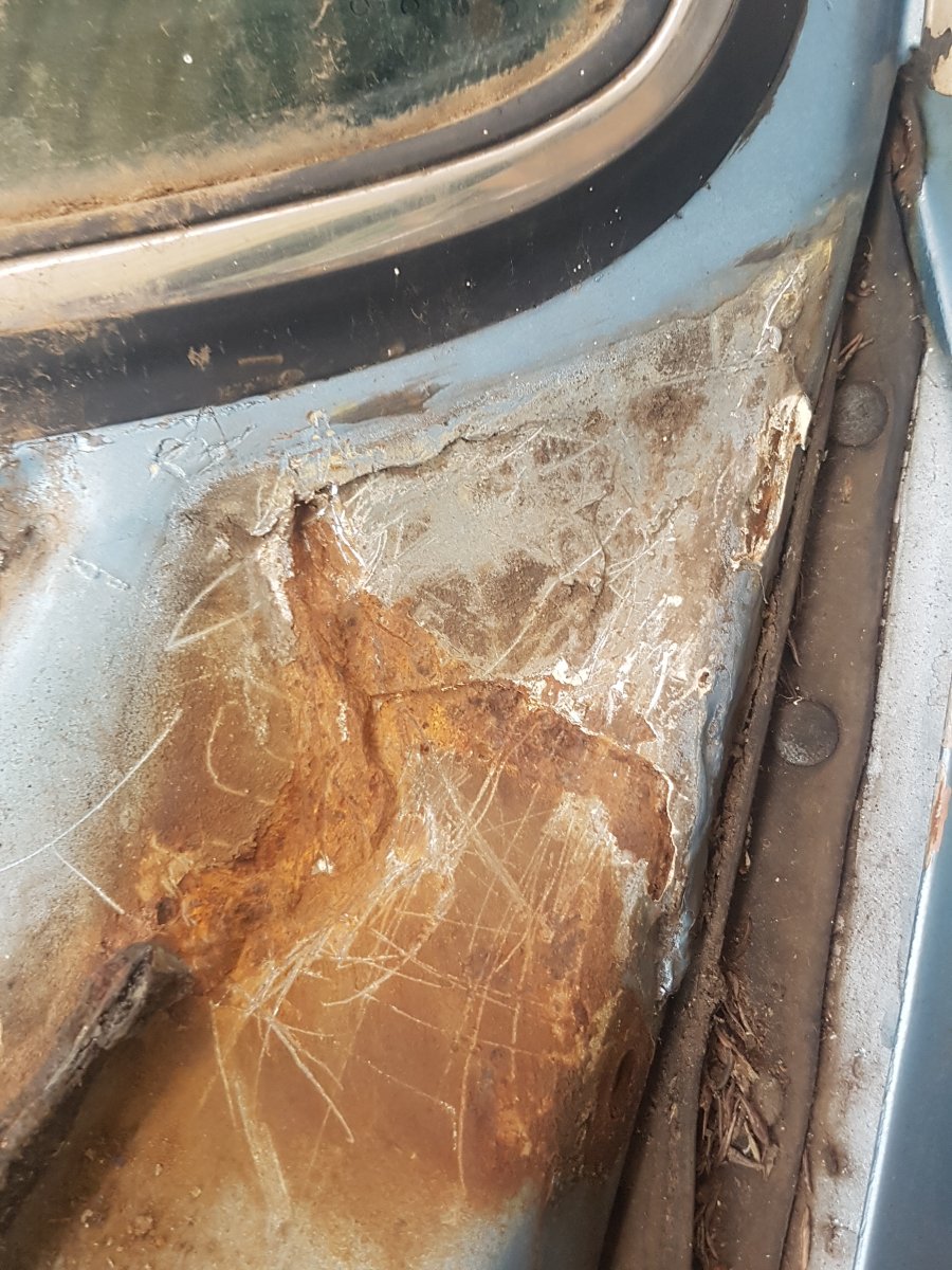

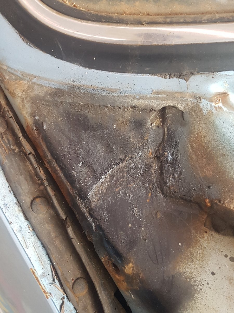

Googled how to remove front guards to start getting front end cleaned up as planning on a big tidy up of engine bay as first step.

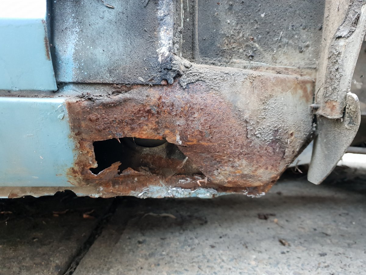

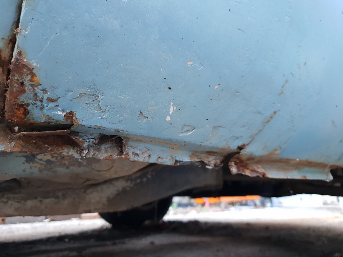

However I didnt see any files on how to remove the "factory welded" front gaurd onto the sill panel lol.

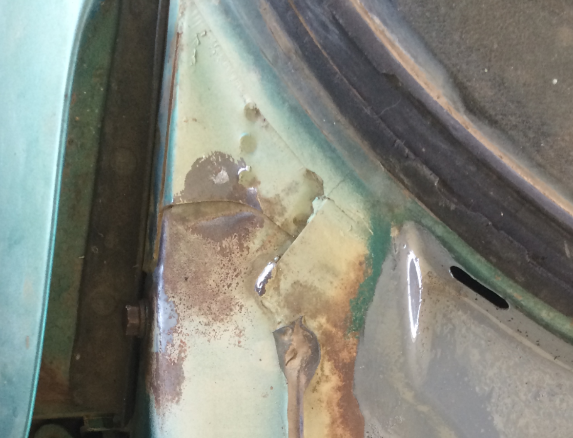

Looks like previous owner thought cutting the rust out and just leaving a big gaping hole would be fine, just weld the bottom of the gaurd straight to the car... hmmm.
So all in all not as bad as i thought it might be. Now to get gaurd repaired. Are the replacement weld in panels on Ebay any good? Or is there a better place to buy them.?

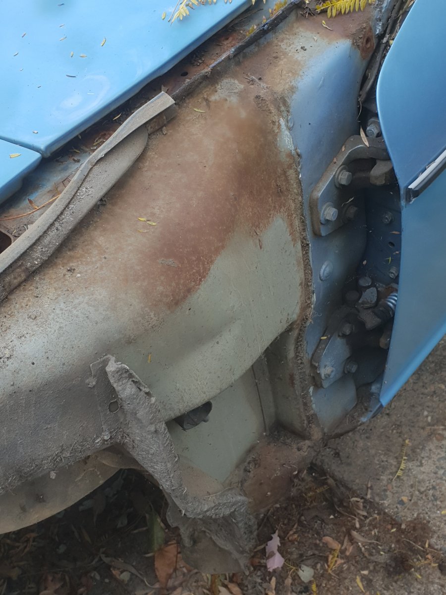

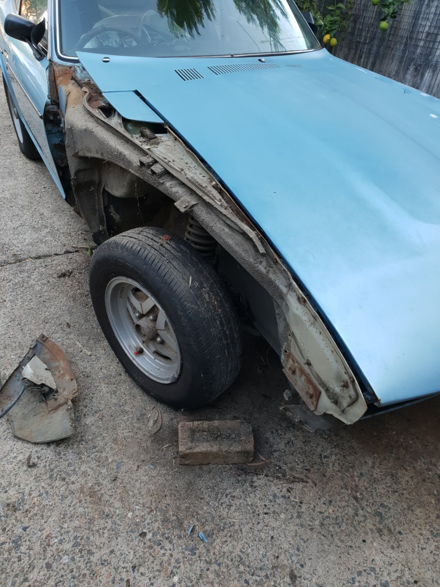

Successful removal of drivers side.
Hopefully finish passenger side next weekend.

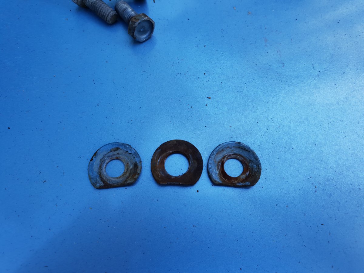

Inner engine bay area bolts had these strange washers with one edge cut off. Am assuming these are just another dodgy thing from previous owner ?
Share this post
Link to post
Share on other sites
Nope OEM to fit.

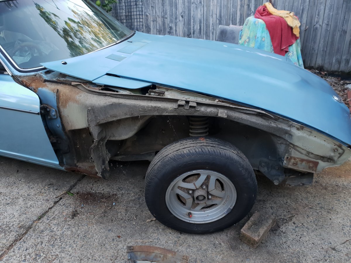

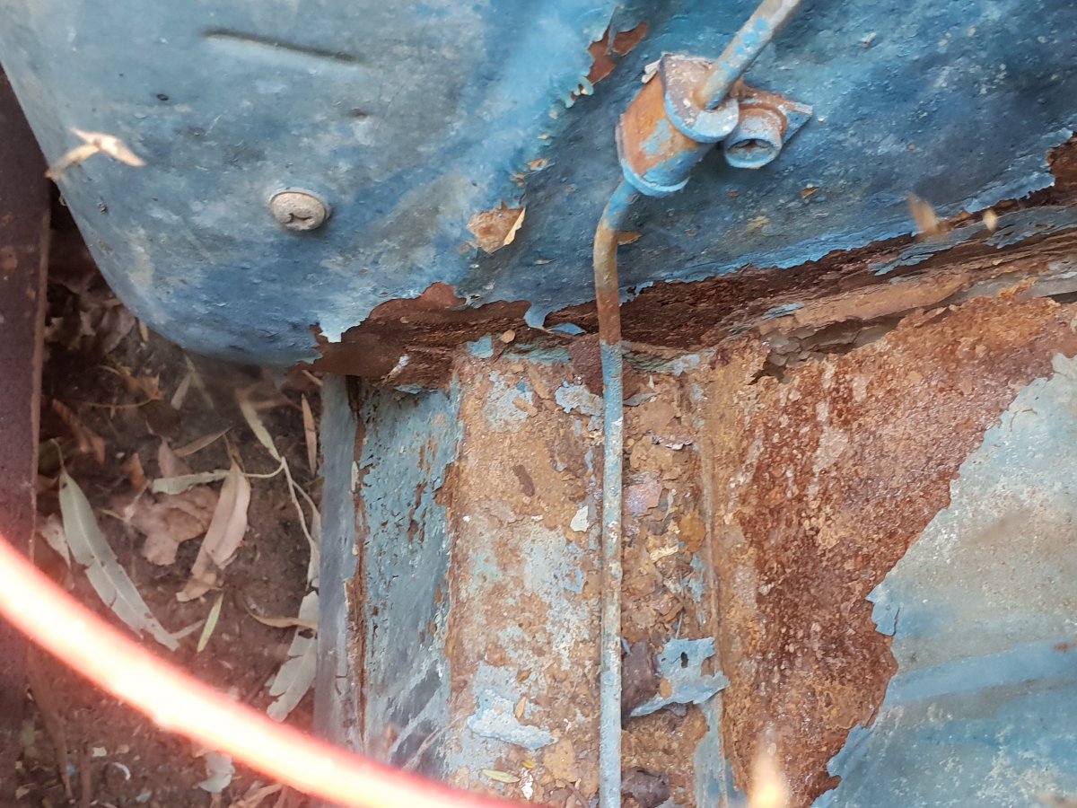

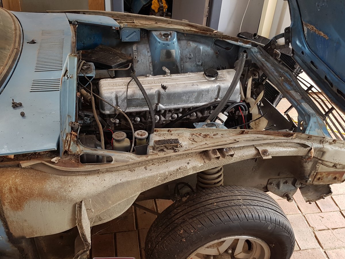

Passenger side front gaurd removed and is much better shape than underneath than the drivers side.

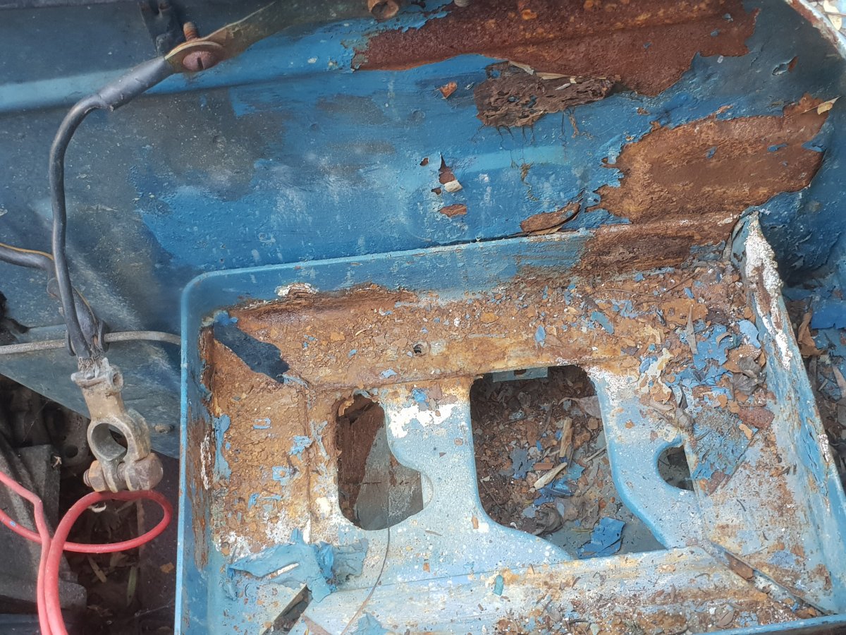

Under battery area not so great however and has some wonderful weight reduction going on. Fairly certain it hasn't eaten into the chassis rails though.

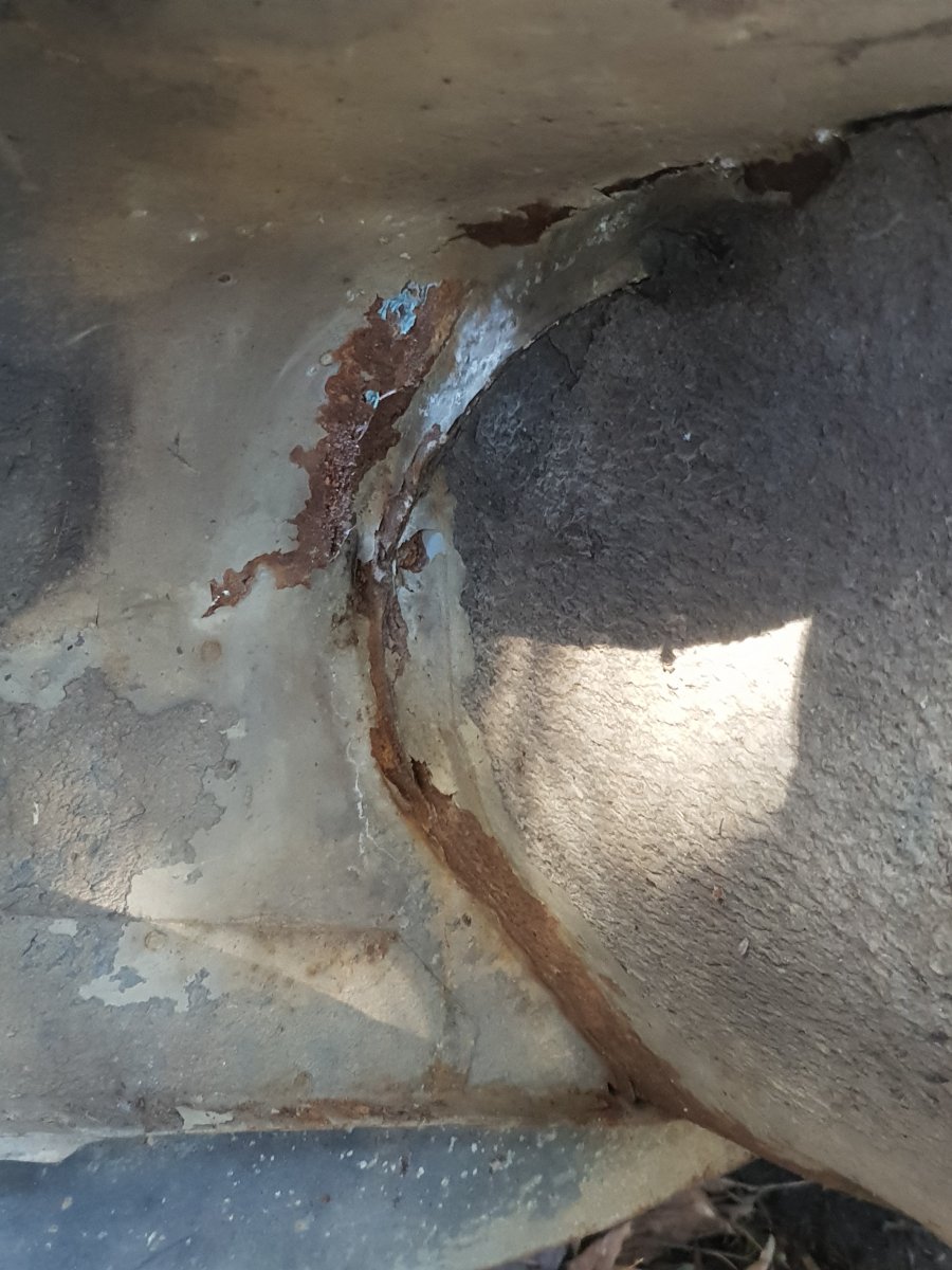

On 10/14/2018 at 6:14 PM, 260z blues said:
Looks like you may need to unplug the drain there, shouldn't hold water like that. I'm guessing it's blocked with debris etc.. inside fender area etc..

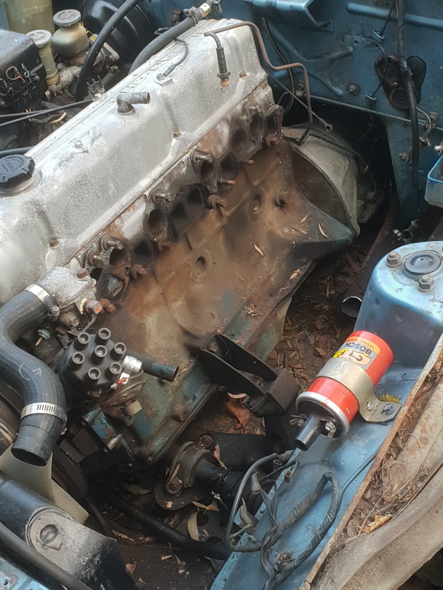

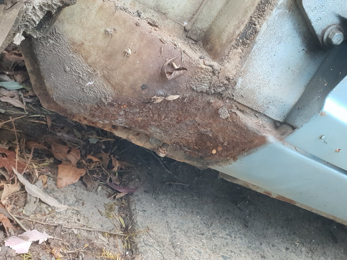

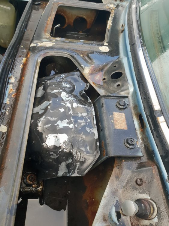

Slowly getting closer to removing the engine and clearing out the emgine bay ready for repairs and paint.
Needs some holes fixed under batery tray and bottom of radiator support. Not sure if best to have them custom fixed or look for replacement panels.
If it is just some limited damage then a custom fix would seem to be the better option.
Share this post
Link to post
Just the bottom part of the rad support but with significant rust. Same with battery tray area. Will prob see what the panel guys say and what they are willing to do.

Battery tray is fixable but under is toast. Have yet to find any RHD replacement at all.
