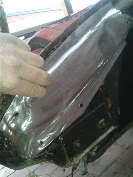

thriller Posted August 5, 2013 Posted August 5, 2013 Had the same issue. Have a go bashing it yourself (unless you get lucky finding a replacement piece), worst comes to worst you lost a few hours trying to learn a new skill. This was my first attempt at shaping metal that was more complex than something I could bend by hand. Helped me to roughly make a buck out of a piece of wood & bolt a flat piece of sheet to one side of it. Quote

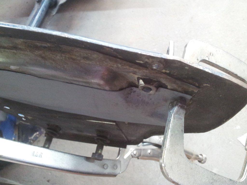

Scoota G Posted August 5, 2013 Posted August 5, 2013 Drill out the spot welds from one side. Cut the outer piece off as the chap above has done then check condition. The inside is flat so it's easy to repair. As stated above the outer is harder to fabricate. When welding it back together use weld through primer where two metal pieces join, then etch primer on the rest followed by an epoxy. Do not contaiminate the areas to be joined with the latter two paints. After that just clamp in place and puddle weld the spot weld holes. Simples Quote

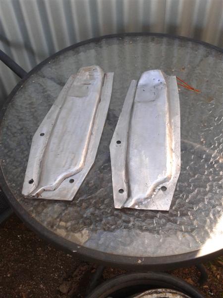

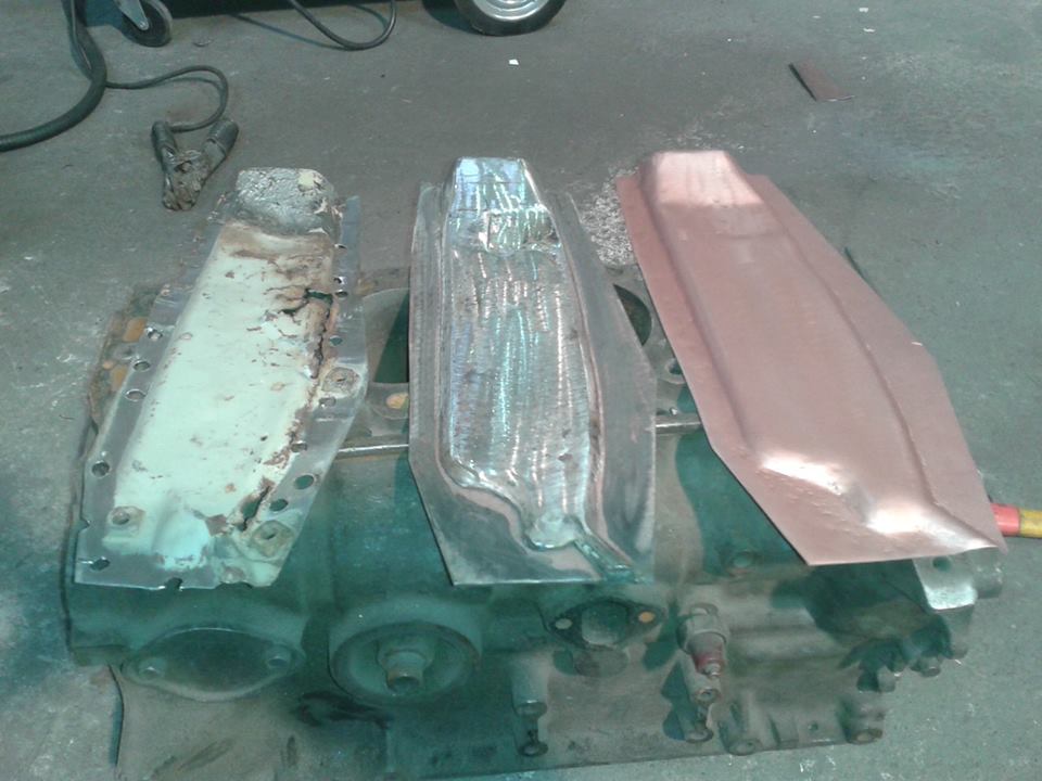

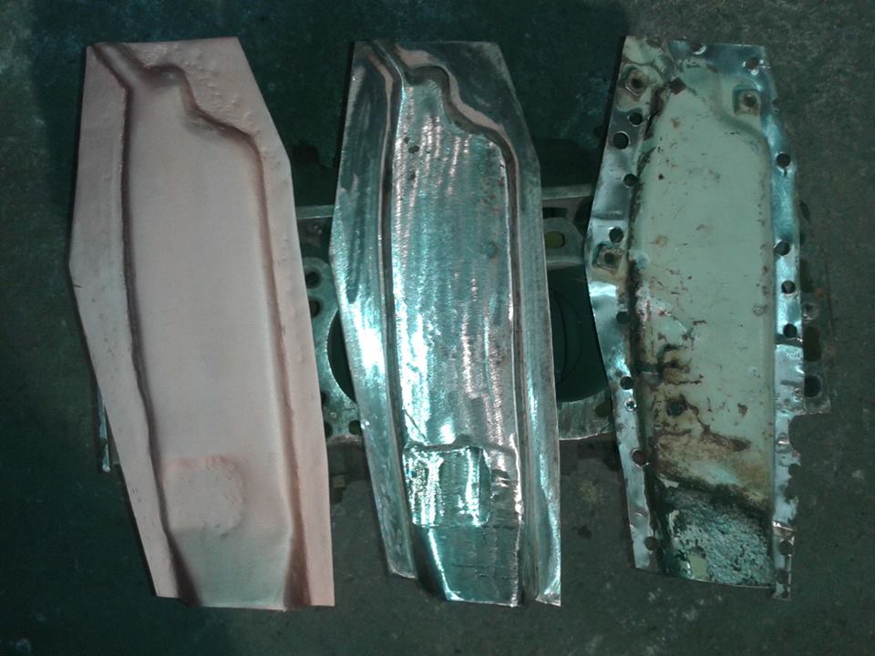

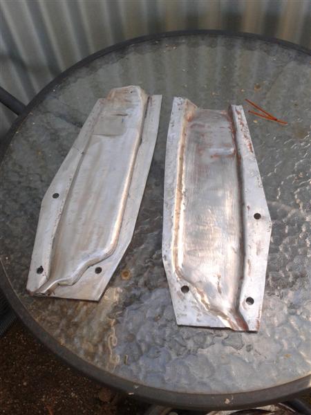

Scoota G Posted August 6, 2013 Posted August 6, 2013 But probably what you really want is one of these things in the centre of picture. Quote
neRok Posted August 6, 2013 Author Posted August 6, 2013 A 4cyl engine block... no thanks Are they spares or are you making them? Quote
Scoota G Posted August 6, 2013 Posted August 6, 2013 A 4cyl engine block... no thanks Are they spares or are you making them? The new one is for the current project car LHS. I'm yet to make a RHS Dolly but yes i can reproduce these for $50. Here it is with the nuts welded in place. Quote

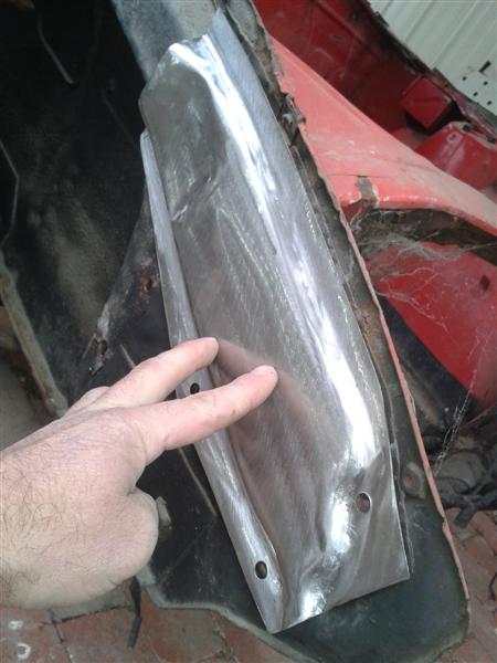

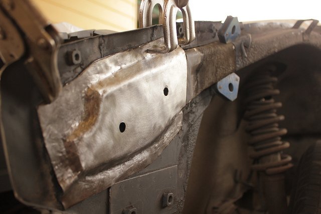

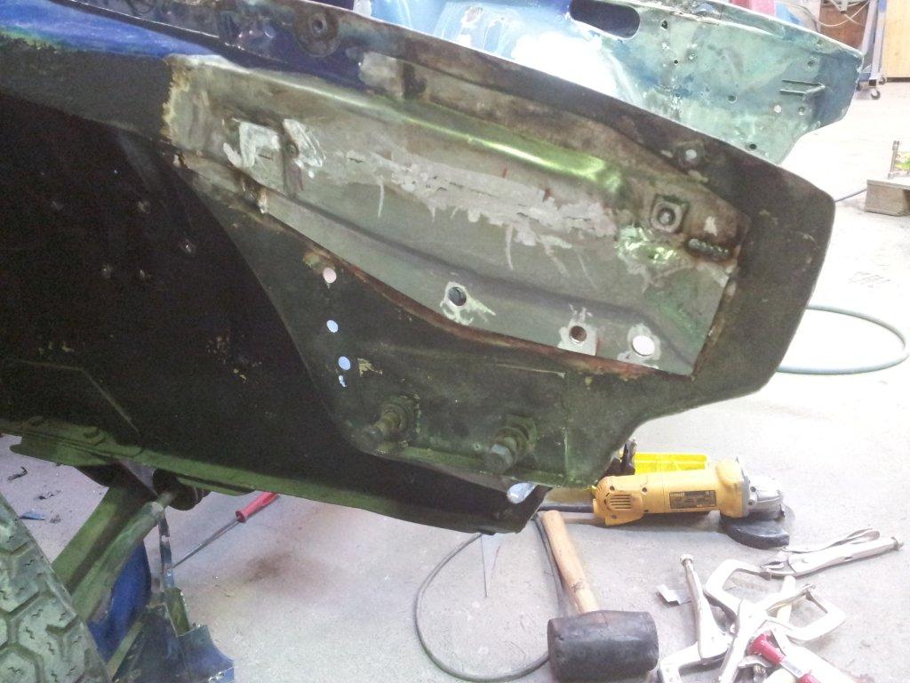

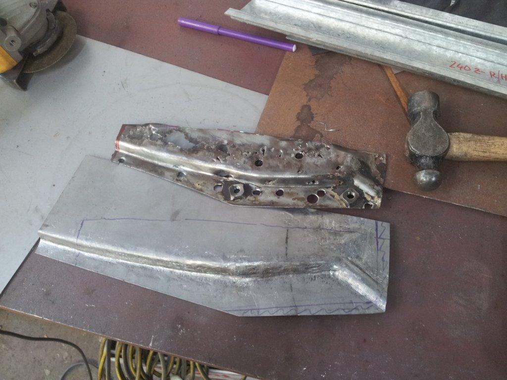

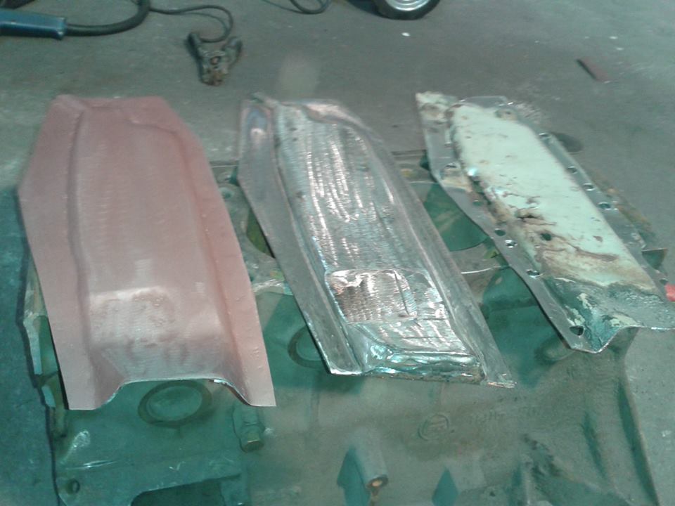

nat0_240_chevZ Posted August 6, 2013 Posted August 6, 2013 Yup, common as. Ive done the same, beat up your own. few pics below, but cant find any once it was finished off, also had to do the inner. ended up metal finished, probly overboard for an area which will be covered and forgotten about. nat0 Quote

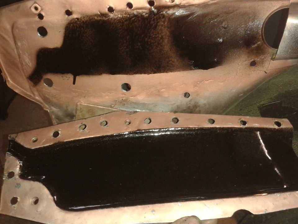

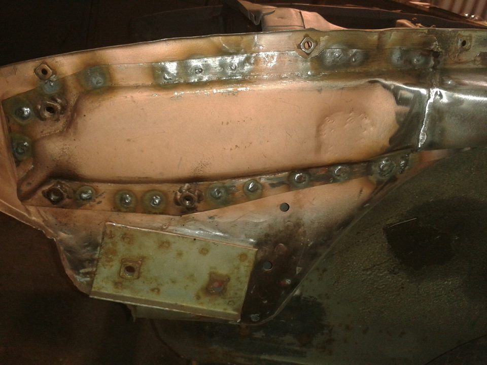

Scoota G Posted August 7, 2013 Posted August 7, 2013 This is an example of the spray pattern i was talking about. Epoxy of primer on the inside and weld through primer on the edges. Quote
neRok Posted August 7, 2013 Author Posted August 7, 2013 Is all the copper coloured area the weld through primer? Quote
Scoota G Posted August 7, 2013 Posted August 7, 2013 Is all the copper coloured area the weld through primer? Correct. It's a copper rich primer. Quote

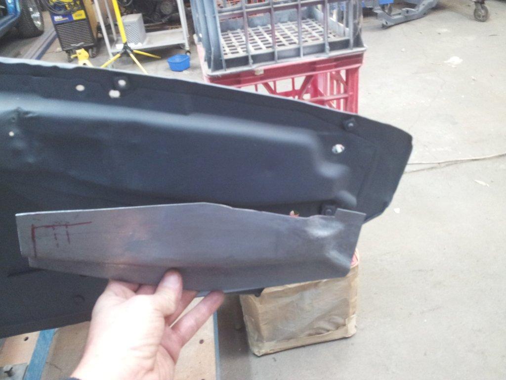

Scoota G Posted April 23, 2014 Posted April 23, 2014 Following a request i have now fabricated a Driver's side dolly for the same area. I'll be knocking a set out soon and i will post up a photo. At this rate i think i will have to become a sponsor of Auszcar. zeds4ever 1 Quote

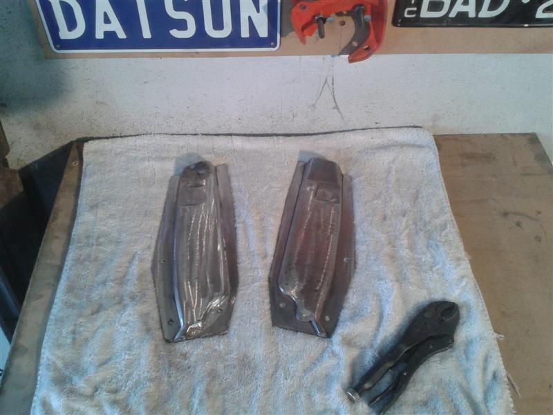

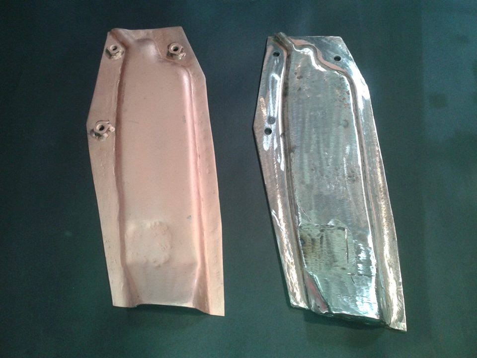

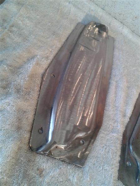

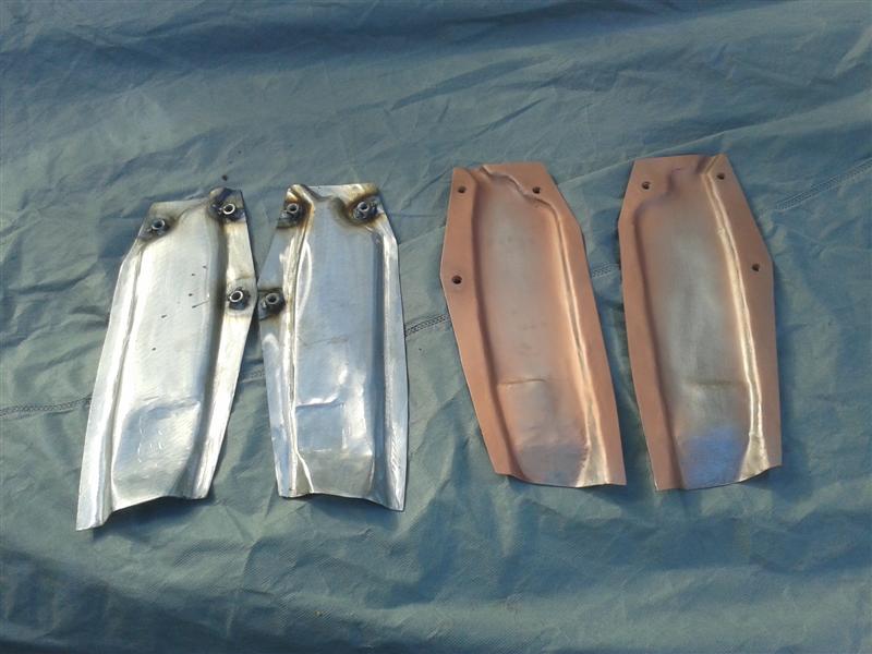

Scoota G Posted April 30, 2014 Posted April 30, 2014 Here are some picture of completed sets as requested. zeds4ever 1 Quote
nat0_240_chevZ Posted December 3, 2016 Posted December 3, 2016 Hey scoota, i forgot about this thread. If you make a stack and wanted the nuts Welded on for you I have access to the correct equipment currently set up for an M6 square weld nut send me a p.m. if you need I do believe these are an M5, off the top of my head but it has been a long time since I've even seen my car. All youll need to do is drill the hole out. The setup used on our pedestal spot welder, with a dengensha insert, keeps the nuts centred on the hole whilst blasting away the cnrs with a hot pulse. Just incase you have the need. Nat0 Quote
