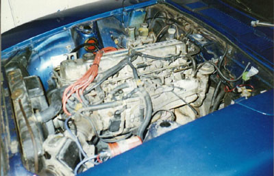

First a quick reminder of what she was aaaaawwww

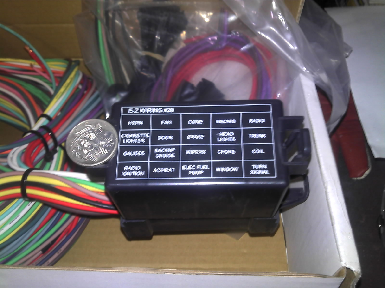

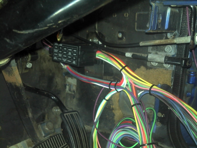

Then whats this box? 20 x trouble!!!!! haha

Yes that's a 20 circuit ez wire harness that's going to keep me awake many a night.
It wont get started till i find what i need from the Half cut when it arrives i also want to refit ac to this bus!

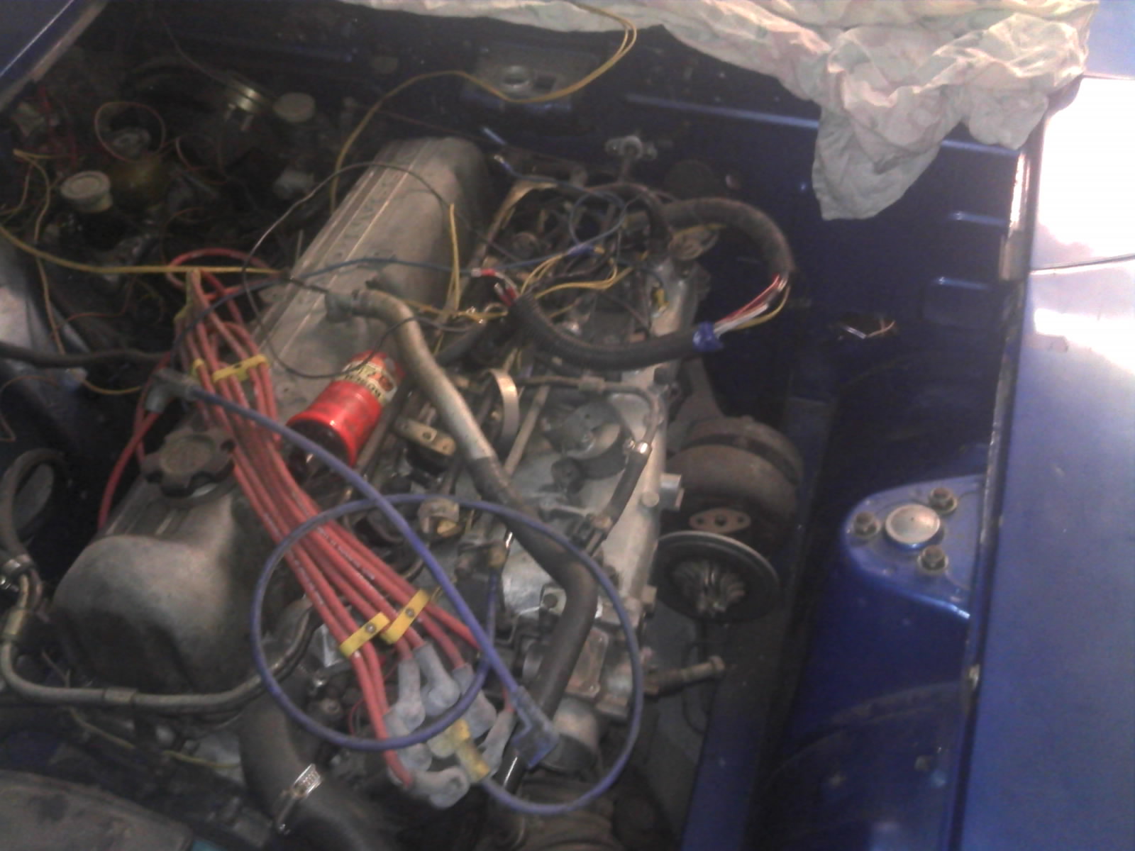

So next i thort ide make a start on removing the parts that wont be used for the new engine.

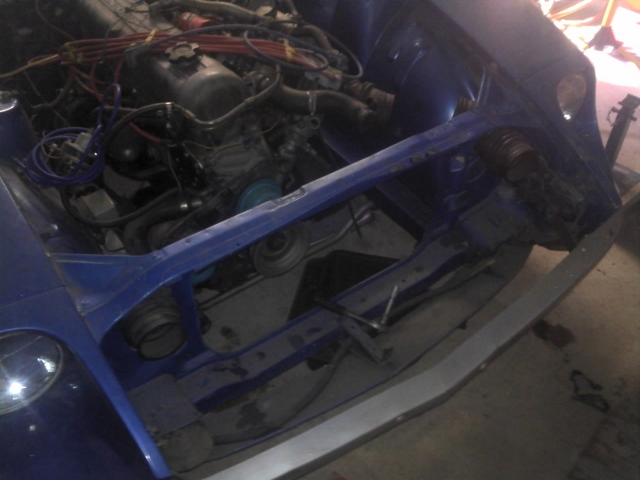

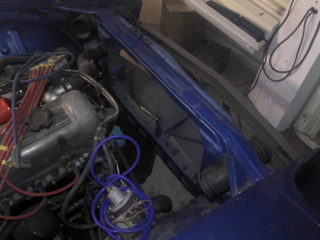

The last lines and wires of the zx"ish" motor are disconnected.

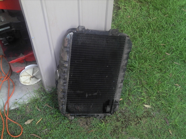

Radiator and fan gone.
Lucky some punk kid went crazy with the spray can in here theres little to no rust that wassent already there all those years ago so far.

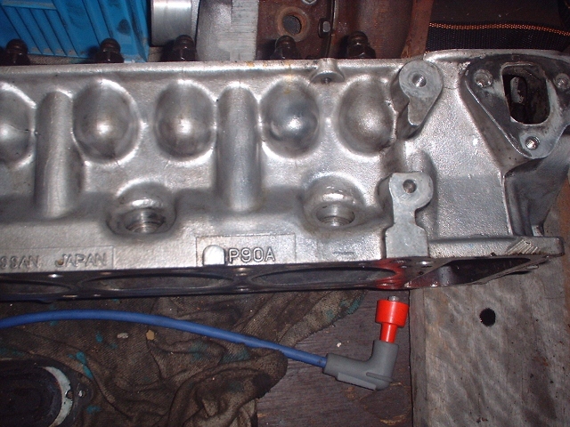

To bad i don't have the engine sump to try anything hell the l28s still in there anyway  :P

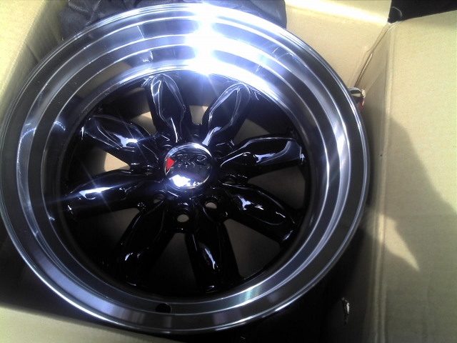

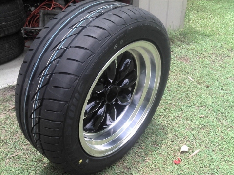

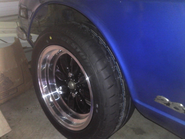

And just to be bad i got me some rims not sure i did the right thing yet but they will do for now.
16x8 +0s all round probably could have gone the 16x7+4 on the front there pretty out there.
Seem fine on the back.

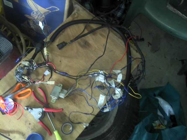

Don't let the wiring fool you its all been disconnected from the car and just laying there in the later shots.
The cars loom is pretty buggered and some young owner made it pretty nasty trying to keep it going at one point ha ha
Hes a bit older and wiser now hence the new wiring kit.

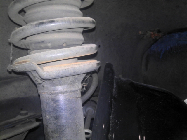

The front rim is REAL close to the spring perch i think I'm going to need a very tight tyre weird thing is it looks like it will hang outside the guard too freakish?
Hanging out is easy to fix rubbing suspension parts not so much i may still go a set of 16x7 +4s but when i do the math ide gain 8.7mm i guess that is better.

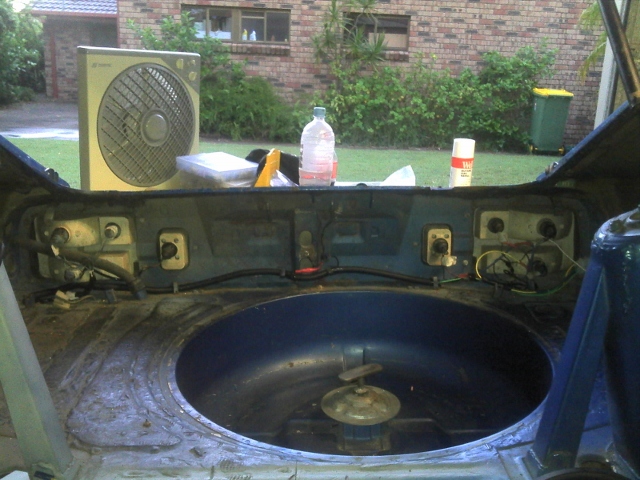

Now I'm onto the rear tail light section but i want to replace all the bulb holders anyone know where i can get them?

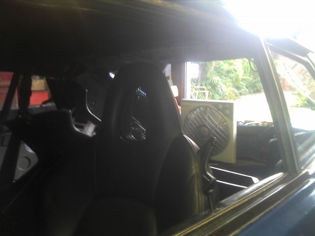

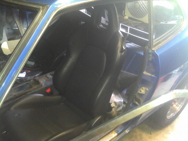

Yeah hybridz made me do it haha
The seat is just sitting across the standard pads and the s2k rails in those pics.
The seat seems to clear just nicely in a 74 and the 2+2 bit seems to make the documented head clearance issue a little less of a problem?
I can get some better pics of it and when i finalise a mounting plan with the engineer (hes off work injured till mid jan  :-[ ) ill show that too.
The seats feel awesum and look just about right in the car i thort!
Anyway i had to leave the seats and get back to the real work so the rear lights are wired into the new harness i need to sort out what pump etc ill be running to finish the back half.

Went and got new tyres for 2 of the 16x8s at first so i can test fit them on the front
I know they go on the back easy.... and now i know they go on the front too clear (just!!) everything but hey hang out the guard hmmmm

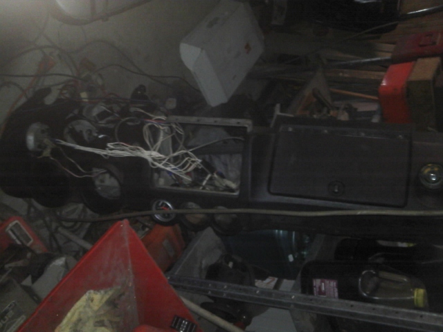

So to cheer my self up i finished stripping the dash and had a look at what i can do about fixing it.
I really want it to look nice now since i went mental on the interweb an hit up speedhut for 6 of the best!!!

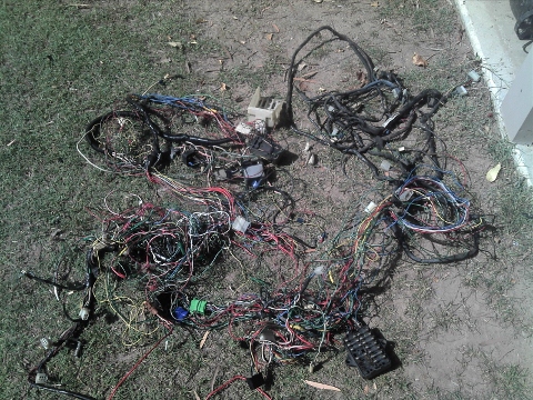

To finish off i took a few pics of the fun i had today and before you ask the new wires where still in a test loom not finished ha.

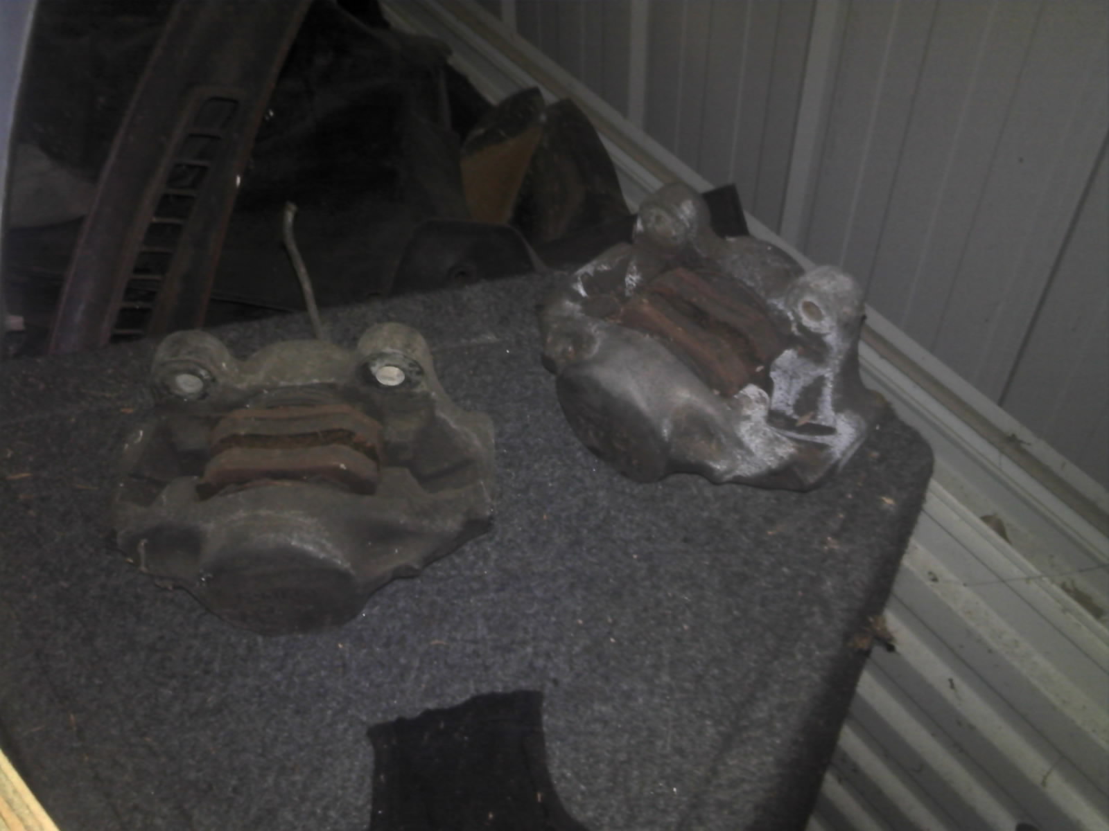

heres the front calipers pretty sure there the right ones  :o
r31 Aussie sedan i knew so heres the back oh and sorry guys last pair on site  :'(
heres the comparo to stock calipers ill try and get a shot of the non vented next to these when i can get around to it
top view for those that dont know look at the pad difference!!

First off and i should have known better but you cant machine the t2 slot Silvia disks down to datsun outside diameter or they may crack bahhh!
So now I'm going to run 280mm front disks and sqweek the calipers out somehow because I'm crazy....
second thing i learned I'm probably able to get my spring perch "moved" to fit the xxr 513 16x7 +15 wheels so i went and ordered some
Now they may fit as is (before anyone goes off at me you got to measure MY car) but at least i know i can tinker them in there

here's one that i nearly won....
dash before
again big cracks and what not
last one i promise
and if the camera would work after!
you might be able to make out the speed huts in there mmmmm
but my dash repair sucked its going to get a dash mat for now i need to move on
I nearly finished the rest of the wiring I'm really close now
