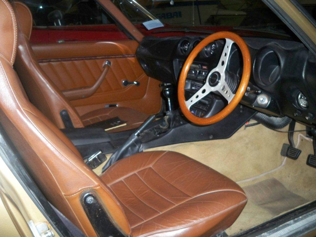

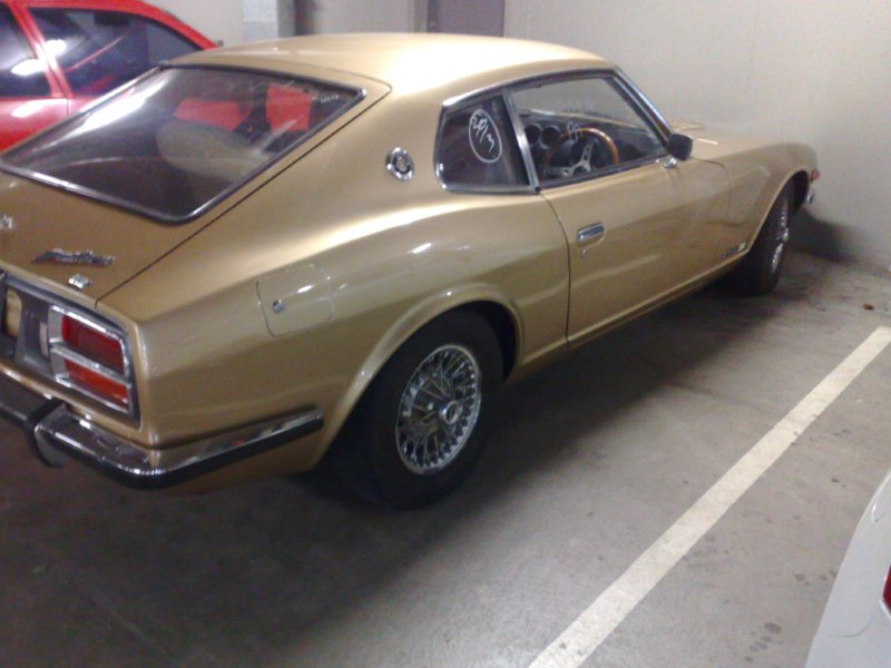

Shan Posted January 17, 2011 Share Posted January 17, 2011 I have had the car for the better part of 12mnths now - so thought I should start contributing to a journal! Thought it might help others going down the same path, as well as be a record for my own benefit. She's still a work in progress, but this is how it looked when I bought her.... Interior, exterior and engine... Car was in very good condition and had apparently been in the same family for 20years. There were receipts for body work and various maintenance tasks, although I suspect in more recent years had been somewhat neglected. She was by no means perfect, but it was a very driveable. What I disliked the most was the original colour choices - gold and brown interior - yummp. Still - I was happy with what I got. Quote Link to comment Share on other sites More sharing options...
620Z Posted January 17, 2011 Share Posted January 17, 2011 Looks pretty clean and straight. What you need to do is decide what colour you want the car to be. Then you can work on the interior and carpet to make sure you don't do things twice. Quote Link to comment Share on other sites More sharing options...
Shan Posted January 17, 2011 Author Share Posted January 17, 2011 Yeah - she was straight and clean. Like you say - put some thought into what changes I wanted to make. Well and truly down that path.... First thing I needed to do was alter the interior. I knew I was eventually going to replace the brown poo with whatever original black trim I could find. My interior trim was in excellent condition, so figured it would take me a while to find suitable replacements in black that were in a similar condition. So while the search was carried out for original black trim, I started doing some research on vinyl/plastic paint. I was sceptical about the results, but saw no harm in giving it a crack. After lot's of forum trawling over the globe, decided to settle on a brand called SEM Colour Coat. Also purchased their preparation cleaner. Might have been unecessary to get the cleaner (forums had varied views), but I wanted to make sure this paint bonded as tight as possible. I washed all the interior items TWICE over - (wash/dry, wash/dry) and scrubbed lightly with a scourer and then cleaned with SEM prep cleaner to ensure all old contaminants were removed. I then used my Supercrap Auto cheap ass compressor and paint gun to apply it. Hmm...I thought I had more before and after photo's....will try to get more up here when I find them... This should give you an idea of result though: Quote Link to comment Share on other sites More sharing options...
620Z Posted January 17, 2011 Share Posted January 17, 2011 Yeah they look alright Shan. That's all you need to do for some of those parts. Once back in the car they won't be touched to the paint won't come of or anything. Should be OK. Quote Link to comment Share on other sites More sharing options...

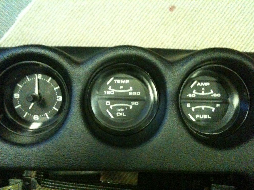

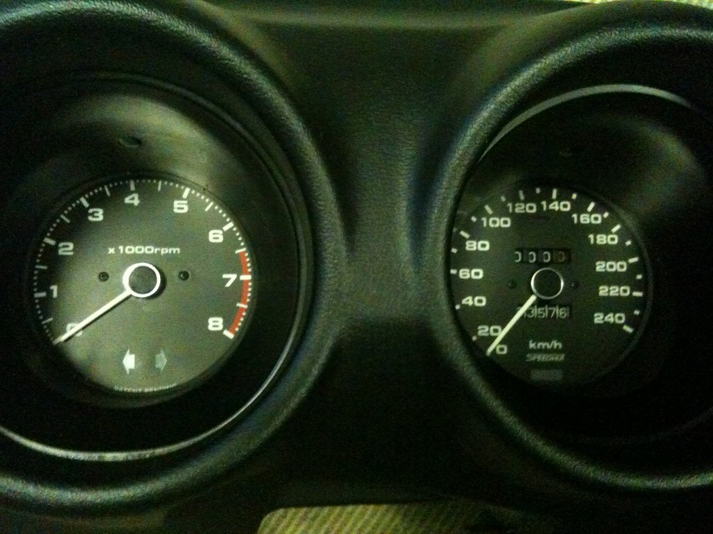

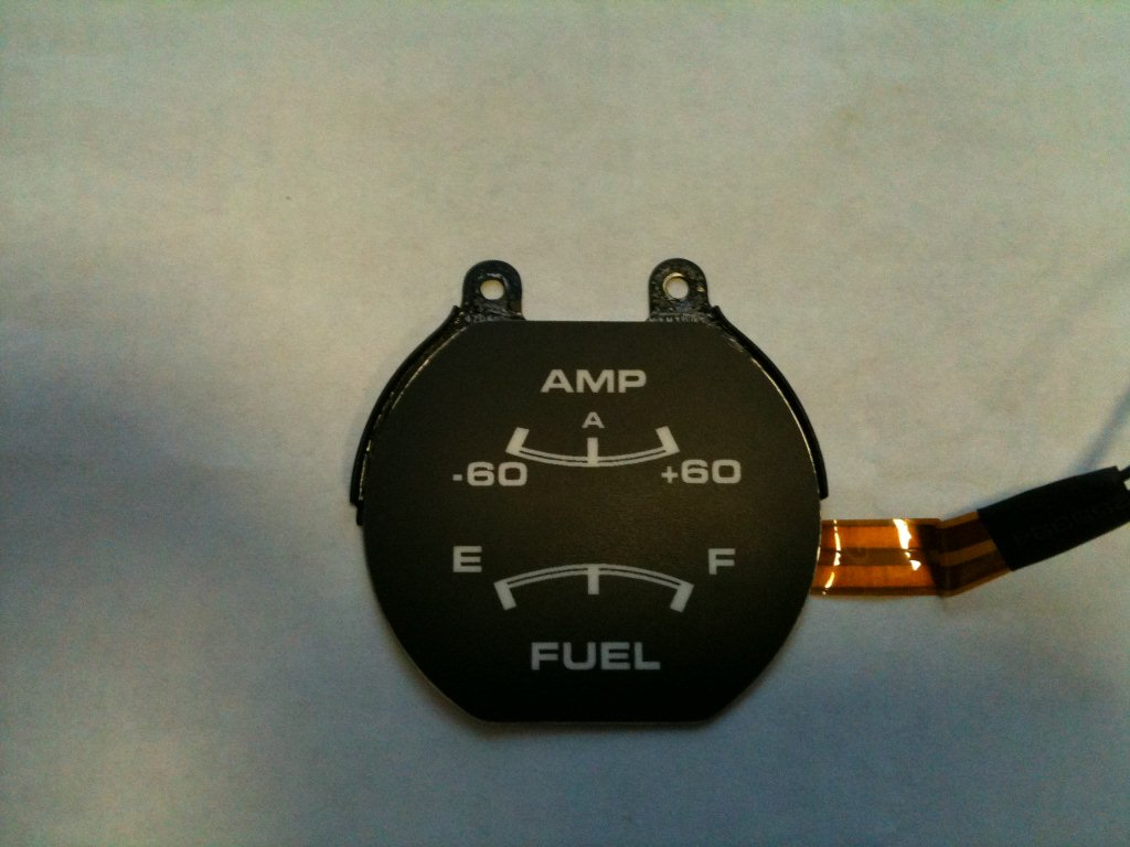

Shan Posted January 17, 2011 Author Share Posted January 17, 2011 So..... Since I had most of the interior out - I decided to pull the dash as well. There were cracks in my dash which bothered me, so it was going to come out eventually anyway. Took the dash to The Dash Doctor for a full reco. Cost a fair bit of $$$, but I reckon the Zed dash is one of the main features of the car - so deserved a bit of attention. I stripped out all the gauges and gave them a Speedhut face uplift as well. http://www.speedhut.com/gauge_products-gauges-ELGLO-auto-Datsun.htm I know people have already posted about these - so won't go into too much detail. Also took the opportunity to replace ALL the globes. The ELGLO gauges I chose light up "blue" in colour, so I also went for a Blue globe to match that. http://cgi.ebay.com/ebaymotors/DATSUN-510-1200-240Z-260Z-280Z-BLUE-DASH-GAUGE-BULBS-_W0QQcmdZViewItemQQhashZitem483b72436dQQitemZ310234989421QQptZVintageQ5fCarQ5fTruckQ5fPartsQ5fAccessories I checked into getting my own glass paint and painting my own - cheaper to get them off this guy at ebay. Can only hope they are ok quality. I read a bit about LED's and came to the conclusion that I did not understand anything about car electronics. They require different level of power to run than the normal globes and I think you have to play around a little to get them running with resistors and such. Too hard. Added to that, LED's throw light around at different angles to a normal globe, so I read some people had dark sections on their instrumentation with LED. Anyway - decided to leave well enough alone. I also read somewhere that painting the back of the gauges with a fresh coat of "white" helps intensify the light. Was a practical and simple way of reflecting the light from these globes a little more efficiently, so I painted the back of gauges (behind the face etc) with a fresh coat. Polished the plastics with a light auto polish as well. Got rid of all the hazing and they came up crystal clear. Quote Link to comment Share on other sites More sharing options...
Shan Posted January 17, 2011 Author Share Posted January 17, 2011 One more.... Quote Link to comment Share on other sites More sharing options...

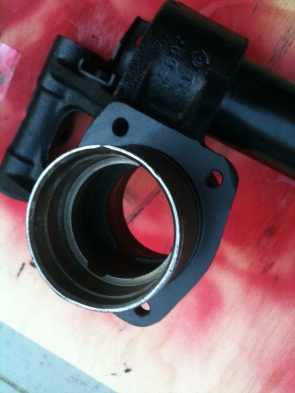

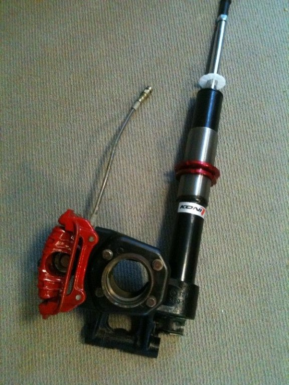

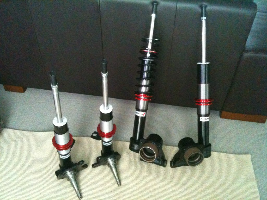

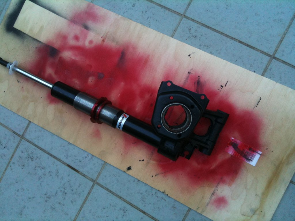

Shan Posted January 17, 2011 Author Share Posted January 17, 2011 Since I had all the suspension out, decided to have a looksy into brake options as well. All sorts of options out there (mentioned frequently on the forum), but I was lucky enough to come across a guy selling it all as a package. Was track proven, but he had decided to go bigger. Suspect brake fade on hot track days, but since I am not using the car for track - seemed like a good deal to me. Front Calipers - Toyota 4 pot, Front pads EDC yellow racing compound, Front ventilated discs 280zx with spacer. Rear Calipers - R31 single pot slider with hand brake mechanism (keep it legal), Rear disc Skyline R31 rotors, rear pads Ferodo Excel pads. Ready to bolt on basically. The hard work was already done to the R31 brake bracket - original mounting holes were welded shut and new one's with 260z offset were drilled. Centre hole (where the half shaft goes through) had also been widened to match Zed. Also came with braided hoses and some custom brake lines - so was happy with that. I decided to beef up the master brake cylinder as well with the 1" from Nissan Patrol. Guys on the forum mention it here and there (PBR part no: JB1419). Not sure about brake bias? Will have to wait and see. Hopefully not too bad though. Had to do a little grinding with the dremel to bottom of strut where custom R31 brake bracket bolts on. If you look at the corners in "small brake2" image - you can see where corner needed an edge off it. I could have modified the R31 bracket, however there was more metal to play with on the strut and I felt that taking anymore from the modified bracket may compromise the integrity. Decided to clean and paint the calipers since they were in my hands. Will post up some more photo's when I have them. Below is rear setup....will post front when I have a chance.... Quote Link to comment Share on other sites More sharing options...

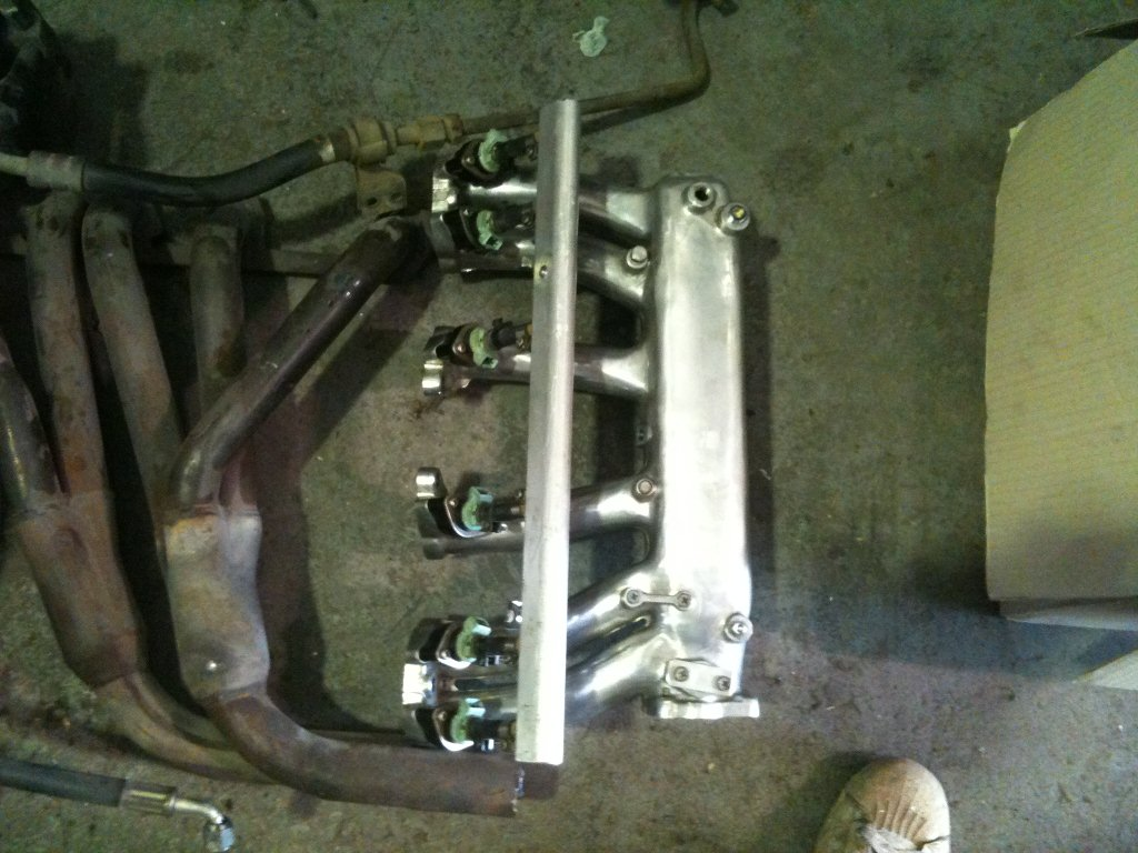

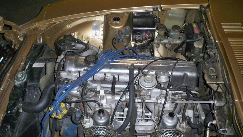

Shan Posted January 17, 2011 Author Share Posted January 17, 2011 I know I keep smashing these posts up - trying to do it while I am on a roll though. Catching up on what I should have posted earlier basically. Engine stuff...... Normally aspirated, turbo, fuel injected, V8, etc, etc, etc. Plenty of options if you have the cash and time. I was thinking of going a V8 and was well aware of the engineering costs. Looked into the engine mounts from http://www.rodshop.com.au/nissan/nissan_datsun.htm, giving it all some serious thought. Was also thinking about a possible RB conversion. Plenty of engines around once you get the engineering done. However, depending on the power you choose engineer may make you look at brake options. Additionally, they may also make you get some sort of chassis "stress" test done which is more $$$. Depending on the outcome of that they may make you reinforce the chassis to their specifications. The list goes on. None of this was cheap though. Decisions, decisions.... Finally I read a comment that struck a note with me. Why not keep it simple? The L Series engine is a solid platform to begin with. Whether it be triple carbies, factory fuel injection or even factory turbo - the L Series already has a heap on configurations with PLENTY of bolt on bits available at low cost. Gearbox mod's are easy enough as well, so my final decision was to keep engine more original and NOT complicate things (well not until later on anyway ) The L Series was going to be my starting platform. Configuration? Sat down and thought - what was important to me? Decided that "driveability and simplicity" were important factors. I wanted easy cold starts and did not want to worry about having to balance carbies/tuning - so fuel injection was the only way for me. I waited a little while and decided to purchase a complete L28E on the forums. Only had some very mild work and low k's done according to the previous owner and I was inclined to believe him as he had a good reputation and history on the forum. Came with standard ECU, Electronic disti, extractors, intake - the lot - all very clean, neat and tidy. I got a little lazy with pictures around this point of the restoration, but have attached a picture of old engine and new engine in the car below. One thing I was not really taken with was the fuel injection and intake manifold. What a mess! Did some research and discovered there is another type of L Series manifold without all the anti-pollution rubbish. You add a nice fuel rail to this and you go from one extreme to the other. Pic's below... Quote Link to comment Share on other sites More sharing options...

Shan Posted January 18, 2011 Author Share Posted January 18, 2011 I hear you RB30X - I am still leaning towards 17's and ZG's. Although that being said - I reckon some 16" RS wats would just maybe squeeze under the 2+2 guards with some rolling.....mmmmmm.....wats... Strut tops? I should have mentioned that. At this point in time I have the lower 240z/front strut tops (as mentioned in Lurch's sticky in suspension forum) on all 4 corners. If you are meaning what I am doing about camber adjustment etc - have not quite decided yet. Pretty sure I will use the Otomoto HSD Universal Camber Tops. As for the rest of the steering and wheel alignment stuff - thinking of installing the TechnoToy bits AFTER I get the roadworthy. Some things I can get away with for RWC (got a friend helping me out), however really concious of not pushing that arrangement too far. Rocking up for RWC with upgraded brakes, coil overs AND technotoy upper/lower control arms may stretch that friendship! http://www.technotoytuning.com/productlist.php?vehicleid=11 Anyway - not cheap though....need to work some extra hours to pay for that kit... HSD camber adjustment for sure though. Quote Link to comment Share on other sites More sharing options...
RB30X Posted January 18, 2011 Share Posted January 18, 2011 I was talking to Otomoto about my little predicament and the adjustable camber tops they sell will not fit Zeds. :'( Quote Link to comment Share on other sites More sharing options...
Shan Posted January 18, 2011 Author Share Posted January 18, 2011 Serious??? Should not call them universal camber tops then should they?? A little misleading! Will have to find something else then I suppose.....will keep you in the loop RB30X. Technotoy make some weld-in units....bit of work to fit them though.... Will look around - see what I dig up. Quote Link to comment Share on other sites More sharing options...
Administrators gav240z Posted January 18, 2011 Administrators Share Posted January 18, 2011 Hey Shan, The NON-EGR F.I manifold, did you have to import that from the US or was there a local version of it? I much prefer the look of the simplistic manifold. The good thing about SU's is that they are fairly simple and polish up real good. However you don't get the smoothness of the F.I. Good work. Quote Link to comment Share on other sites More sharing options...
RB30X Posted January 18, 2011 Share Posted January 18, 2011 Not sure about his one but I found the hybridz thread the other day where a bloke gets a normal manifold and grinds out the webbing and makes it look like that. I'll see if I can find it again. Ahh, there it be. You have to scroll down a bit to intake manifolds. http://forums.hybridz.org/index.php/topic/95316-braaps-l6-efi-induction-advice-and-tips/ The info there is somewhat, extensive. Quote Link to comment Share on other sites More sharing options...
