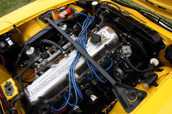

Also, maybe I've been starring at my British carbs for too long, but your carbs look different? The domes are smaller. Maybe measure the diameter of the throat. Should be 1 and 3/4in, they still might be that size but I have a feeling they may be off of something else.
Here's a pic of the Japanese carbs on my 240z and they look taller as well
As a side note, a way to identify the different carbs is the number of screws holding the dome's on (there are different kits for the different years, don't quote me but it looks like a kit from the later model carbs can be used on the earlier models, but not the other way around. The later kit looks like it contains a few extra washers and gaskets etc) . I think 3 screw is from 70-71 and 4 screws are from 72 and 73 (check this, i always get them mixed up). Yours look to be 3 screw. But of course, this info is for the Datsun 240z carbs.
hey i think you may be right
the say S.U on the side? i was told there hitachis?
is this a good or a bad thing?
im pretty sure birmingham england is not where japan is lol

ive been told that they are possibly SU HIF6 or HIF8 carbs ??
is this good or bad?
Quote:
Those look like genuine SU HIF6 or HIF8 carbs. HIF stands for "Horizontal Integrated Float".. HIF6's came on Volvo's and Jag's. HIF8's (2" bore) came on Jags.
