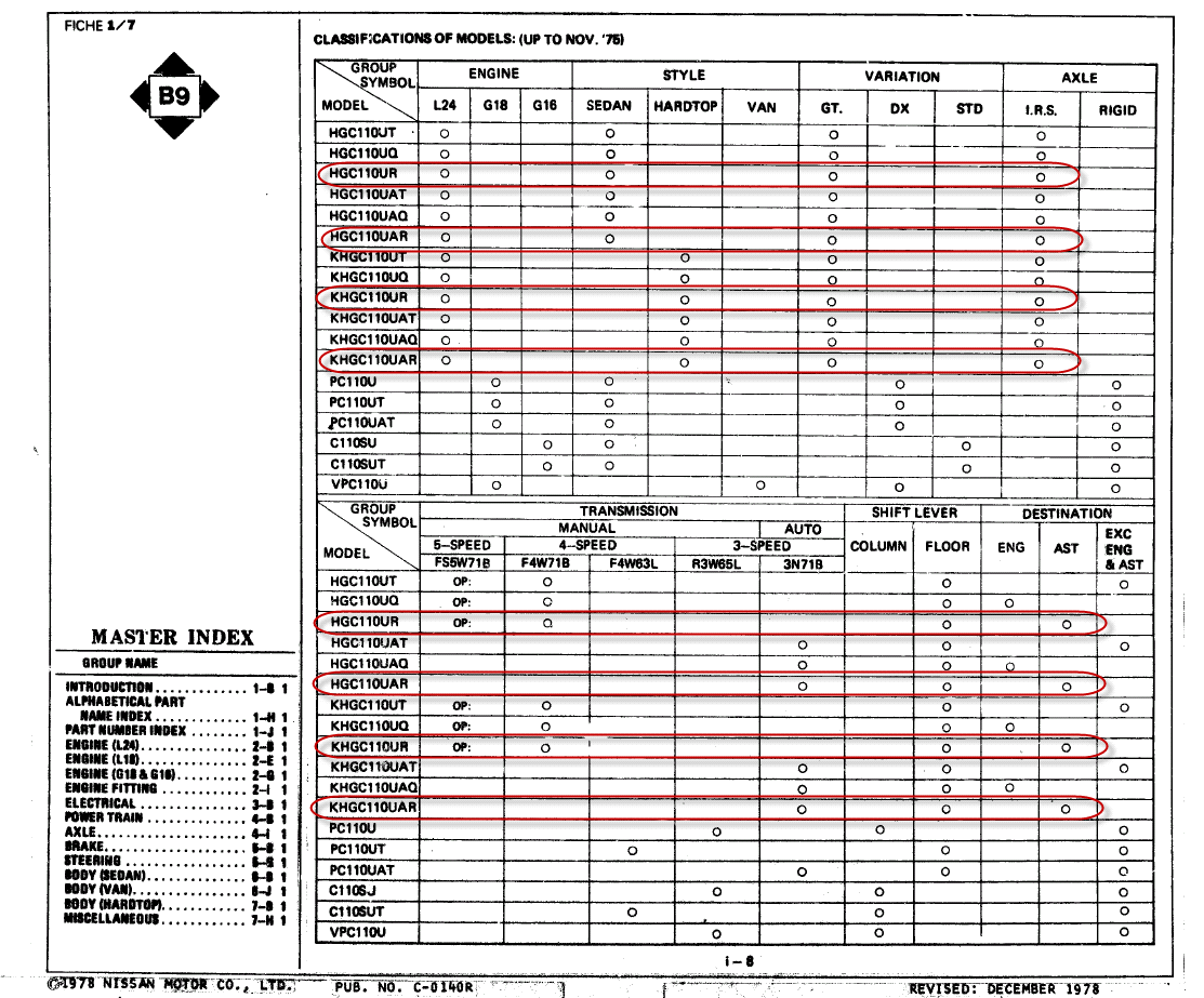

NZeder Posted March 2, 2010 Share Posted March 2, 2010 This might help - I have circled all Australian models - the first part of the screen is the body style, trim level, axles and engine config. With the second part of the screen showing the transmission and market they were destined for ie AST = Australian Market Quote Link to comment Share on other sites More sharing options...

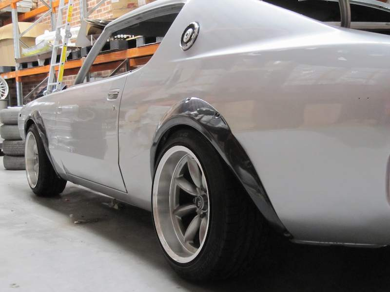

BenZed Posted March 4, 2010 Author Share Posted March 4, 2010 Trial-fitted the flares and wheels today. I'm going to run 17x8.5 +4 at the front and 17x9.5 -19 at the rear. The C110 flares don't give you as much room at the front as you get on a Zed, so the 17x9 -13 wasn't suitable. Once it is lowered this combo should sit just nicely inside the flares without too much tyre stretch. Quote Link to comment Share on other sites More sharing options...

kalium Posted March 26, 2010 Share Posted March 26, 2010 Trial-fitted the flares and wheels today. I'm going to run 17x8.5 +4 at the front and 17x9.5 -19 at the rear. The C110 flares don't give you as much room at the front as you get on a Zed, so the 17x9 -13 wasn't suitable. Once it is lowered this combo should sit just nicely inside the flares without too much tyre stretch. Is it just me or does that first photo make it look a lot like a 180 SSS ?! Quote Link to comment Share on other sites More sharing options...
BenZed Posted March 27, 2010 Author Share Posted March 27, 2010 You and dazzed apparently. The GT-R grille is pretty similar to the 180B SSS, but the rest of the car is a lot more angular Quote Link to comment Share on other sites More sharing options...

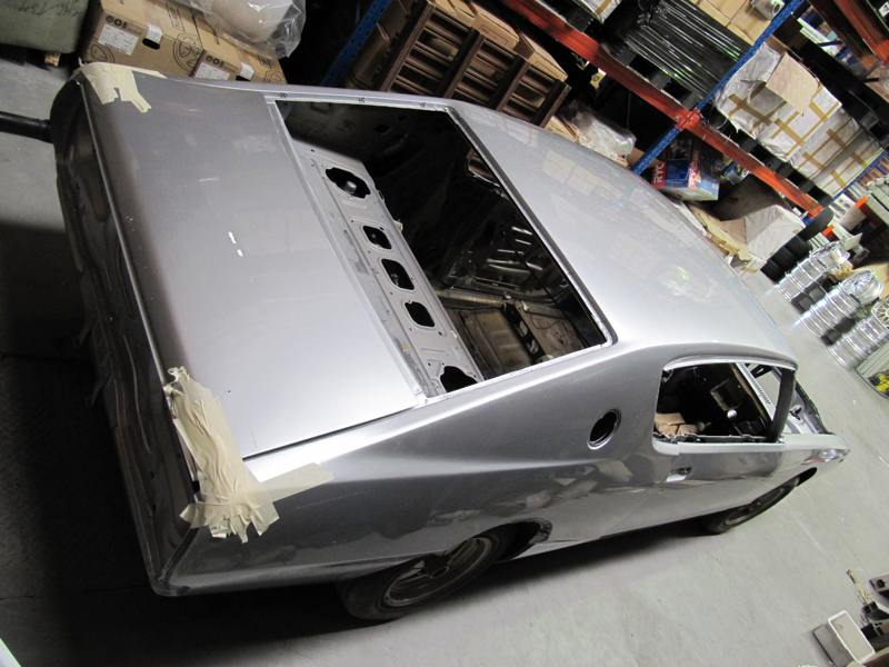

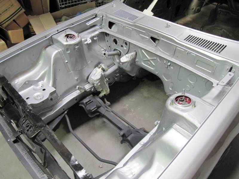

BenZed Posted October 28, 2010 Author Share Posted October 28, 2010 Just got the shell back from the paint shop. Not exactly a show-quality job as I only paid $3K, but I got the engine bay, sills etc done so it looks pretty good. I chose a silver colour off a V35 Skyline they had sitting in the paint shop, has very fine mica. Don't know the name but the code is KYO. The flares and rear spoiler are still off the car as they're getting painted gunmetal grey. It's nice to have it all shiny, keen to put it back together now. Quote Link to comment Share on other sites More sharing options...

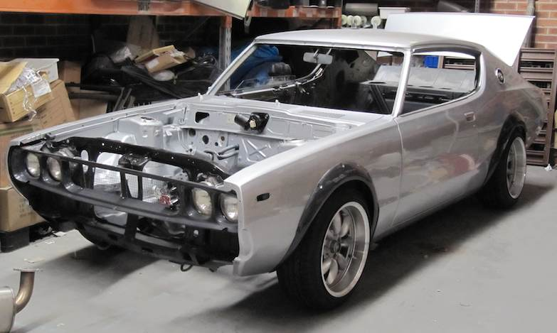

BenZed Posted February 7, 2011 Author Share Posted February 7, 2011 Finally got the flares back and screwed back on, so I put some tyres on the Rota wheels and bolted them on too. As it turned out I needed 20mm spacers at the back to get the wheel sitting where I wanted it. This makes the rears 17x9.5 -39 offset The tyres are 215/45 front and 235/45 rear. There is about 2mm of clearance to the flares at some points, but they don't hit so that's all that matters. Quote Link to comment Share on other sites More sharing options...

Ben Posted February 7, 2011 Share Posted February 7, 2011 Nice work - not many C110's around these days, and this one looked to be in pretty good shape when you started. It looks fantastic now! What drivetrain are you planning on using? L31? Quote Link to comment Share on other sites More sharing options...
BenZed Posted February 7, 2011 Author Share Posted February 7, 2011 Still not sure about that. I'm looking around in Japan for something interesting. Quote Link to comment Share on other sites More sharing options...
