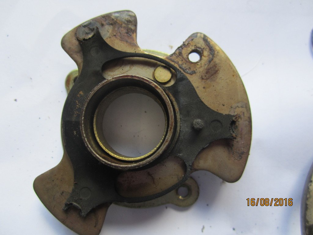

Advance maybe one of your problems.
Have a look at the advance plate under the points.
The carrier that holds the ball bearings is usually gone and hence no advance.
There should be three ball bearings at the end of the plastic arms.

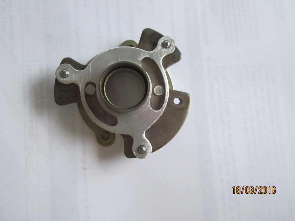

I remade mine in aluminium to fix the advance.

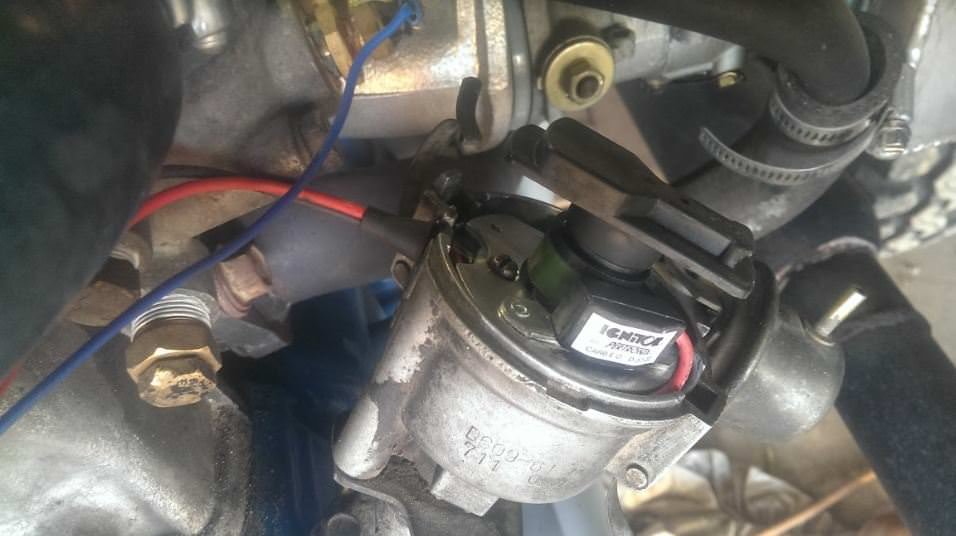

Thanks heaps for the help guys
Ordered a pertronix ignitor kit #1761 and matching 3ohm coil, went with the 60,000v option thinking bigger's better (guess ill find out if its not haha)
I disassembled the dizzy fully, inspected and cleaned all the old dried grease out of the advance weights and re-lubed it all before installing the pertronix unit, also locked out the vacuum advance mechanism as it was recommended not to be used with the webers and the motor never sees a "cruise" situation anyway
Tigged up a fancy new aluminium bracket for the coil too
And now the best part! the motor started well, i set the timing and the advance weights come out much quicker now thanks to the fresh lube, the timing light actually flashes regularly at idle and through the rev range which it didn't before indicating that its firing every time now. No more cough and splutter when the throttle is opened either and far more responsive
Tested it out in the um... "extended driveway" and it drives so much nicer now, can take off and grab second without it spluttering straight after the gear-change even gets instant wheelspin in 2nd when you open it up
