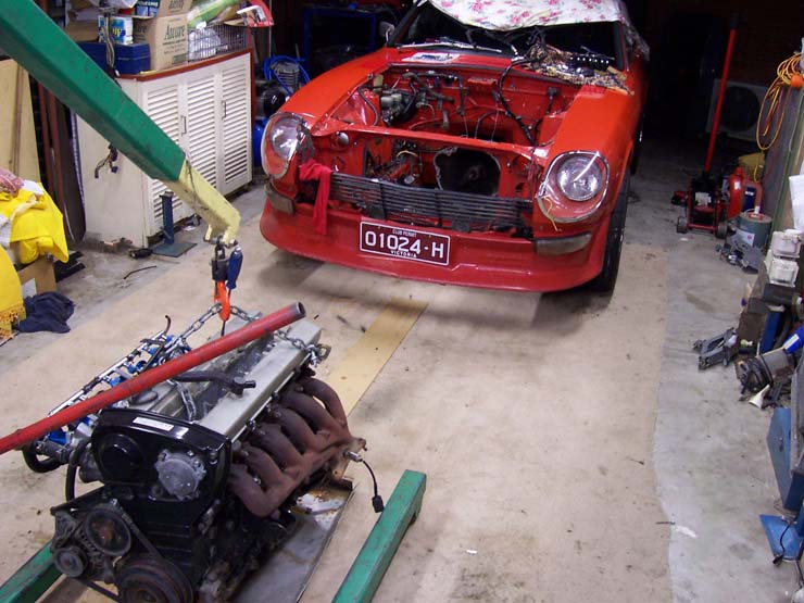

Well, after all the fun I had putting it all together, I've started to do the opposite! Engine has been removed and on ebay and gearbox is next. If anyone is after a RB gearbox (non turbo) I have one available (pending a response from previous inquiry). If I wasn't in such a hurry for cash I would've waited but I can't this time. I've PM'ed but still no answer... Received L28ET distributor last week so I may start a thread if anyone wants EFI with distributor-less ignition, I can show a how to..

Well I thought the original matching numbers engine is lying under my work bench in a sorry state with the head off and covered in 1" of dirt. With the RB in the engine bay needing another 2-3000 dollars spent to make it come close to the L28 I had, I thought I would rather spend the cash on the original L24 and tweak it a bit and have it all mostly original than the RB in the zed with the power but the L24 still looking sad. If I had the funds, I would've kept both but beggars can't be choosers..I can always do it again, I know how but one thing I would do different, is buy a DET engine and install. Find an NA gearbox which I think will take the power of a standard 25DET and leave the engine standard. 160 odd kw in a zed is plenty for the track. In the HybridZ site, a guy has done a excellent write up on how to make your own sump out of ally. He makes it look too easy! and tempting!

Mike, I drove it around for a while and liked it alot. The smoothness of the engine couldn't be compared to the L series. Theres a few youtube vids of it around Calder and Sandown. Those 120Kw's were fun but it really needs a good set of cams to really see the potential. That and adj cam gears would be perfect. The ITB's will be going back onto the L24 as is the Wolf V500 but with a L28ET distributor and coilpack and 3 ch. ignitor. One thing I thought of with the L series is what would it be like with a RB CAS mounted on the front driven by the cam? Instead of trying to find those turbo dizzy's which are hard enough, R32,33 CAS' are more plentiful.
