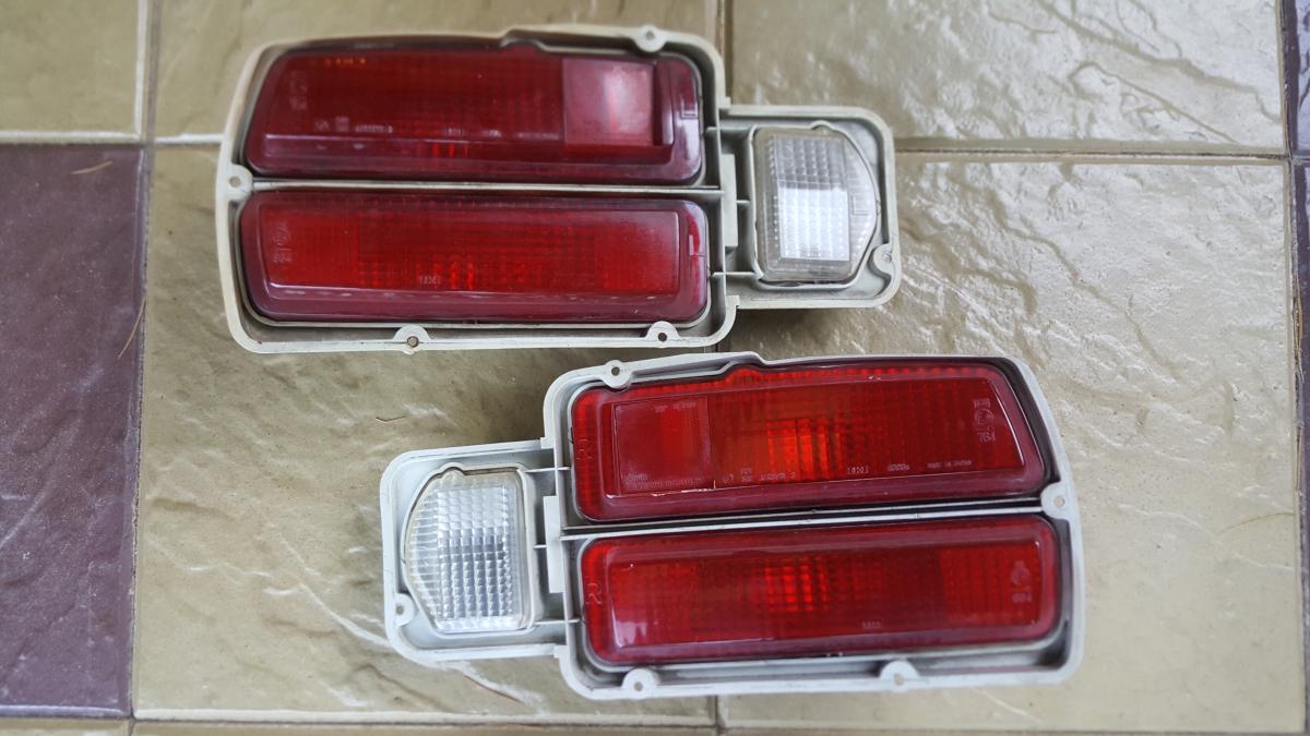

Still trying to find some 260Z tail lights. As I need to change the indicators to orange. Dknt know why North America like red indicators; I believe there have been studies that show orange indicators result in less accidents. Anyone looking to sell me a set, please PM me.

All North American S30Z's have red turn signals and in fact even their modern cars like new Mustang's etc.. still have red turn signals. Should be able to find some 260z ones here relatively easily and the amber improves the rear end look too!
This set of 260z tail lights are on Gumtree atm : https://www.gumtree.com.au/s-ad/east-cannington/auto-body-parts/datsun-260z-tail-light-set-complete/1159570481

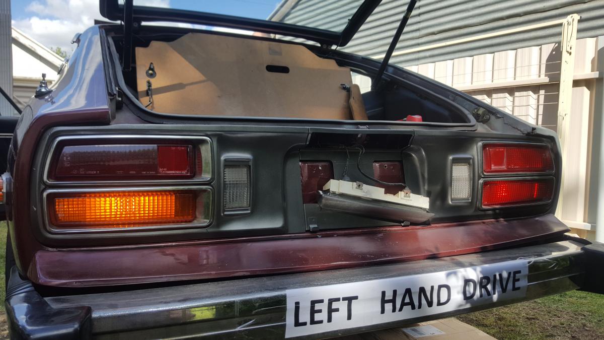

After being screwed around by another forum member who took my money and never posted the advertised tail lights I finally found a genuine seller.
A big thanks to a forum member, Simon W, for supplying me with Australian tail lights. I removed the USDM tail lights and installed the ADM lights this afternoon. Looks so much better.
The extra long bolt on the middle bottom of the tail lights are a nightmare to remove. Even my deep 8mm socket couldnt reach the nut. Got there in the end.

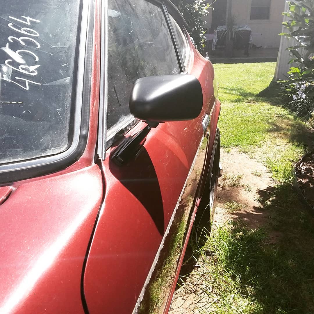

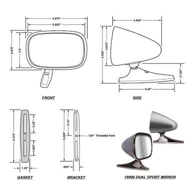

Also bought some new door/side mirrors as it only came with a left mirror and I couldnt find the same for the right. Bought a pair of CIPA 19100 mirrors from the US and will install once I can figure out how to remove the door panel.

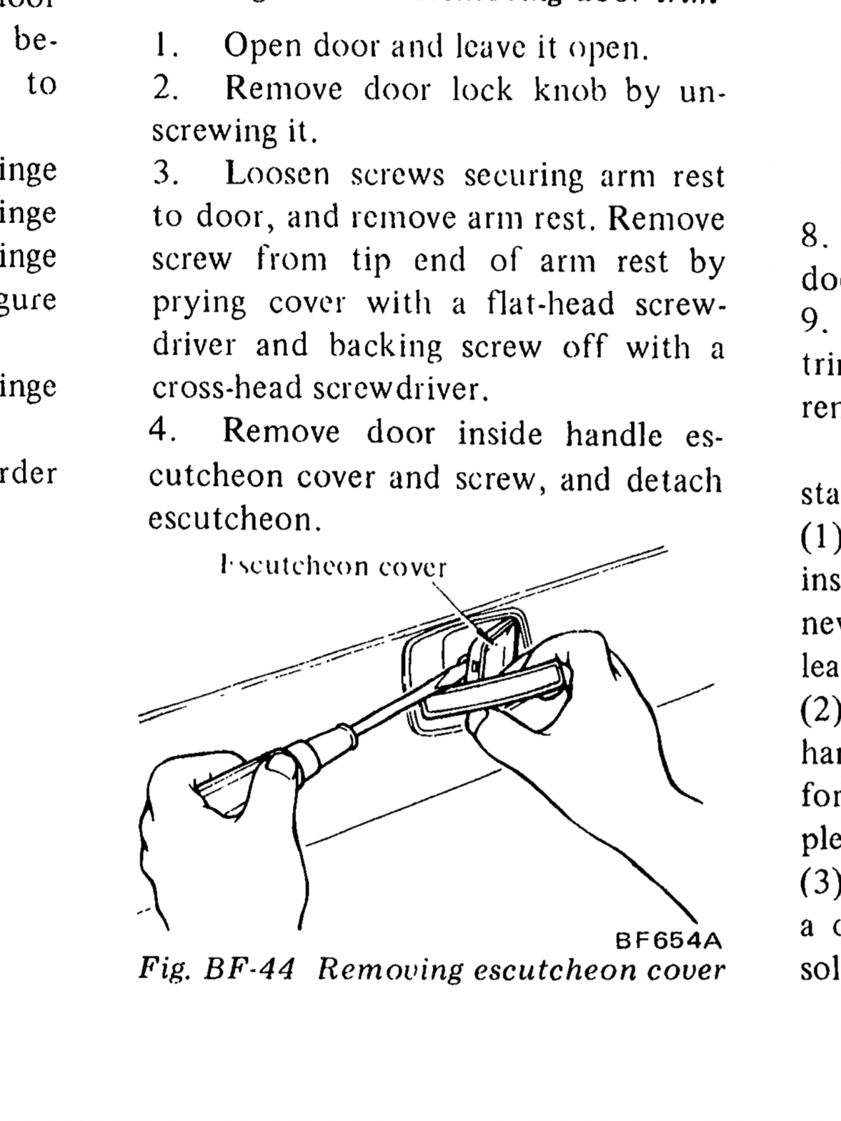

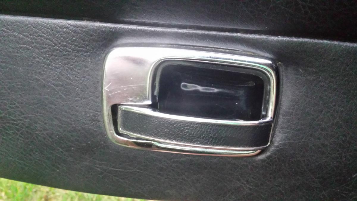

I cannot figure out how to remove the door handle metal cover. Mine has a black plastic cover which hides the screw. Any suggestions how to remove the plactic cover without snapping it?

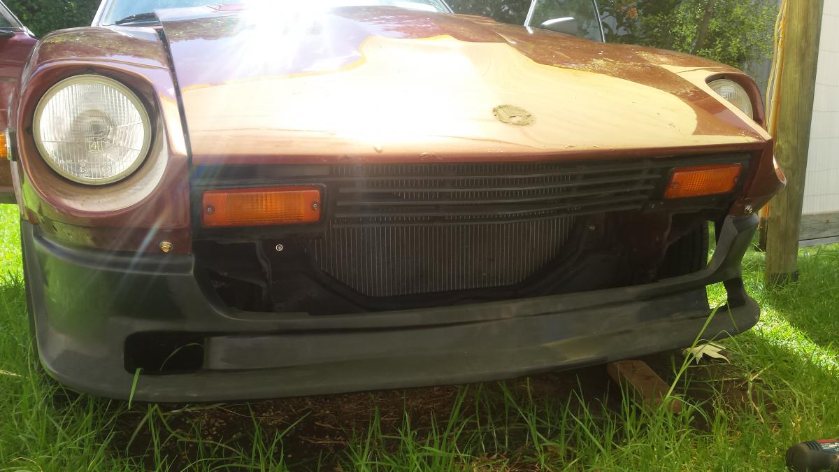

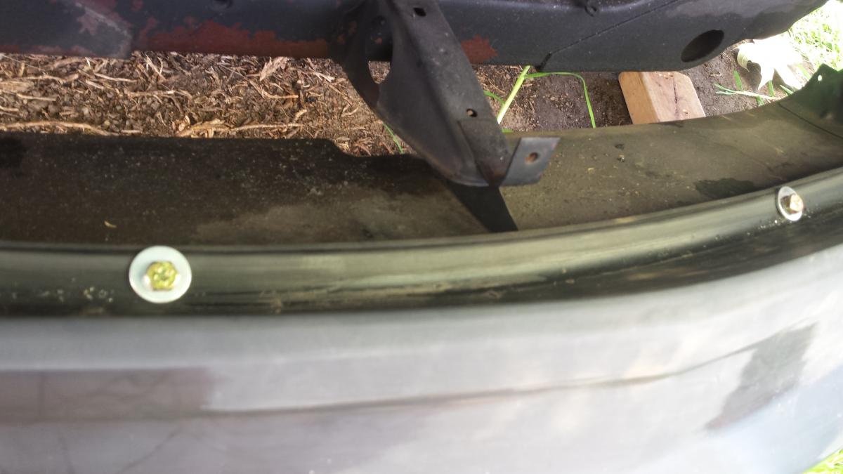

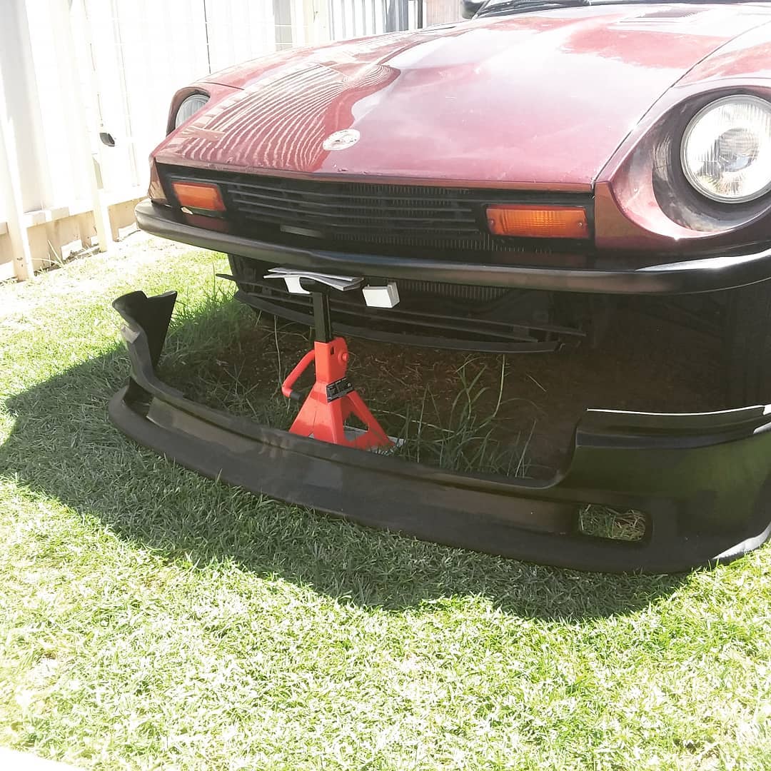

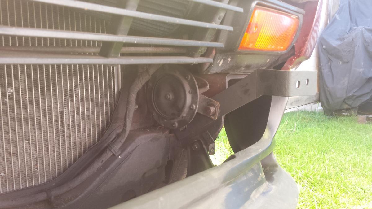

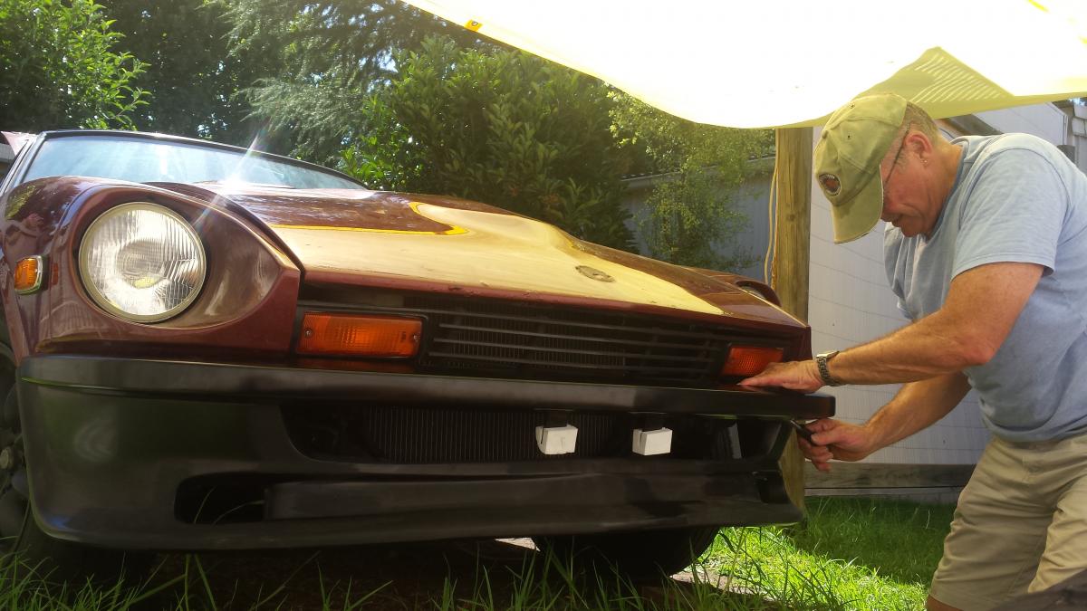

Current progress:
  • Switched the side marker lights to side indicator lights
  • Installed side mirrors (CIPA 19100 from Amazon US)
  • Installed front air dam (Xenon 3125 from eBay/Jegs)

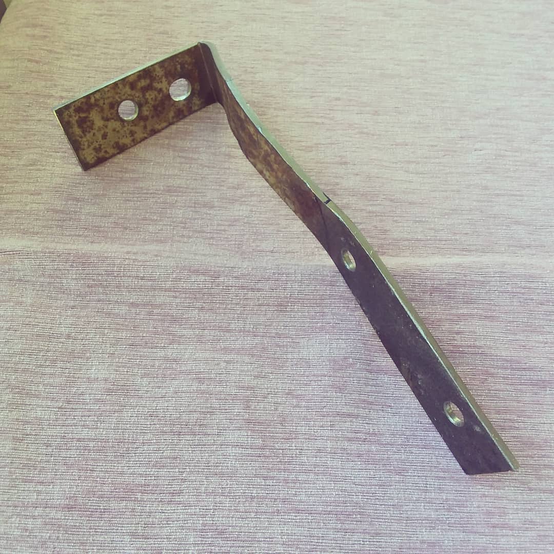

  • Made brackets for the front bumper to attach to
  • Installed front bumper (from Muscle Car Parts Australia)
When installing the air dam, there didn't seem to be enough support from the headlight cones where the instructions said to install it. I noticed there was a metal piece in front and below the radiator, if you remove the bolt from the middle bracket and loosen the side bolts, you can rotate it towards the air dam. I then put some bolts (don't worry these aren't the final bolts I will be using, got some nice dress-bolts and washers on order) through the air dam and into the metal piece and it is holding nice and tight now.
