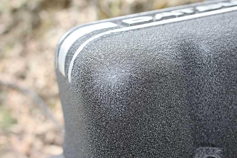

HomeBuiltByJeff Posted May 11, 2018 Author Share Posted May 11, 2018 This week I continued the body work on my Z and painted the valve cover. RAP260 1 Quote Link to comment Share on other sites More sharing options...
1600dave Posted May 11, 2018 Share Posted May 11, 2018 (edited) Tip for next time - BBQ your rocker cover ! Seriously though, the paint can recommends a temp for baking, my old faithful 6 burner BBQ with roasting hood down maintained the perfect temp with just one burner at one end on full. Set up a few bricks or similar at the opposite end of the BBQ, throw 3 coats of paint on, sit the cover on the bricks in the BBQ and bake for the recommended time and you'll get beautiful tight wrinkles. Personal preference and all that, but I prefer the baked finish to air drying alone. Also works in the kitchen oven, only did that once while the wife was away for the weekend, haven't been game to try it again. Especially after the great "valve guide installation" oven incident of 2010...... Edited May 11, 2018 by 1600dave RAP260, chris240 and HomeBuiltByJeff 3 Quote Link to comment Share on other sites More sharing options...

HomeBuiltByJeff Posted May 11, 2018 Author Share Posted May 11, 2018 I did think about heating it up, but the can said that if you heat it you get bigger wrinkles, and I wanted them tighter. I may try something like that next time, although not in the oven. Mrs Jeff would not be too happy about that Quote Link to comment Share on other sites More sharing options...

TOO60Z Posted May 11, 2018 Share Posted May 11, 2018 Use the power of the sun. You get a more of a “natural” wrinkle. HomeBuiltByJeff 1 Quote Link to comment Share on other sites More sharing options...
Administrators gav240z Posted May 12, 2018 Administrators Share Posted May 12, 2018 I may try something like that next time, although not in the oven. Mrs Jeff would not be too happy about that Think about the blooper reel potential! As I said on the YouTube comments I used a heat gun from about 30 cms out and it worked really well. Good consistent wrinkles is what you want. Although sadly sanding down the letters left a dullish grey over my red paint that wouldn't come off. So I have to mask it again and repaint a couple of coats to give it that nice deep redish look again. Only thing I'm not sure about is how durable the paint is and how long it will look good for. I would like to get a powder coating set up and second hand electric oven in future. I had my brake calipers powdercoated recently and that stuff seems very durable. HomeBuiltByJeff 1 Quote Link to comment Share on other sites More sharing options...
1600dave Posted May 12, 2018 Share Posted May 12, 2018 Is the “Great Valve Guide Installation” incident a story you can tell us about or taboo? I thought I'd get the old guides out easier by heating the head in the oven while the wife was out. Head wasn't as clean as I thought. Engine oil in an oven makes a bad smell in the kitchen. Bad smell hangs around a long time, long enough for wife to get home. Bad smell in the Kitchen makes wife unhappy, Unhappy wife makes Dave unhappy. I did think about heating it up, but the can said that if you heat it you get bigger wrinkles, and I wanted them tighter. My experience is the opposite. First one I did I air dried and wasn;t happy with the appearance so tried again by baking it and wrinkles were much tighter. HomeBuiltByJeff and gav240z 2 Quote Link to comment Share on other sites More sharing options...

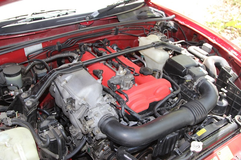

1600dave Posted May 12, 2018 Share Posted May 12, 2018 (edited) Only thing I'm not sure about is how durable the paint is and how long it will look good for. Did the cover on my race engine in 2010, its still looking as good as the day I did it (well, except for a liberal coating of oil since Bathurst last November...) Also did the rocker cover on my MX5 in wrinkle red 2-3 years ago and its still looking great. Lol, I could imagine a BBQ at Daves place... sirloins, 4 quater chops, salad, L28 rocker, sausages..... Don't forget Possum. We had to forego BBQ's for a few months last spring because these guys (there's a mother and baby) took up residence in the BBQ and the wife / daughter didn't want to evict them from their home Edited May 12, 2018 by 1600dave HomeBuiltByJeff 1 Quote Link to comment Share on other sites More sharing options...
