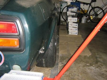

mick74 Posted March 11, 2008 Share Posted March 11, 2008 Scrumpy Both sized wheels will work with that tyre size. I have run 16x7 11mm offset with 225/50 and had clearance of 10mm to the spring perch. Ideally the closet to a zero offset (for 16x7) you have, the greater the clearance, and the better looking stance. I have recently acquired (from 18racing) a set of Rota RB 16x7 4mm offset for the front and 16x8 4mm offset for the back (painful experience especially after sales service with damaged wheel) tyre sizes 225/50 and 245/45. The stance looks great, I have a photo of the rear. I hope this helps. Mick Quote Link to comment Share on other sites More sharing options...

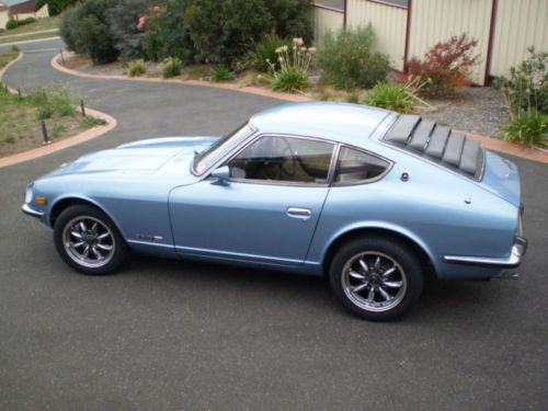

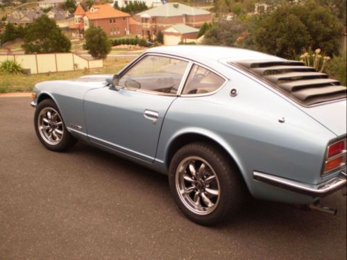

scrumpy Posted May 7, 2008 Author Share Posted May 7, 2008 Well here they are. Bought a set of 16 x 7 ROTA RB Wheels with a 4mm offset Bought them from 18racing in the US via seller wheelbay on ebay. $1000 delivered Fitted them with Goodyear F1 tyres 205/55/16. $850 fitted Here's some photos. No rubbing. You would not be able to go any larger without flares; or having the tyres protrude beyond the body. Quote Link to comment Share on other sites More sharing options...
Toecutter Posted May 7, 2008 Share Posted May 7, 2008 Looks very nice. hmmm...some lowered king Springs would be the icing on the cake. Sulio Quote Link to comment Share on other sites More sharing options...

modular9 Posted May 8, 2008 Share Posted May 8, 2008 cor they look nice. Definite purchase for me. What is the steering like now as compared to before ? Quote Link to comment Share on other sites More sharing options...

Jeffrey Posted May 9, 2008 Share Posted May 9, 2008 Well here they are. Bought a set of 16 x 7 ROTA RB Wheels with a 4mm offset Bought them from 18racing in the US via seller wheelbay on ebay. $1000 delivered Fitted them with Goodyear F1 tyres 205/55/16. $850 fitted Here's some photos. No rubbing. You would not be able to go any larger without flares; or having the tyres protrude beyond the body. Are those RB's or RB-R's? I thought the RB-R's had a more curved spoke like these. Quote Link to comment Share on other sites More sharing options...
