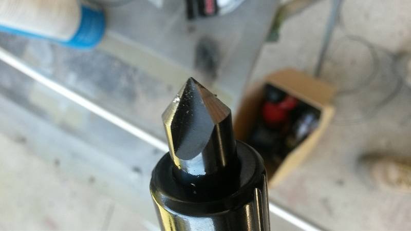

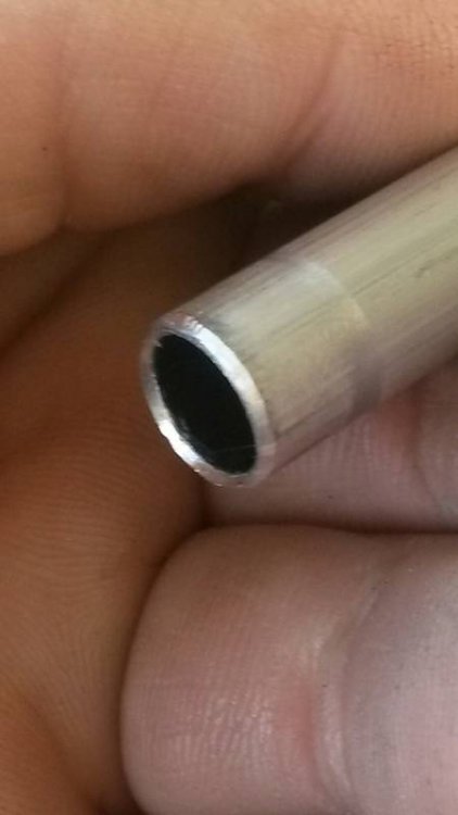

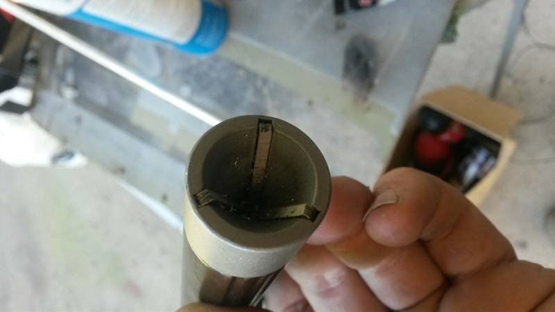

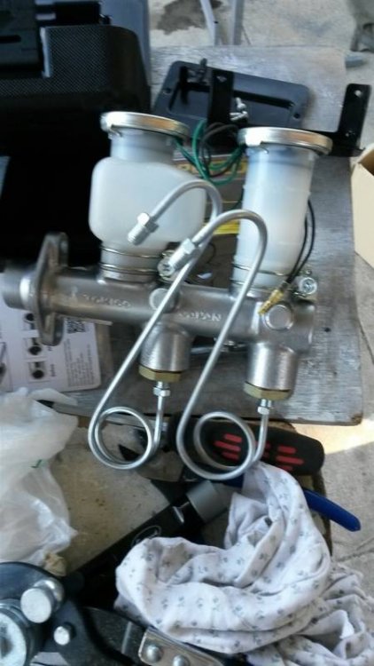

scott Posted August 27, 2015 Share Posted August 27, 2015 i just copied factory lines. Also buy a reamer. Just run the inside and outside with it As u can see Quote Link to comment Share on other sites More sharing options...

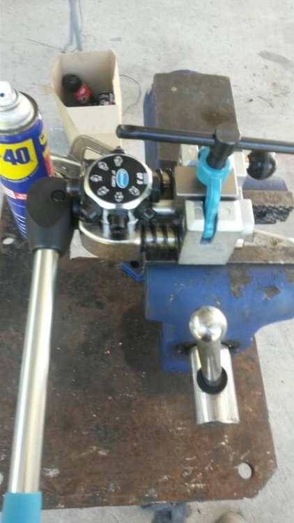

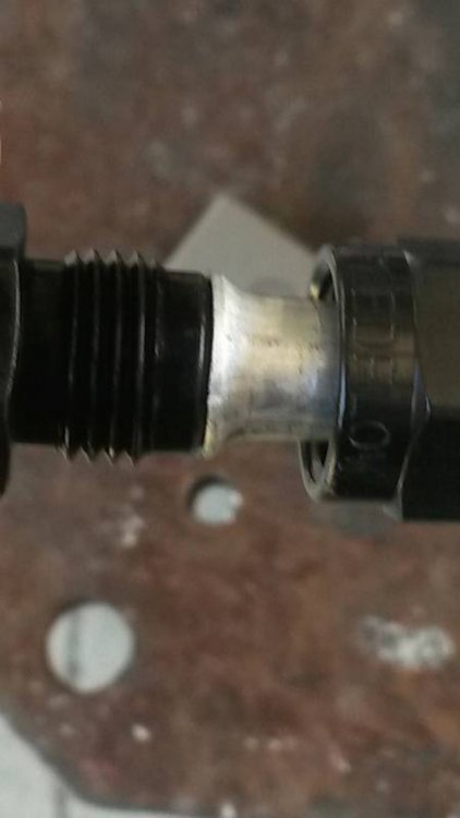

scott Posted August 27, 2015 Share Posted August 27, 2015 I also bought a better flaring tool as i wanted to do everything. I have used the hand ones and vowed never to do it again but it all adds up fast. Brake lines use a 45' double flare. 37' refers to AN fittings like this AN only use a single flare as well. Unsure on how big your budget is but AN fittings add up fast. I just went this path and my account is still hurting. This is only half of what i bought You should also buy a flare spanner if u haven't got one either. As for length i am unsure what a zed would need but i used about 7 odd M's on my K Quote Link to comment Share on other sites More sharing options...
