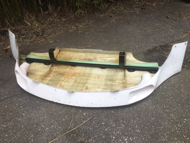

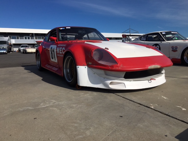

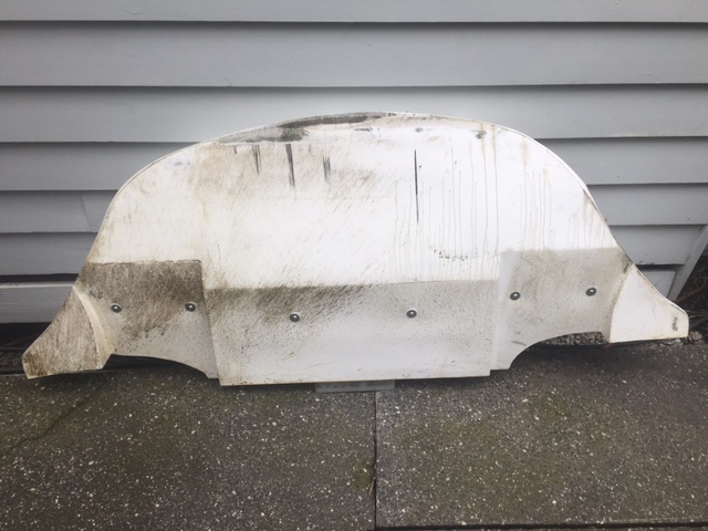

Hey Tom, can you post some pics on how your front lip is mounted to the lower half of your g-nose please?
The spoiler had screws around the front and sat on the sway bad at the rear, but was moving too much and hitting the track
So Trackart fabricated a bracket that hangs on the front radiator mount - very solid, but also extra 7kgs
see pics

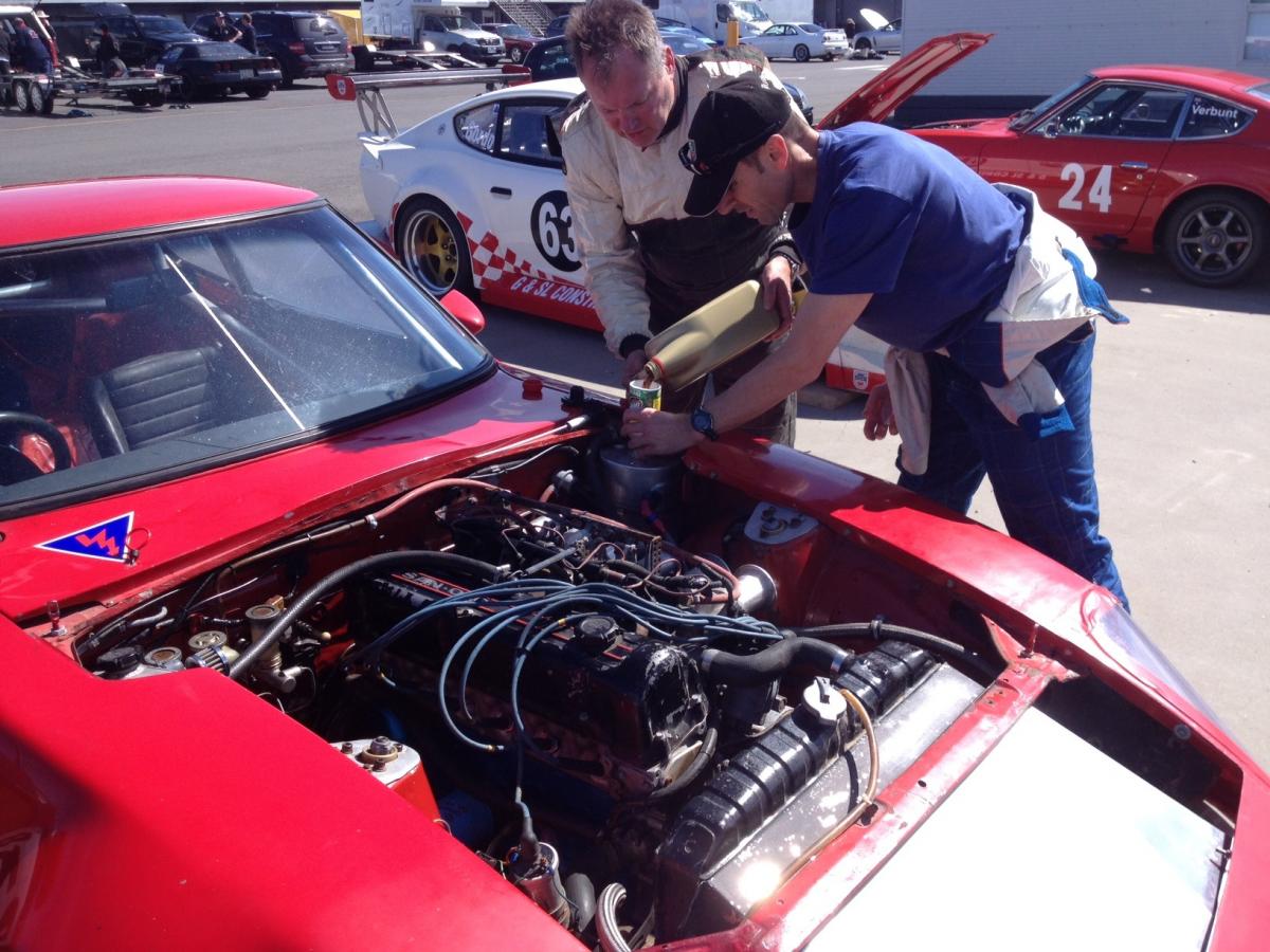

Please explain what's going on hear?
Adding oil, hmm wonder where that went... loose oil filter spat only a litre or so out onto right rear tyre and had big spin going through Stonier at 180kph

Yowsers, would've been a brown pants moment Tom! Lol. Good to hear no damage was done.
I've seen people put a large hose clamp on the filter and lock wire it back to the engine mount. The K&N oil filters have provision for lock wiring built on the end of the filters. It's going to the top of my to do list!
